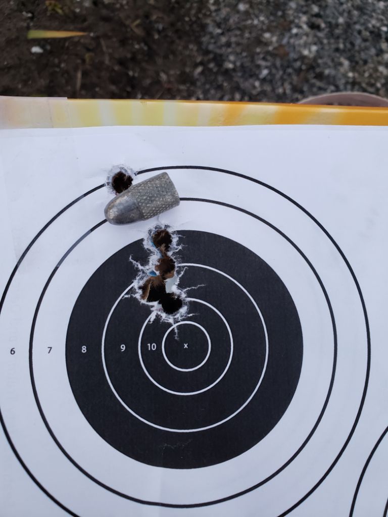

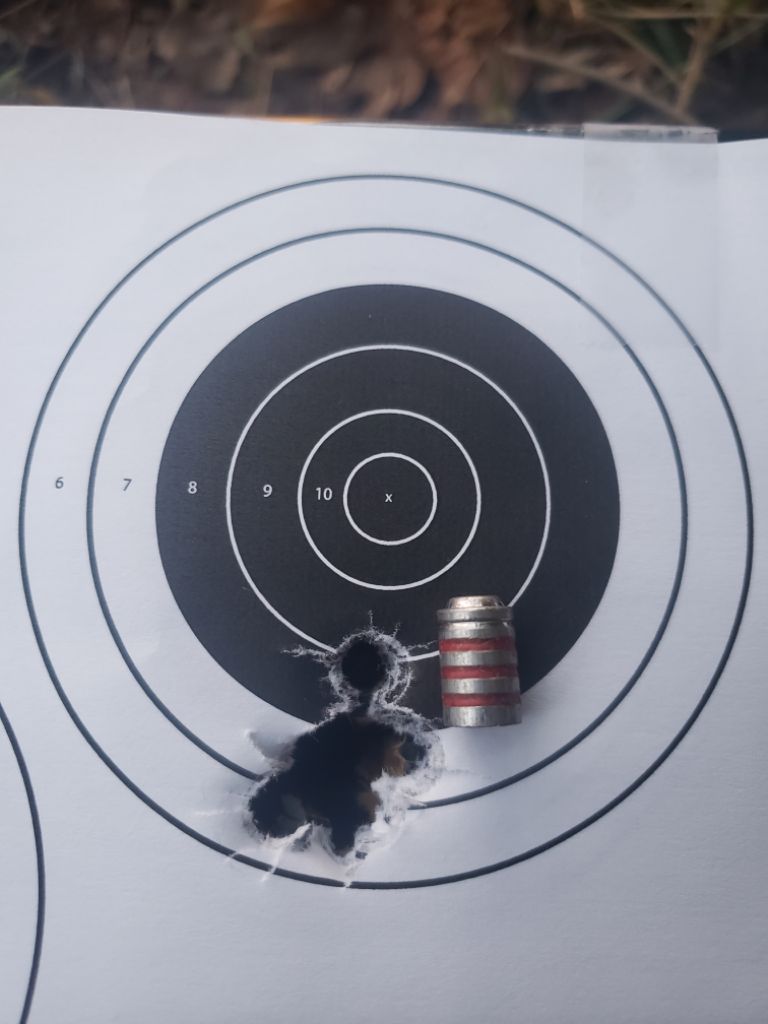

I have a benjamin bulldog. 357
Tuned for 6 shots near the 245ft lbs range.I have no doubts withing 60 yards it will destroy a Whitetail deer.
I also buy cheaper lead pistol reloads and I get 1" 5 shot groups at 50 yards at 10 cents a round.
Pure whitetail hunter Id go for a Texan .457.Bigger hole....faster blood loss.
.357 pistol reloads are the cheapest big bore ammo.5 shot groups untethered at 50 yards.
148 grain gt bullets wadcutter(100 for $10 at GTBullets)
158 grain Hornady .38 lead Round Nose(300 for $28 at academy)
158 grain Hornady Hollow Base Wad Cutter(250 for $23 at Academy)
