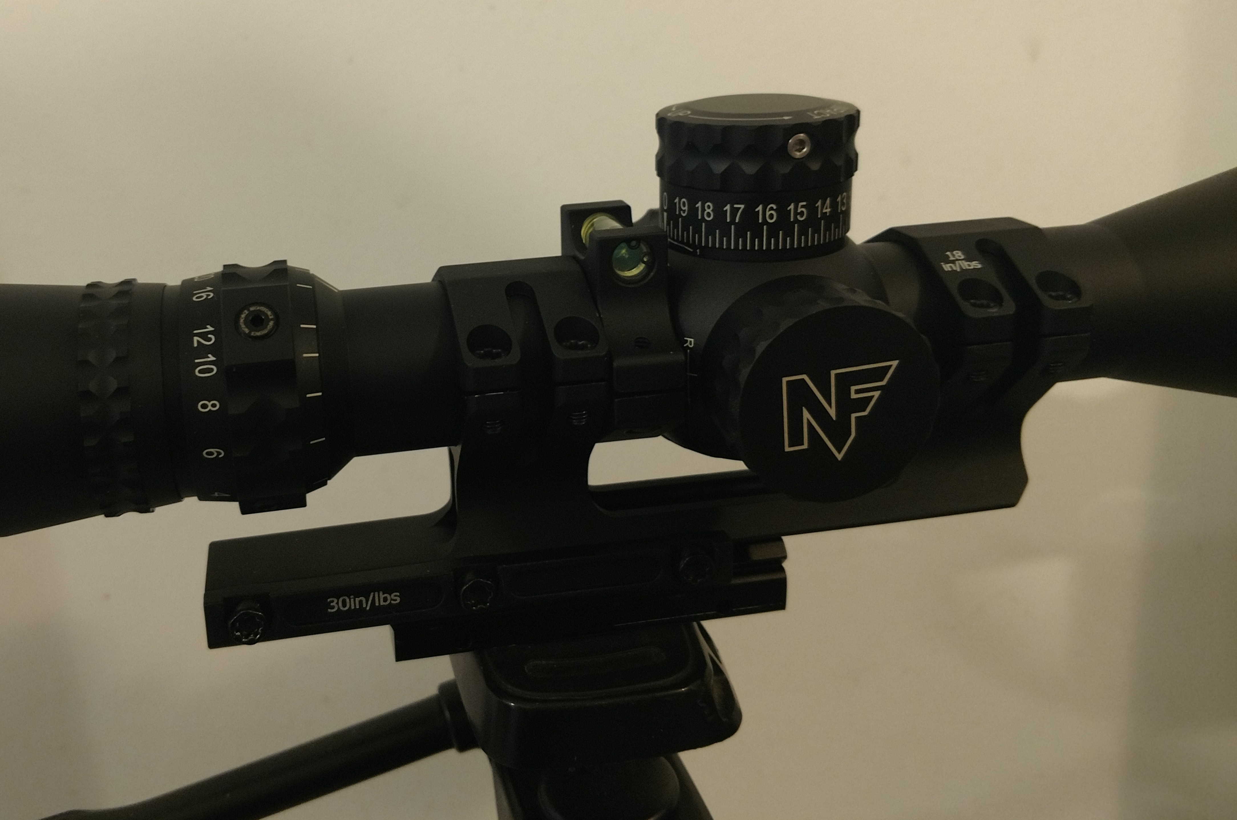

I set up the permanent mounted bubble level first and foremost, making certain it is true with the cross hairs and then dial to the bottom of the tracking elevation to double check the bubble to the verticle line. Only then do I move to the actual mounting set up and shooting it in (for proper cant with relation to the barrel). Using a plumb line, eyeball or the flashlight method, I don't even start with the scope mounted on a rifle sometimes.

Most scope mounting strategies that involve the use of levels or wedges are making a variety of assumptions about the perfectness of critical features of the gun, scope, and mounts. Granted, frequently these items are close enough that you’ll get a better result than by just eyeballing it, but it’s frustrating to see expensive “professional” jigs that will leave you with an improperly aligned scope if something isn’t perfect. For example, it’s not uncommon for the reticle to be rotated a couple of degrees relative to the turret caps, or for 3/8mm or 11mm rings to be offset slightly, or a variety of other issues.
What matters is that the reticle is aligned to the bore. The good news is it can be done with no special tools. All you need is a mirror.
But first let's establish that the requirements to eliminate cant error are:
1. Align the scope's reticle with the rifle's barrel.
2. Hold the reticle level when shooting.
Item 1 deals with scope cant…i.e. mounting the scope incorrectly.
Item 2 deals with gun cant…i.e. holding the gun incorrectly.
To correctly align the scope to the barrel, set up a mirror at a distance of, say, 5 yards and set your AO to 10 yards. Look through the scope at your reflection in the mirror. Twist the scope in the mounts until the vertical bar of the reticle simultaneously bisects both the muzzle and objective bell. Then lock it down. At this point you have eliminated scope cant (item 1). If it's hard to see your muzzle, add a little dot of White Out or take a dot from a hole punch and tape it to the muzzle with clear tape.
Now to eliminate rifle cant, install and use a level. View a known good plumb line (e.g. hanging string) through the scope and orient the rifle so it precisely aligns to it. Now affix your level so it shows level. From now on when you're shooting, hold the rifle so it shows level and you can be sure you've eliminated both potential sources of cant error.
By the way, don't buy a level that attaches to the scope rail. There is no guarantee it will show level. Instead, get one that attaches to the scope tube so you can rotate it and lock it down where it shows the proper level.

Level gun, attach barrel level, attach rings/scope, level, torque, done Personally I like levels on my gun/scope. I've gone from awful to mediocre.
FWIW I don't consider $30 expensive either, but neither would I spend $30 on a tool that is fundamentally incapable of guaranteeing the scope is installed correctly. And certainly not when the mirror hanging on the bathroom wall will guarantee it.
