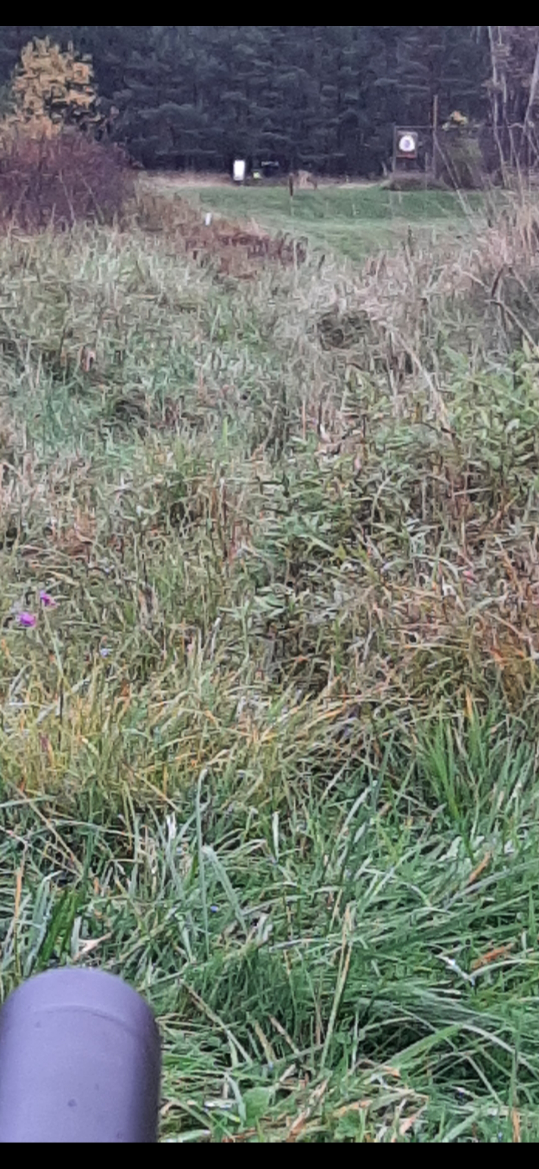

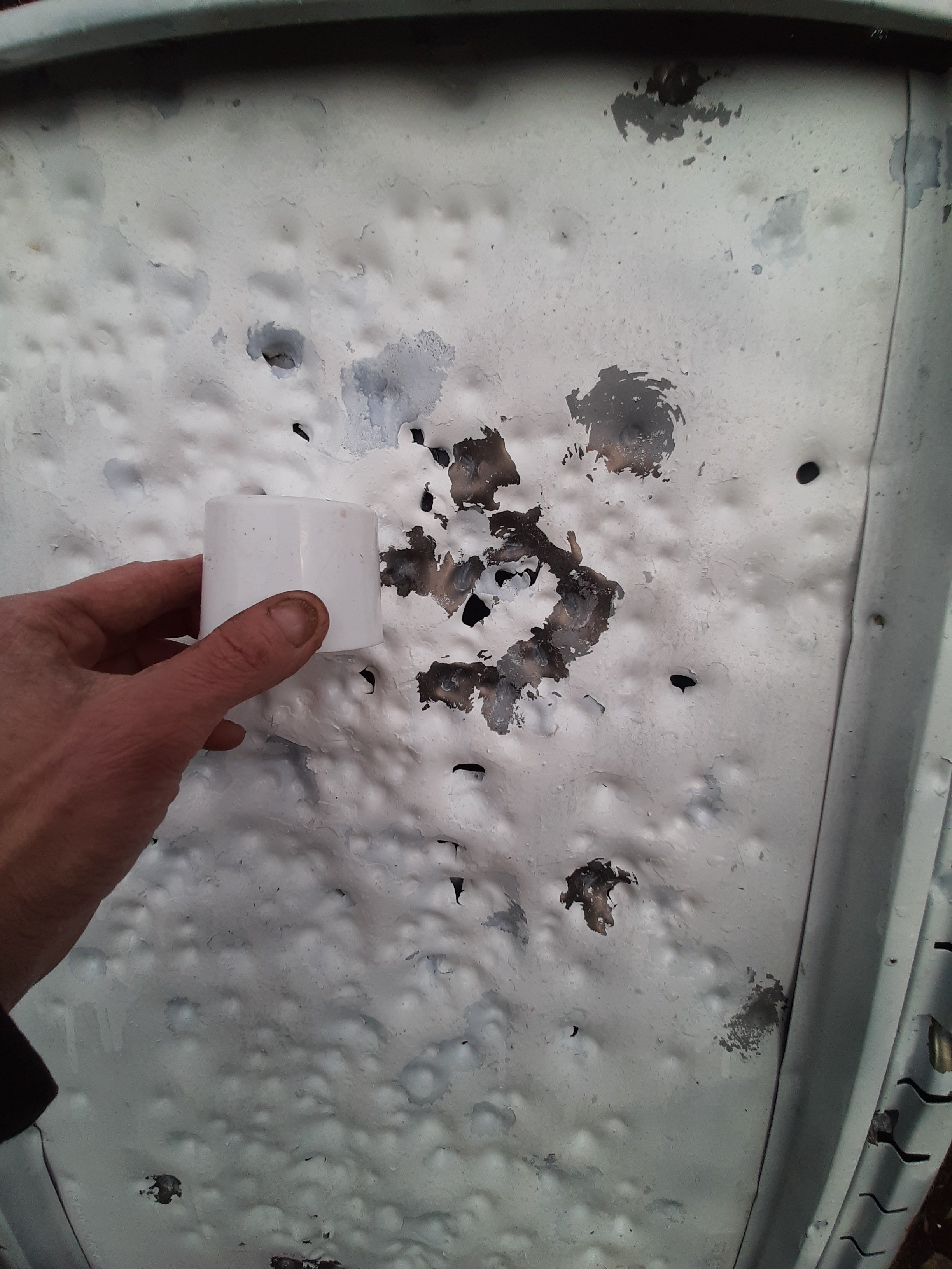

Here is my .30 Impact at 230 yards. About a 6" cowbell, hit twice in a row with JSB 44 grain. Holding way over the scopes limits. Have since jacked up the scope, but that makes it unusable at closer ranges. The rifle is capable, I simply don't want to mess with swapping barrels for a slug liner and lowering the scope back down for different target ranges. Never mind the less wind effect on slugs. I just want a dedicated slug Impact for the 230 yard tree line :)
