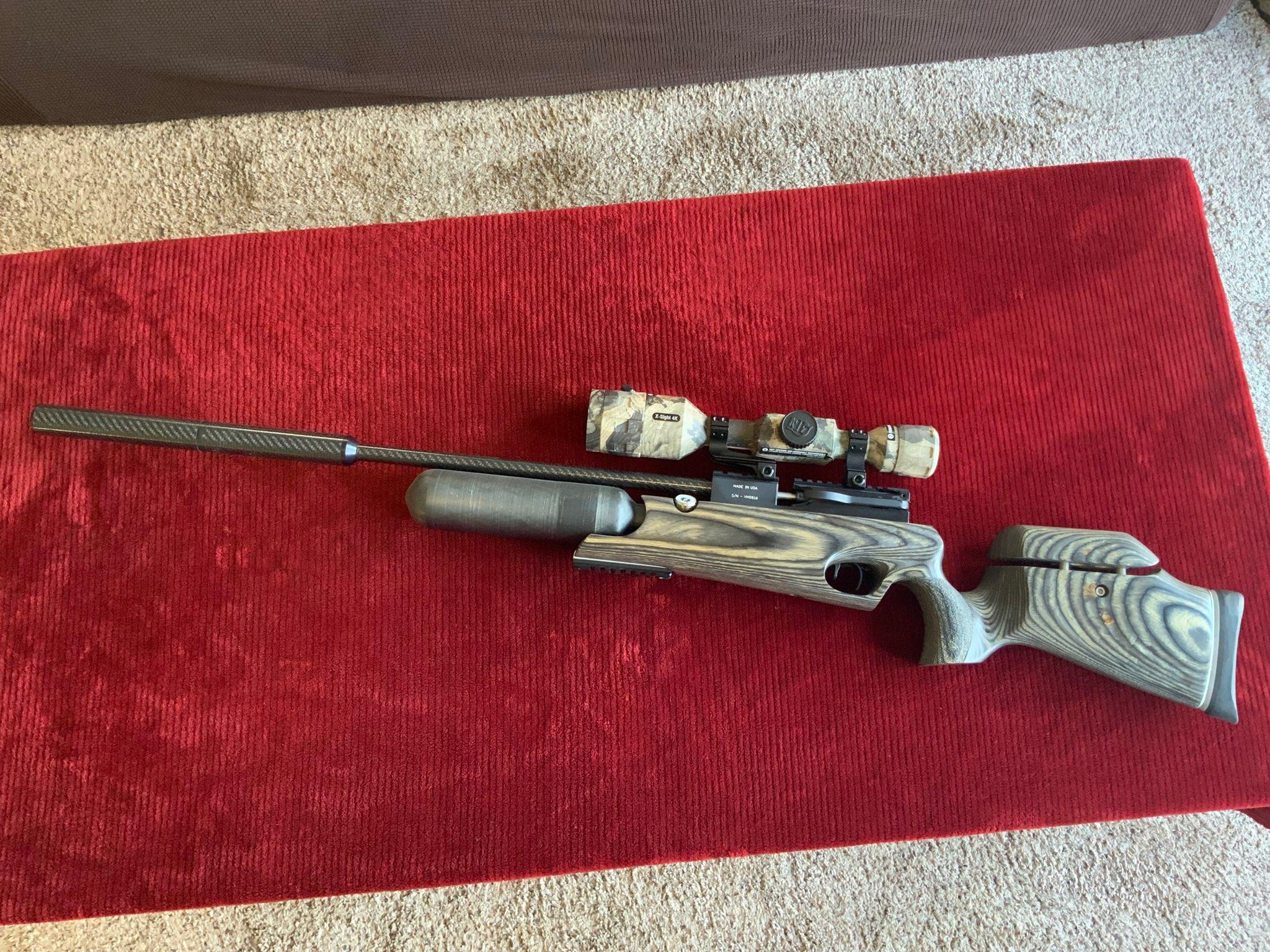

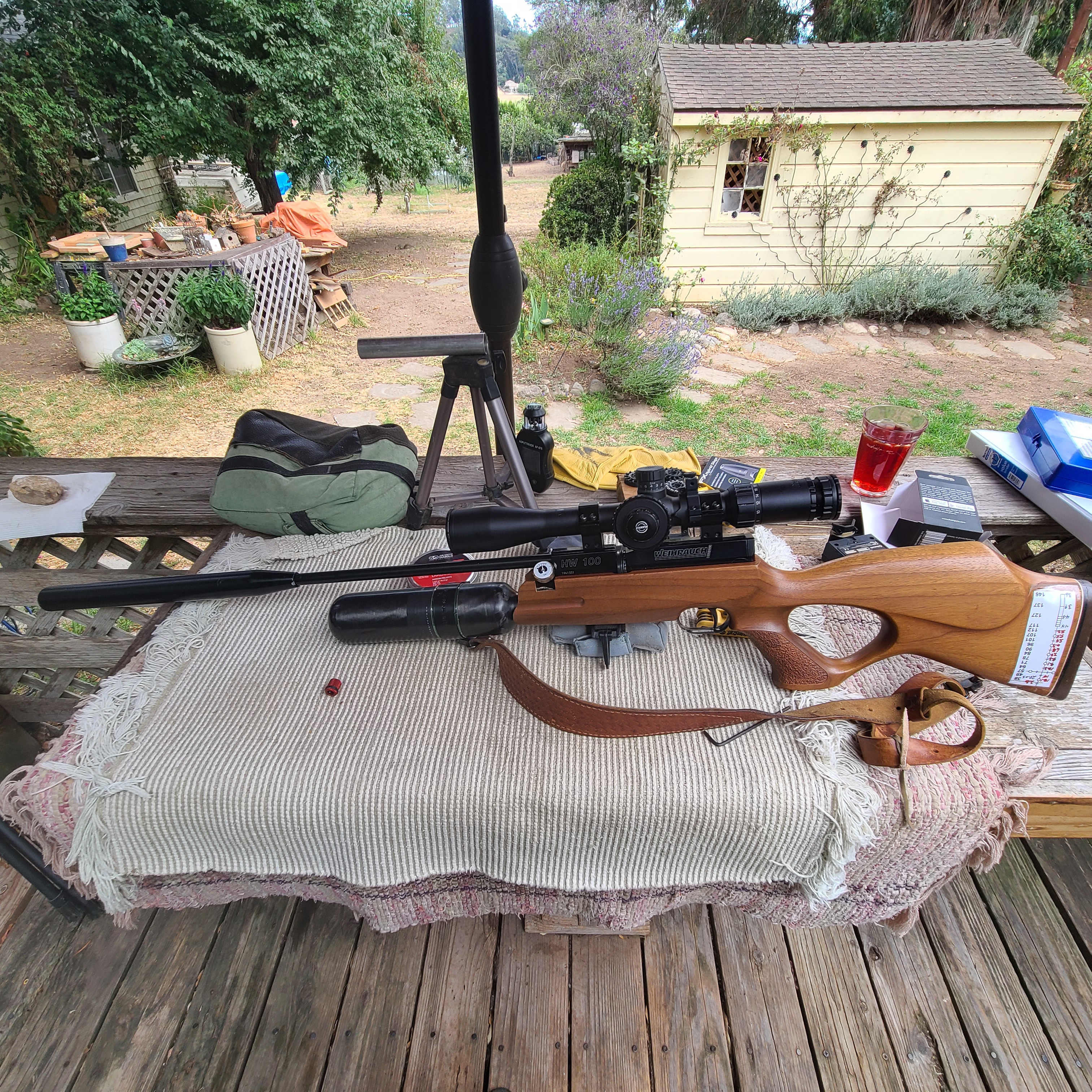

I just purchased a nice RAW TM1000 and need to quite it down some to make it more backyard friendly. I will be using it for field target so I don’t want anything that will effect accuracy. I really don’t want to have the barrel threaded and would rather have a slip on shroud. I know that Neil Clague does excellent work, but is there any others I should consider before going this route? Pic of the RAW is below.
i like slip on , i have a hmx rapid i pulled the droop moderator off and the slip on is from Best Fittings in UK , it fits my barrel like a glove and the moderator is dead straight ! no clipping im using a huggett with extention so its long , im a 25 cal and using a 25 cal. moderator with no problem . very quiet !!! also have the same one on my old bsa super 10 . same thing . they both have the same 2 grub screws . perfict fit , no clipping ! havent tryed donny fl slip ons . but i do have a few of his moderators on a few guns . about 2-3 weeks to get parts from uk best fittings. it goes air mail not one of those big floaters in a back logged harbor . have ordered from them a few times , no problems

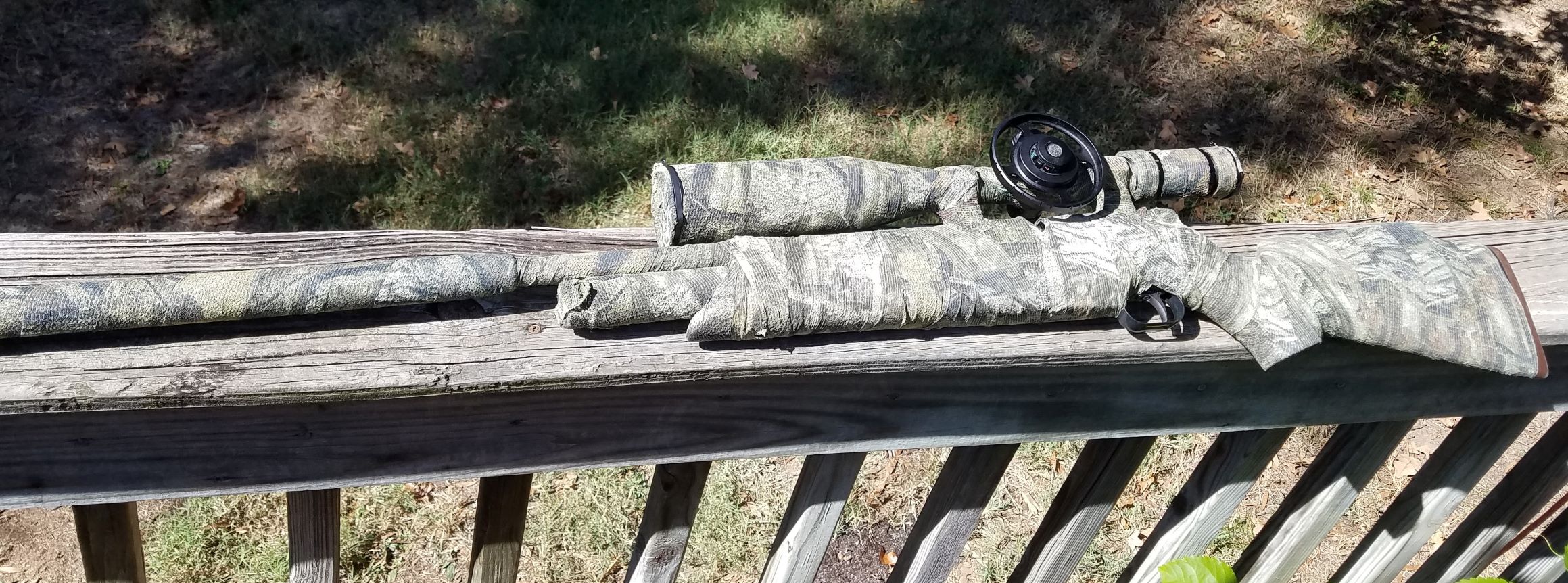

AZ put a fx smooth twist barrel on my HW100 and built a shroud for the setup. Remarkably effective in taming the noise.View attachment 273068His ability is unmatched to get it right. Gun is a tack driver.
HW100 sporter...Alan Zasadny squirrel killer!
