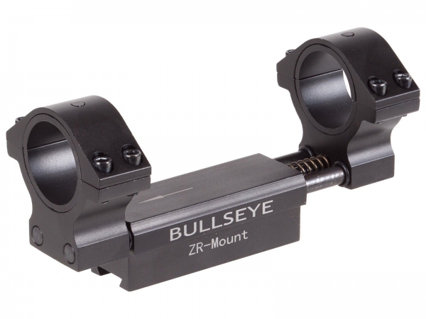

Back when I used to shoot springers,
I had hit and miss luck with scopes - most likely due to their recoil..
There are mounts available that help prevent - maybe even eliminate issues.
Example: Bullseye Zero-Recoil Mount
1547951445_5548866335c43dd55021485.15467985_PY-A-5495_Bullseye-ZR-1Pc-Mount_1512758230.jpg
https://www.youtube.com/watch?v=bBLiIeoxGTg
I wish that I had known about stuff like this years ago!
More scope options, and no doubt would have saved doll-hairs in the end.

Iv been using the Diana ZR1 mounts for a few months now, 1 on my D350 Magnum a real scope killer.Have a Hawk Vantage on it after months of shooting no problems.I put one on my H+W 98 with a Hawk Air Max 30 and am getting great groups with no POI shift.I also have one on a D 430L with the Diana scope (AOA deal for $300) you can use any scope with this mount. Iv been shooting spring guns for many years and have tried many combos of scopes and mounts and I think the ZR1 mount could be a real game changer.
