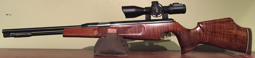

I use a Lepers 3x12x44 Mildot etched glass reticule on my .22 TX and am very happy with it.

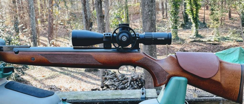

I have two under-levers, an Air Arms TX200 and a Diana 460 Magnum (and a Diana 48 side-lever). I have Hawke 3-9x40 scopes on all three. It didn't take long for the 460 to destroy the Hawke I put on it - got where it won't hold zero. The ones on the 200 and the 48 faired well.
And then I head about a mount made by Diana called a NR Bullseye (No Recoil) mount. They made the mount just for springers. I got three and used them to re-mount the Hawkes on my springers. So far all is well. all the scopes are doing well. And the mounts haven't hurt the guns' accuracy, either.
