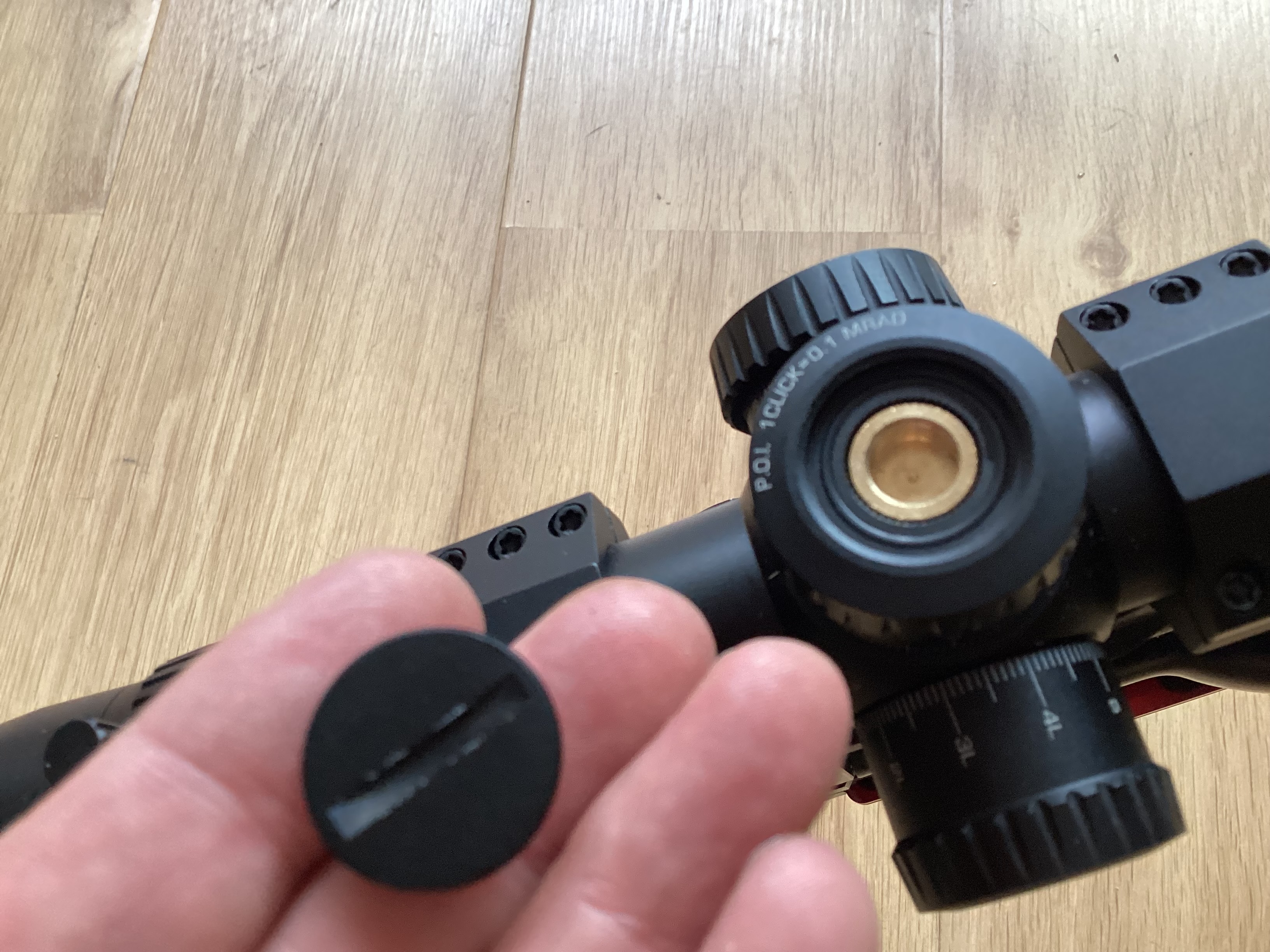

I have a Optisan EVX gen ll 6-24x50 First focal and it’s even more clear as the previous one i have!
This one also has stainless inner parts so doesn’t were out anytime fast! Markings on the parralax wheel match realtime!
Included are a throwlever, sunshade, extra turret cap where you can put youre own data on! And flipup caps.
Also has quick zero adjustment bij unscrewing the cap!
I’m going to use it when we organise our first NRL air and .22lr match!!
I’m quite happy with it!

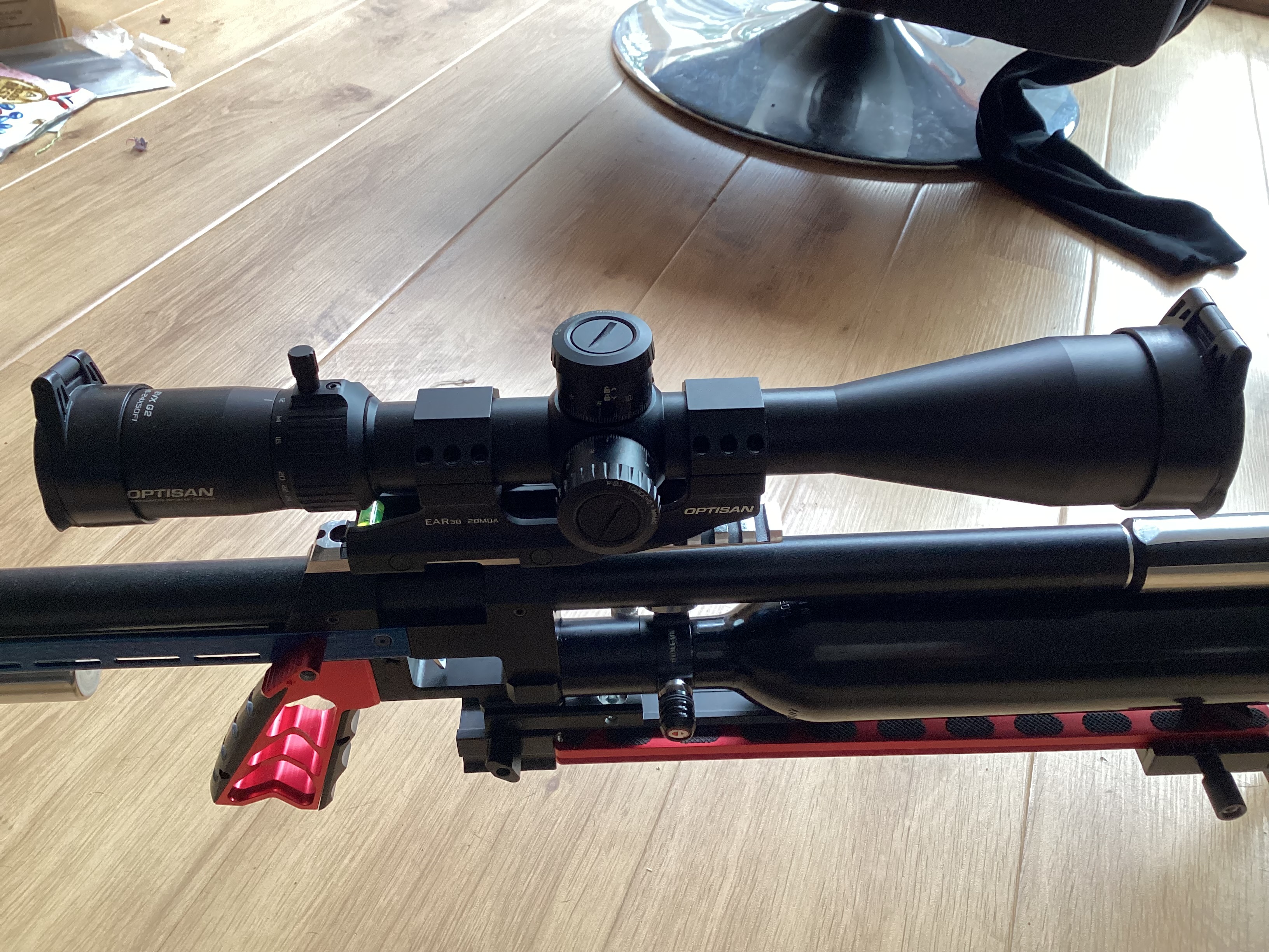

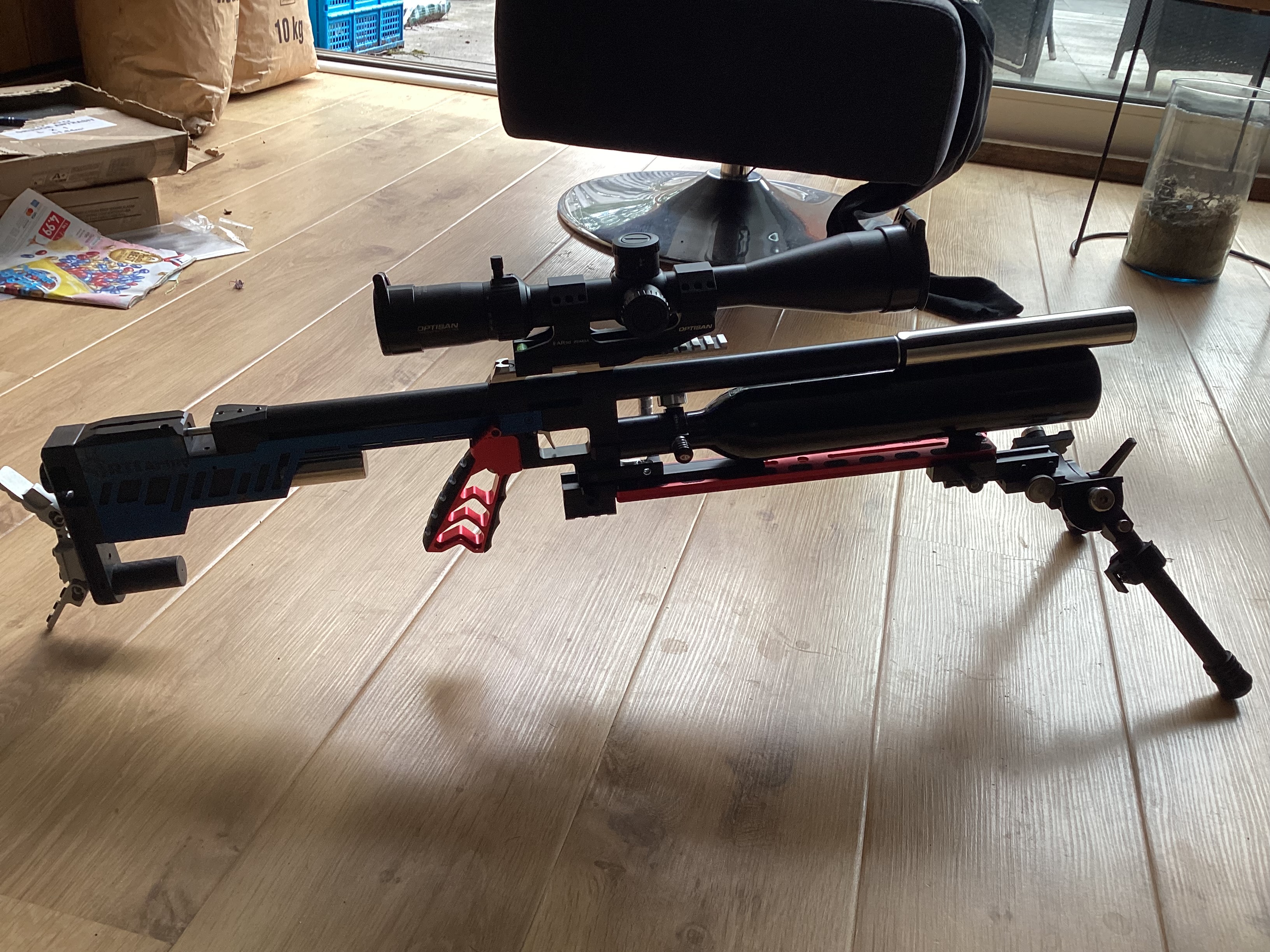

And the First model from 3 years ago..
