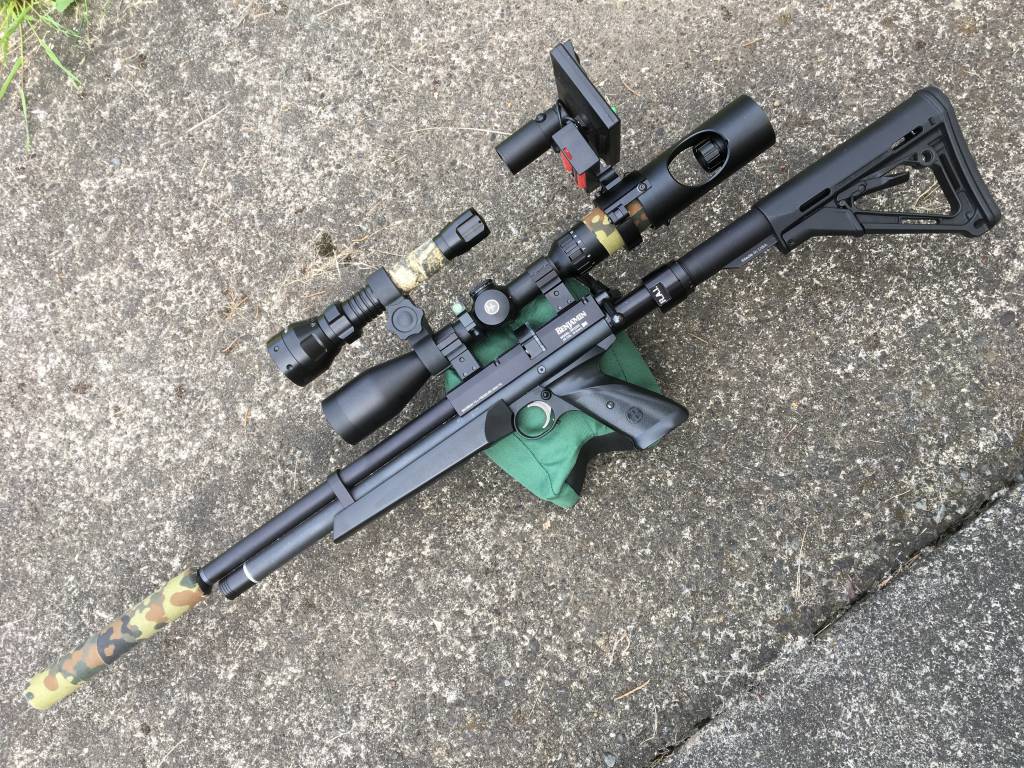

So what I’ve been shooting around my yard for the last year. Day and Night. Is a Benjamin Marauder pistol .22 cal. Now mine is shooting 16 (ish) Grn H&N Field Target Trophy’s At 600 FPS. Somewhere around 14 FPE. At 20 yards a broadside shot will go clean through a rat. So you could de tune yours. Which is simple but you do need a chronograph. I almost always hunt over a bait pile. So I set up backstops where needed. Hitting a concrete wall almost but not quite straight on. The pell drops on the spot. I’ve shot it at mice. 6 yards away. Shooting down the stairs into my basement. And have had no issues of ricochets. Not saying they can’t happen. I’m just giving you my experience.
With the suppressor this gun is very quiet.
Here it is with the econo night vision setup.

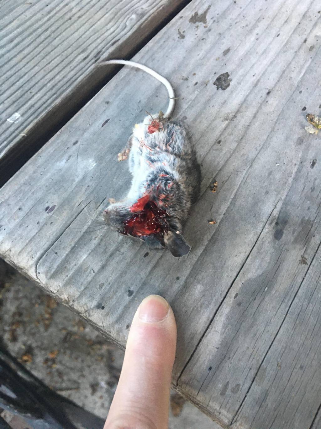

This mouse was taken at night at 14 yards.
