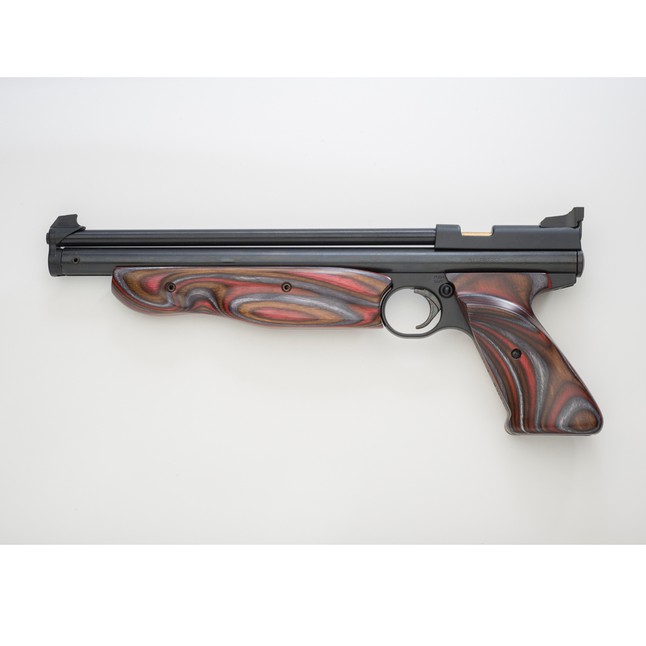

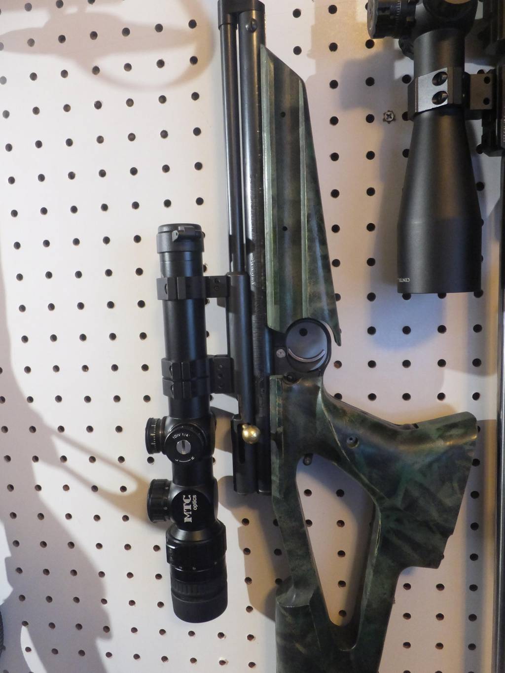

Although those forearms are a work of art I can’t see how they will help with the cocking effort(*as mentioned above).To help with cocking you would need them to be longer to get more leverage. Only thing I can see them helping with is getting a better grip. Can anyone confirm if these forearms help with pumping force and not just a better grip?

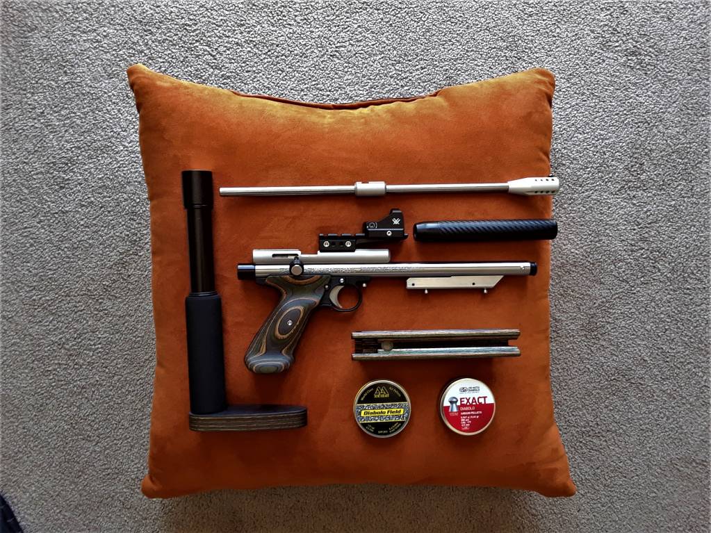

If they don’t help you can do a few mods to get the same amount of power with less pumps. For starters, a longer barrel will be a big help. If you want to go further you can also add a flat top piston and valve. With these mods the gun will require less pumps for the same amount of power you were getting with a stock 1322.

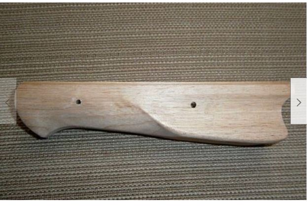

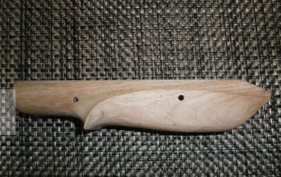

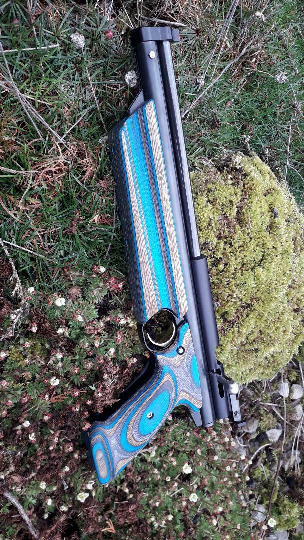

The Tom West one I posted has a massive increase in leverage. And is the only reason I posted it. It's at a different angle (which helps) and the grip comes way back over the trigger guard allowing me to hold it wayyyy far back while pumping
