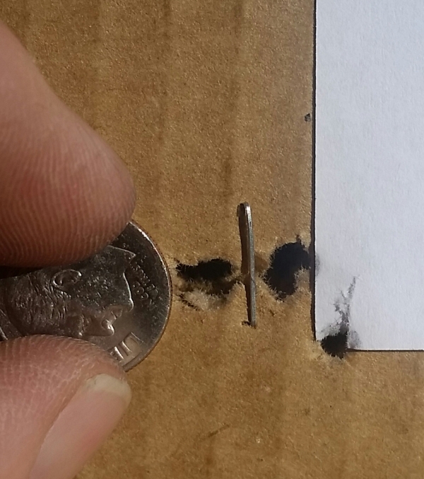

Stock barrel with CPHP at 27 yards
Marmot Militia with CPHP from 27 yards. The cross hairs covered the staple. I tried and tried to hit that dang staple. 8 shots into 2 holes.
