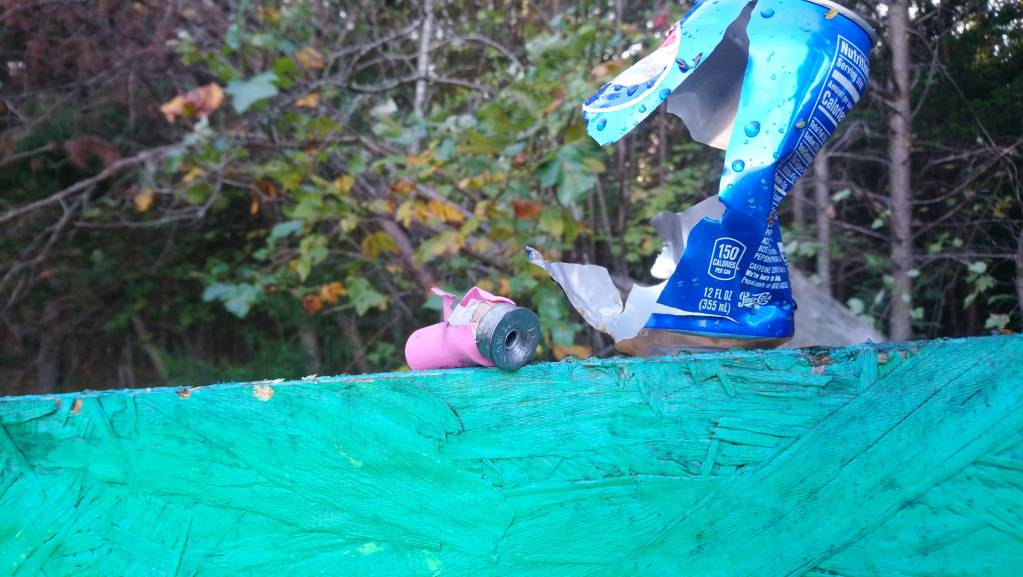

Honestly, my Crown has been really top notch. I actually shoot off-hand a good bit while hunting, and the gun does lend a ton of confidence. I think it really boils down to the excellent balance of the gun, but more importantly, the soft/mild hammer cycle. Having a semi-balanced valve, it does not require much hammer strike to operate. I can honestly throw the gun on a sandbag loosely. Without me holding it, and pull the trigger, still not holding the gun, and it will hit it's target ( 12oz can at 100 yards), same as if I were holding it firmly. Though maybe shooting 2 or 2.5 moa instead of under 1. But that does say a lot.... for a gun to be THAT stable through the shot cycle....

Dang that can got its butt kicked

36gr .218 boat tail @ around 800fps at point of impact. I was pretty tickled I was able to hit the shotgun primer, though

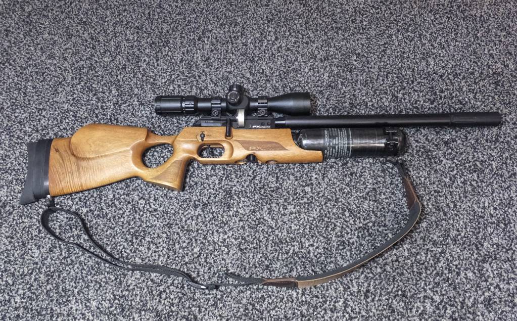

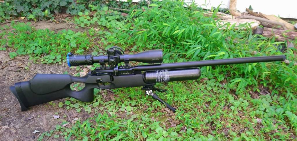

Adding a walnut stock to my Crown pulled the balance rearward, and also added some weight for stability. (synthetic crown is 6.5lbs un-scoped) Scope mount position, as well as weight will play a huge role in balance, and overall heft. The Crown with the superlight barrel and wood stock PLUS 50mm scope comes in around 9.5lbs, but feels nothing like it due to so much weight being absent from the nose of the gun. I actually don't use my 50mm scope for hunting anymore, though at the 9.5lbs, I could still do off-hand without losing any confidence.
Moderator weight comes into play as a huge factor due to having so much leverage at the nose of the gun.
Here is how my gun is currently, so you get an idea of how it has been structured for off-hand shooting. The entire barrel weighs just over 8 ounces (cant recall the exact #) And the moderator weighs just under 3oz.
Sling for added stability.
8lb 13oz as pictured with loaded 12 shot magazine
