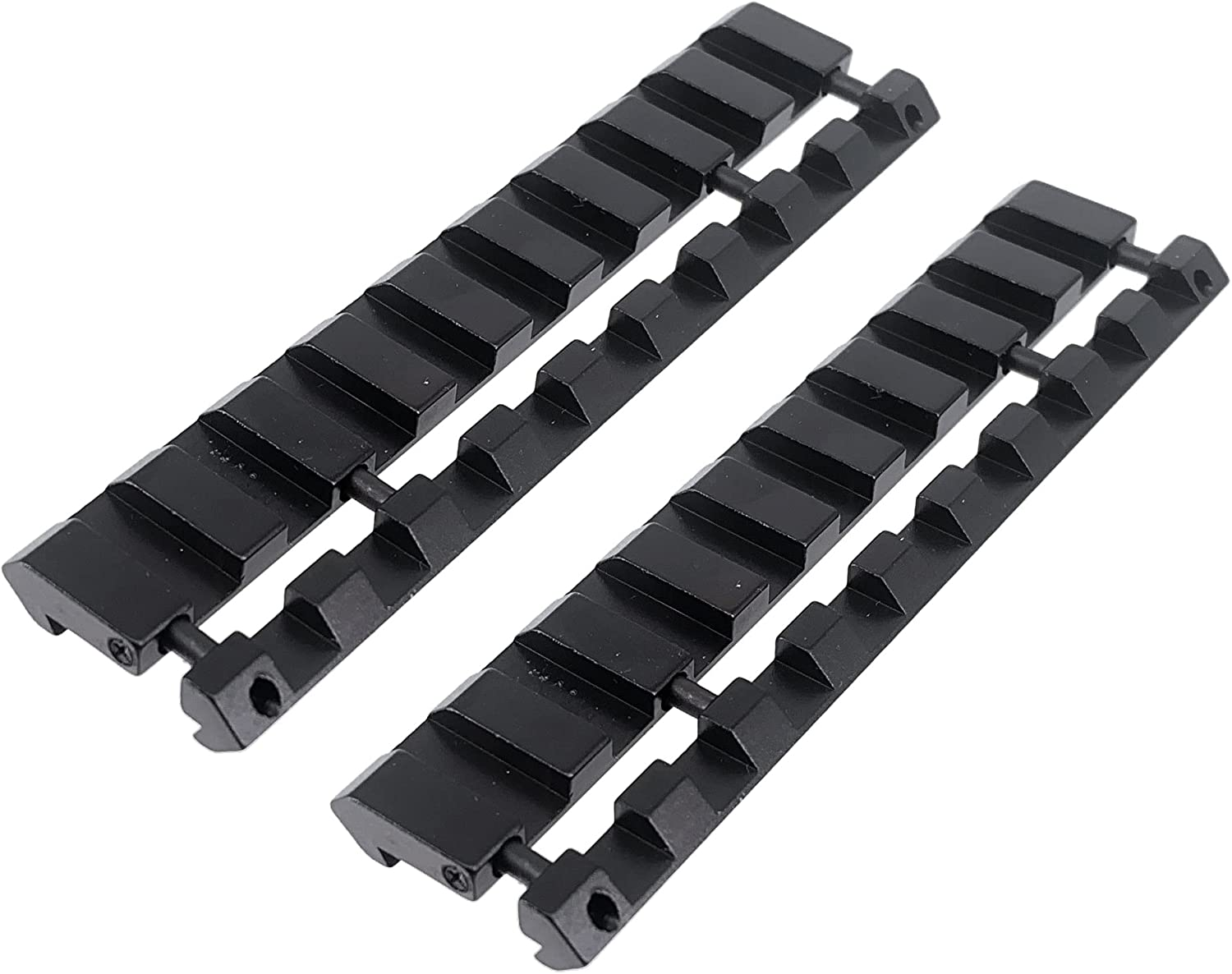

This one looks interesting. Like the short ones but it gives you a low profile longer full picatinny slot rail, but it doesn't have a recoil screw on it. That could be easily done though.
That Eagle Vision offering looks a bit more robust in the pins that connect the two halves together. I will have to try a set sometime.
I bought the EagleVision long version for my PP700 (similar to the pic in the previous post).

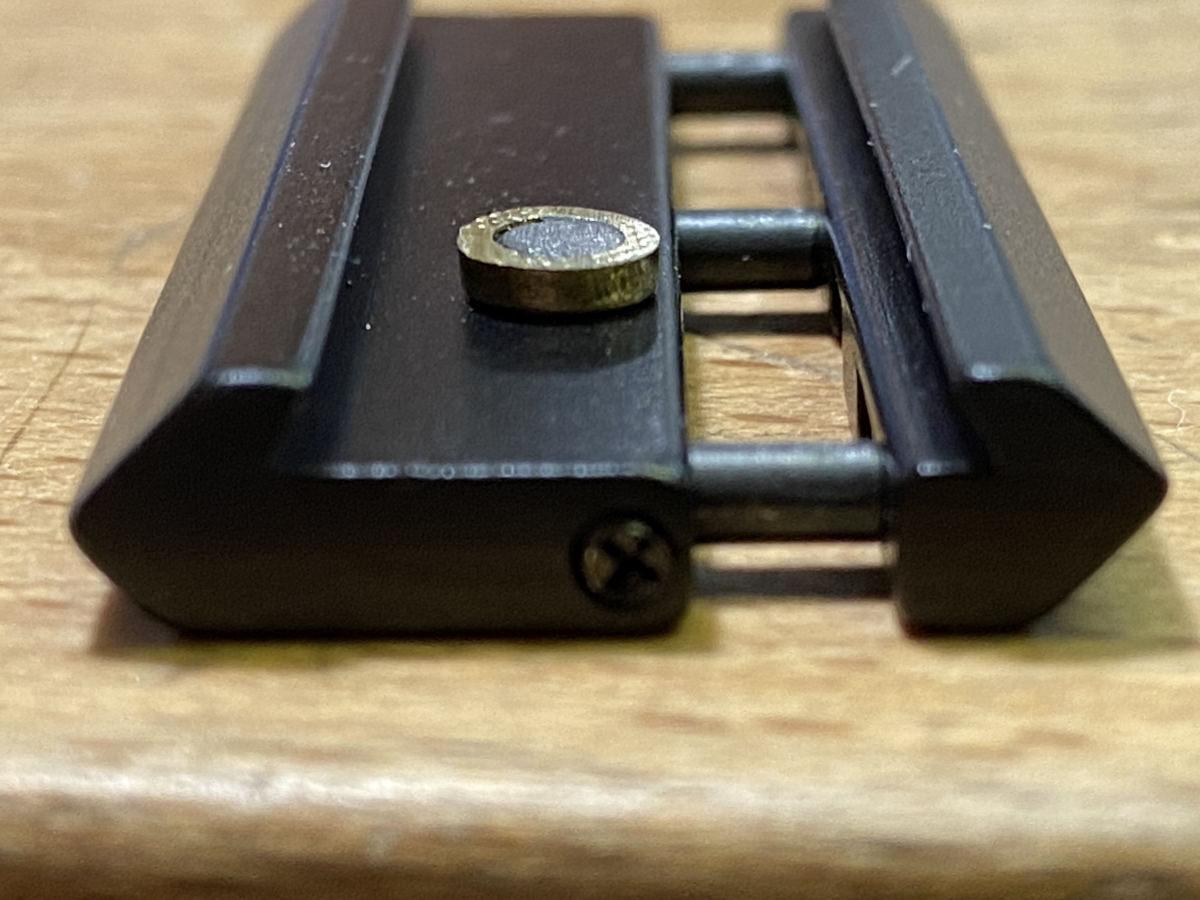

The last ones I used were the 46mm/ four slot version of the low profile adaptor like that posted by 2L8 above. Like Geezerhood said, it is easy enough to add a stop pin. I did so by threading a grub/set screw through the adaptor and into a brass bushing that fit the diameter of the stop pin hole in the compression tube/ receiver (see pictures). Using two of the shorter rails allowed me more flexibility in placing the rings.
