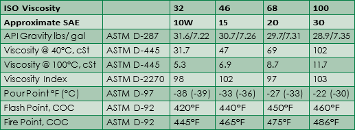

Going to buy a youg heng compressor and been doing some research on the oil to use. I think I'm going with the Jenny Ultimate Blue Synthetic Oil 20 weight this is cheaper than the royal purple which is 30 weight and flash point of 470 the Jenny has a higher flash point of 507 and beats in the Royal purple in the specs I have researched. I seen people are using Hydraulic oil. Here is what I have found look at the picture of the weight of 46 hydraulic oil and the flash point. What's of through?

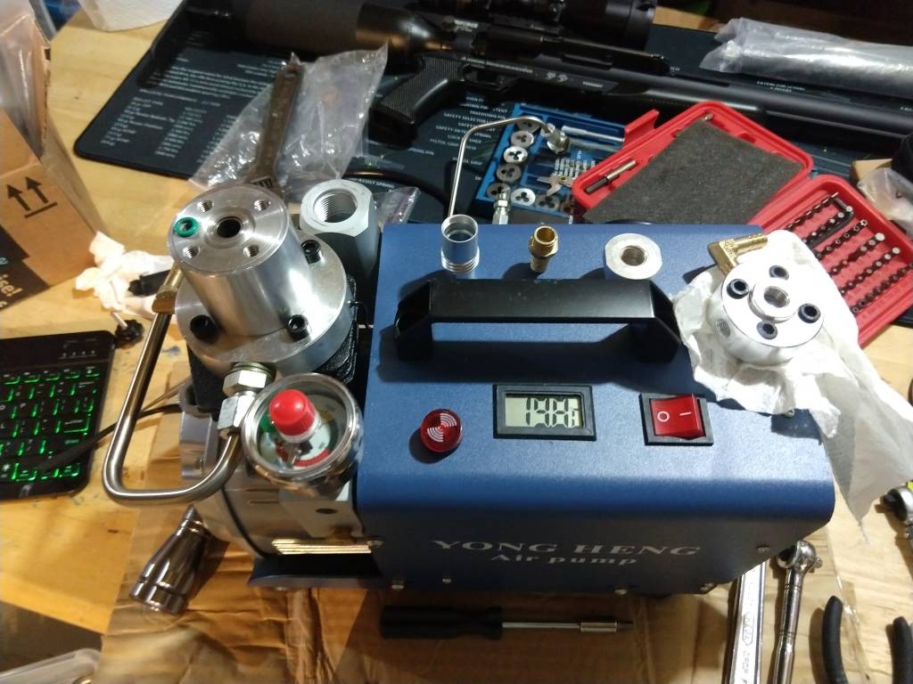

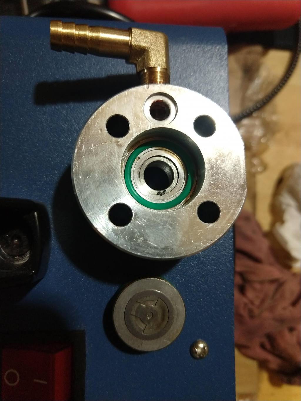

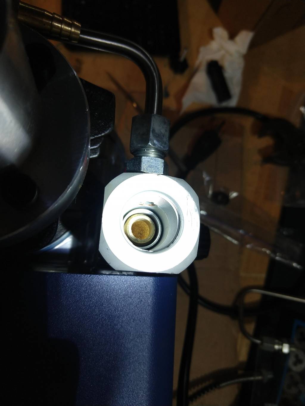

Just tore down a new, never-used new-in-the-box Yong Heng compressor from Yong Heng:
Low and high-pressure pipe hole threads weren't tapped well, so the stainless fitting threads cut themselves a path and pushed chips into the cylinder. To help matters get worse the air/oil separator parts were at the bottom of the housing--never having been assembled! Just sitting there, like the starter capacitor is (it lays on the motor unsupported, also getting cooked). The start of all this tear-down is the high-pressure manifold block was never fully tightened and flopped around, which was the first red flag. That made me curious what condition the one-way valve that sits in that block was in (it's fine). Finding the unsecured capacitor lead to the tear-down of the rest of the block, leading to tear-down of the head, leading to...
So USE Seco Lube 500 | SYNTHETIC CL-581815-LQ @T3PRanch linked to!
Hmmm...not supposed to be sitting on the bottom....
That doesn't look right...lovely...
