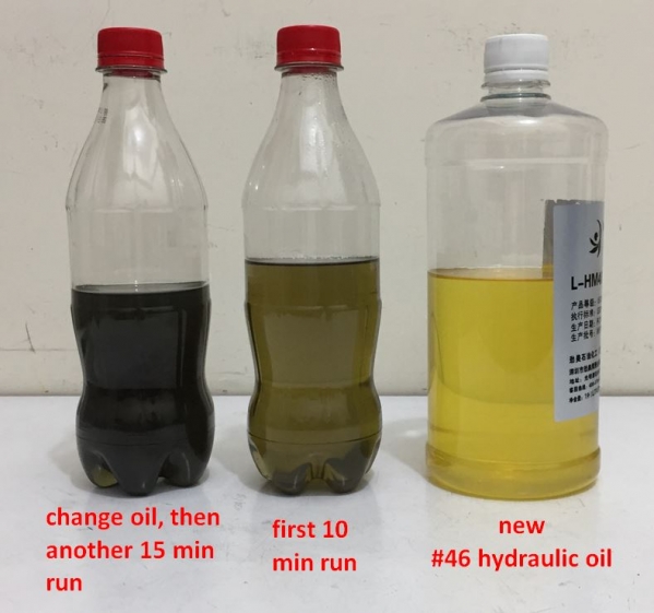

I fill to top of red dot as pointed out on attached fill warning sticker. While the manual warns about over and under fills, the choice of oil had me searching for alternates 3 years ago. After 40 years of dealing with hydraulics, keeping my equipment level, when not designed for marine use, is checked. When front cover off for cleaning, it's interesting to see where the dipper is positioned at BDC. Whew, nothing busted yet. Cheers!

I like the flash point of the 427, higher than the favorite internet oil Royal Purple another gear pump oil. I'm sticking to ester based non mineral oil as it (seems) to do better, lower temps and smells and used by Bauer and other HP Air dive compressors. The shipping cost of Seco lube is a killer so always looking cheaper. I like redline, seems to work well and all indication better than antifreeze for Alu corrosion. I run on a 30 amp 115 volt circuit and keep a box fan to keep that motor temp down as its a hot running bugger. I found the white motor cap loose so used a dab of RTV to avoid any possible damage, non found. Temps about 50C, indicated, box fan running. So, half than cost of a CX-4 and higher flow rate, me will stick to the YH, to free up hidden funds for next PCP, no?
