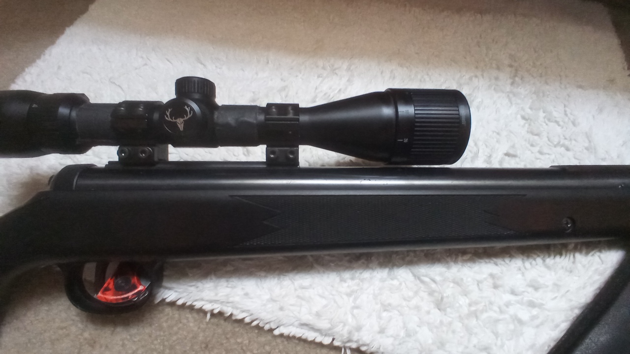

I've had good luck with Hawke and Sportsmatch low 2 piece mounts. I've been able to pair Bushnell scopes with a 40mm objective with them with great success.
The Diana scope rail is just high enough to allow the clearance. The trick is to purchase two sets, and use the rings with the recoil pin on both ends of the scope rail.

Are you actually sticking the pin in the recessed hole or hanging it off the edge against the riser block both front and back thusly locking it?
The hole has never worked for me. Ends up shearing or bending seems.
This was before I knew what I was doing so. Yes I think BKL low will work.

Using the recoil pin holes that are provided, not hanging off the edge. Trust me, it has worked on the 34,48, and the 52 and Bushy scopes with 40 mm
objectives -
Of course BKL are nice too, but I don't know how "low" their low rings really are?
Maybe someone with a Diana w/BKL low rings will chime in with a pic like I provided?

This is #21 wearing a BKL-260D7-MB
That’s an old Vortex Diamondback 4-12 x 40.
The actual OD of that objective is 55mm.
