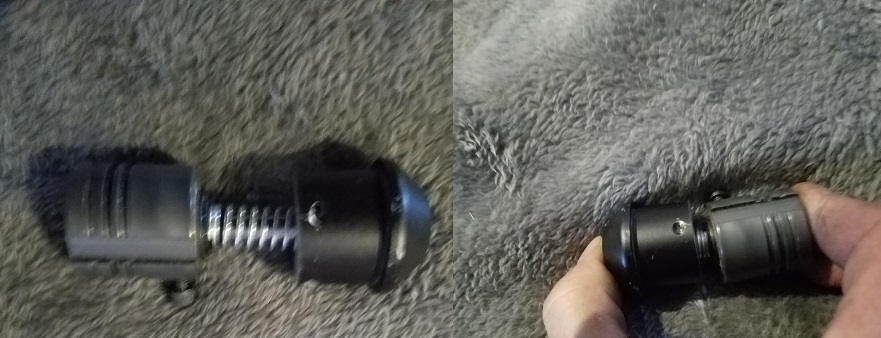

I will however show you a picture and describe it a tad...but the details that go into this build are too much for me to want to write out to the T, nor do I want to 'support' this method with people asking this or that. My design is a 'behind the hammer' design that doesn't add mass to your hammer, nor does the design rob or steal some of the energy upon departing. My design allows the ssg to retain the tune, so I can simply remove a rear adjuster cap I had custom fabricated to the rear plug, and swap 'tunes / springs' in 15 seconds.
The build requires a hammer well that is a bit deeper than the hammers throw to allow it to cock, it also requires the head of the ssg to be twice that of your gap, it also requires the rear of the ssg bolt to fit within the gap adjuster screw by a distance twice that of your gap, so that your internal ssg device never 'falls' out of place...those two parameters / tolerances are very tight being .1"~...but manageable. All said, this method is far more complex to integrate into a marauder than most people are willing to do. It takes either hammer modification or a custom hammer to allow a .85"-1" pocket, and a gap adjuster with a .1" built in pocket for the bolt to rest in....This design requires 1.75" - 2" springs, or further modifications to allow 2.25"-2.5" springs. My personal spring ratings range from 5 lb, to 10 lb, making 20 to 70 fpe on those ratings, with a 51 gr hammer.
Nearly all other ssgs built for marauders use the through the hammer type, that both add a ton of weight to your hammer, but also rob more energy by design, making them require a bit more cocking force than the design I've shown here...

less than 2$ per ssg carrier..
hammer mods = free
gap adjuster and modding it = 30 cents
Custom springs = 12-20$ (I also use an ace hardware spring or two, which are like 1.70$ as YO mentioned, so that said you can get by with 4$ in springs...)
