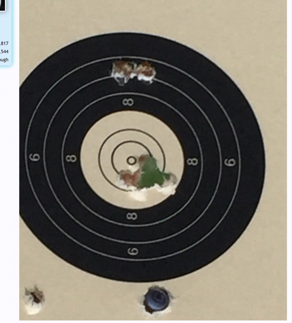

This target was shot at 45 yards, outdoors moderate tail wind. Theoben rapid .177 AA Diablo fields at 780fps
the top group (on the 6) is 8 shots single loaded
the middle group is 17 shots magazine loaded, notice the slight change of poi with the mag or it could be a slight lull in wind speed?
the pellet below the target is a .177 pellet that I pushed into the hole of a 4 shot group single loaded.

First off, I would agree with bucketboy. If your RAW is capable of shooting 1/4 inch groups it should shoot 1/4 inch groups in similar conditions. I would stick with it until I found out what was causing the group to open up and see if you can make the necessary adjustments to get more consistent groups.

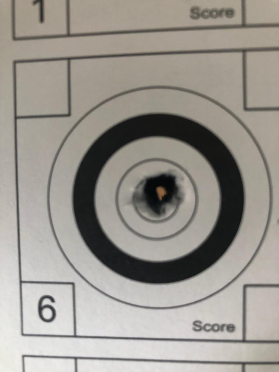

Plus one for the Thomas. While I haven’t spent much time shooting at 50yds. I can attest to the accuracy and consistency at 25yds. The attached photo is 25 shots at 25yds.
I prefer the loading ease with the Thomas over the Raw. Fat fingers and small openings become problematic.
My experience shooting at 50yds. is limited to field target where consistent small groups are not as critical so I haven’t spent much bench time there.
