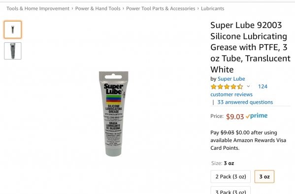

Any good silicone base/synthetic grease is ok...
A Very high flash point is a must.... that is why silicone base is recommended.
I also use Krytox... but expensive
But Any Petroleum base grease is a No-No!!!
