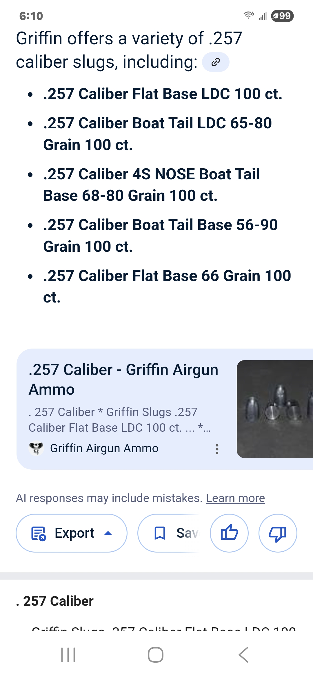

It depends on your setup. Usually something in the 70 to 100 gn range. I like the Griffin stuff.
