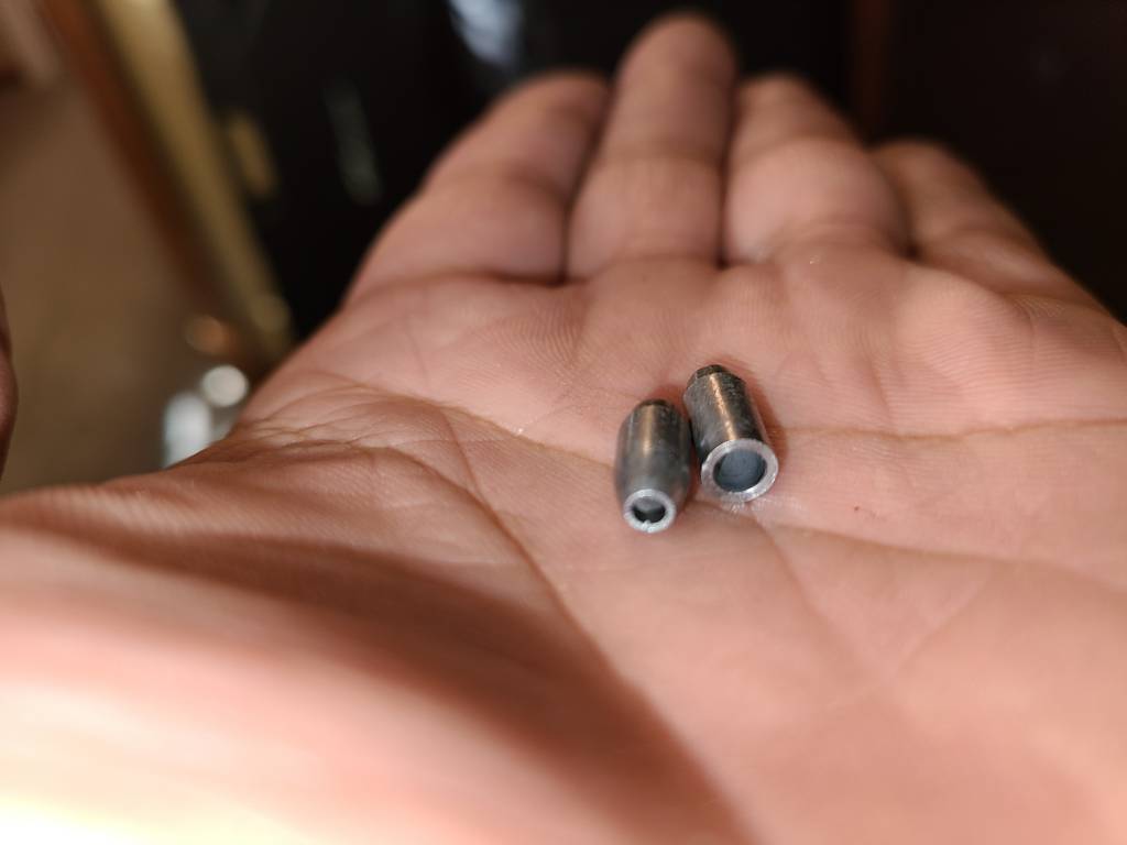

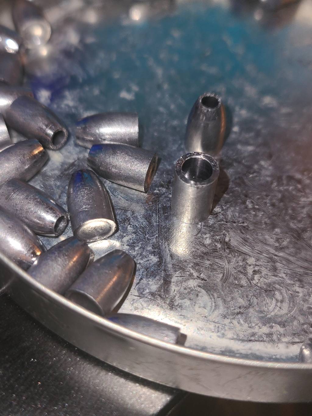

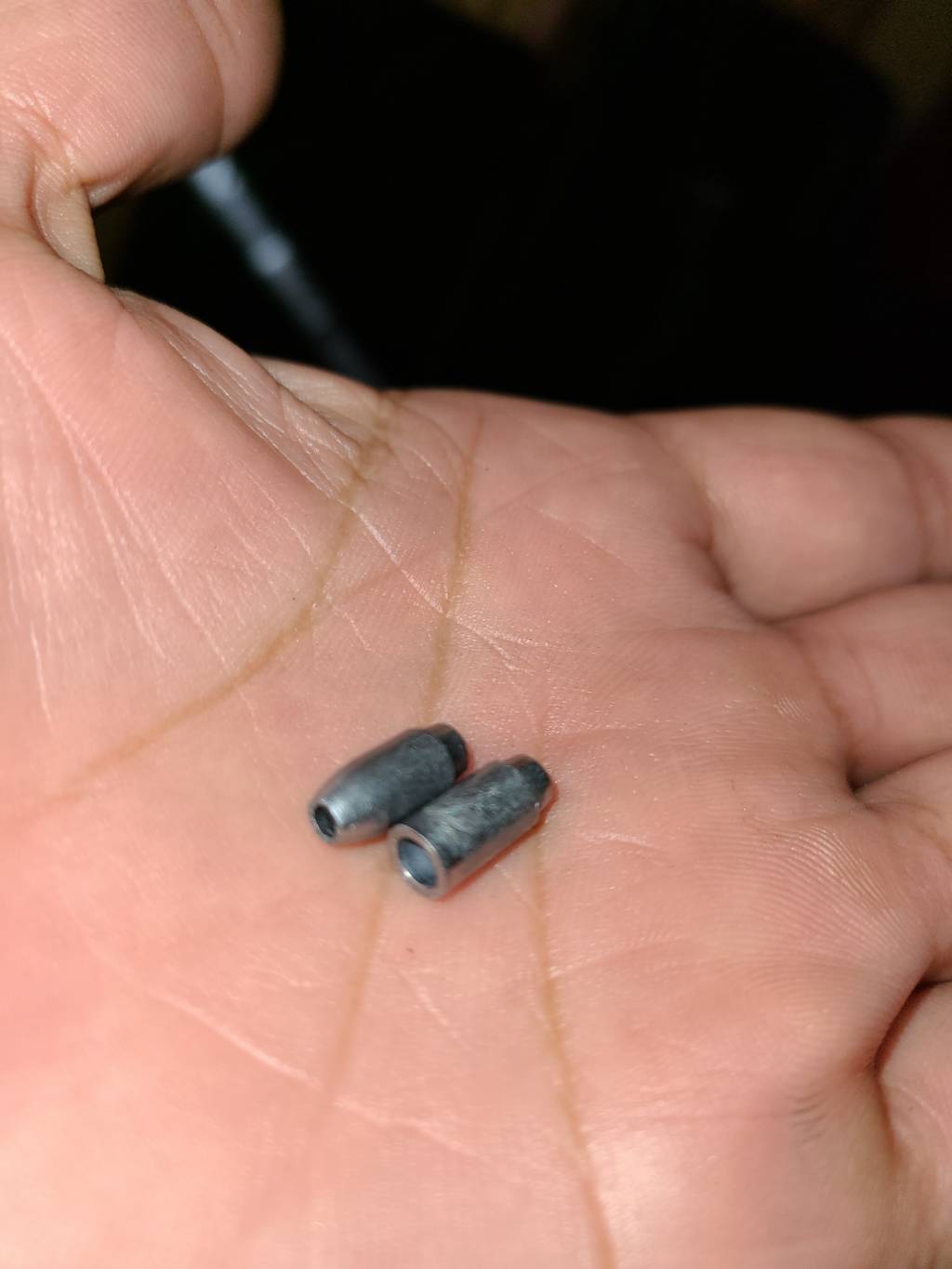

Sorry guys, forgot to post some pics.
Made some slugs, even hybrid slugs with boat tail.
The hybrids look like a hollow pipe, then they are shaped to a smaller point shape tip.
They shot great, groups under 1/2" at 50yds.
At 100yds 1"-1 1/2" groups, they seem to have more flyers than the NSA slugs. Maybe I just need to slow down and make them and sort out any slugs that are .02+/- or more grains different. I've never bought any FX Hybrid slugs, so there's no way for me to compare to them. Reading some comments about the FX Hybrids say they have more flyers than pellets and slugs.
All I know is that I can make 500.00 worth of FX Hybrid for about 50.00 of lead. I can afford to have flyers now and then, I can live with those numbers.
Plus, I can change them up and make different weights with the slugs. The bad part is the research in trying them out to determined the BC. Every time I change the weight or length, the BC changes.
I'll keep all post on progress.
