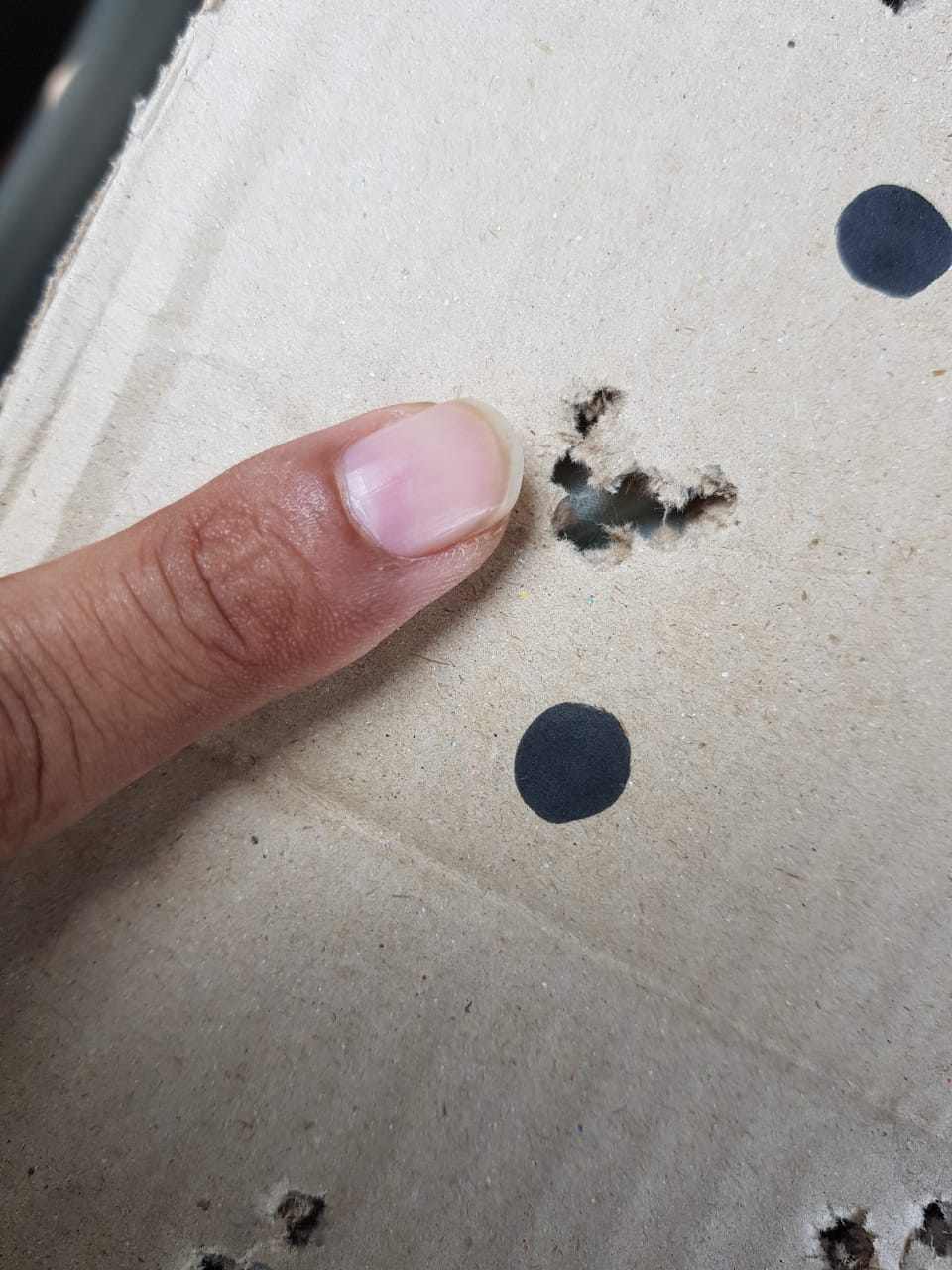

Can’t say for the pellet liner but out of the slug liner they work great! Tight groups. They are what I plink with when slugs run low. I think they are shooting at 950-60 with my slug tune
Mine is shooting at 950-955 with gud accuracy at 56 yards

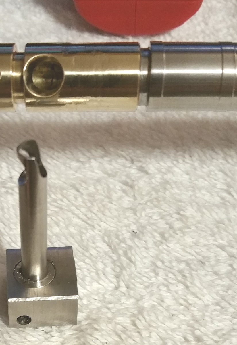

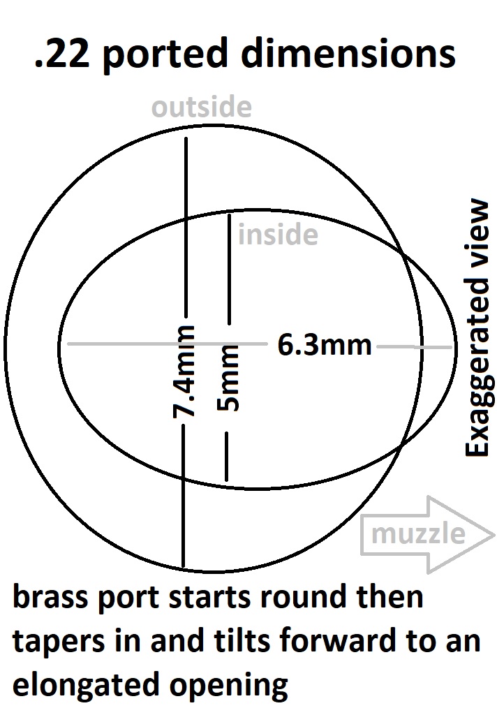

I have a MKI with 5.8mm valve seat (stock size is 5.5mm), elongated brass transfer port and probe, delrin C3 bumper and 20cc external plenum.
Redesigned Monsters do 1015 fps at 130 bar from the 700mm slug liner and are very accurate inside 50 yds. I haven't tested farther but Edosan uses them in competition at 980 fps.
Pics of the port and probe. Pellet and slug feeding is same as unmodified. Both parts can be purchased new from FX USA if you ever had the need to return to original condition. For warranty work install the unmodified probe and ship the gun without barrel, bottle and magazine.
