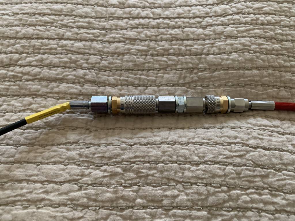

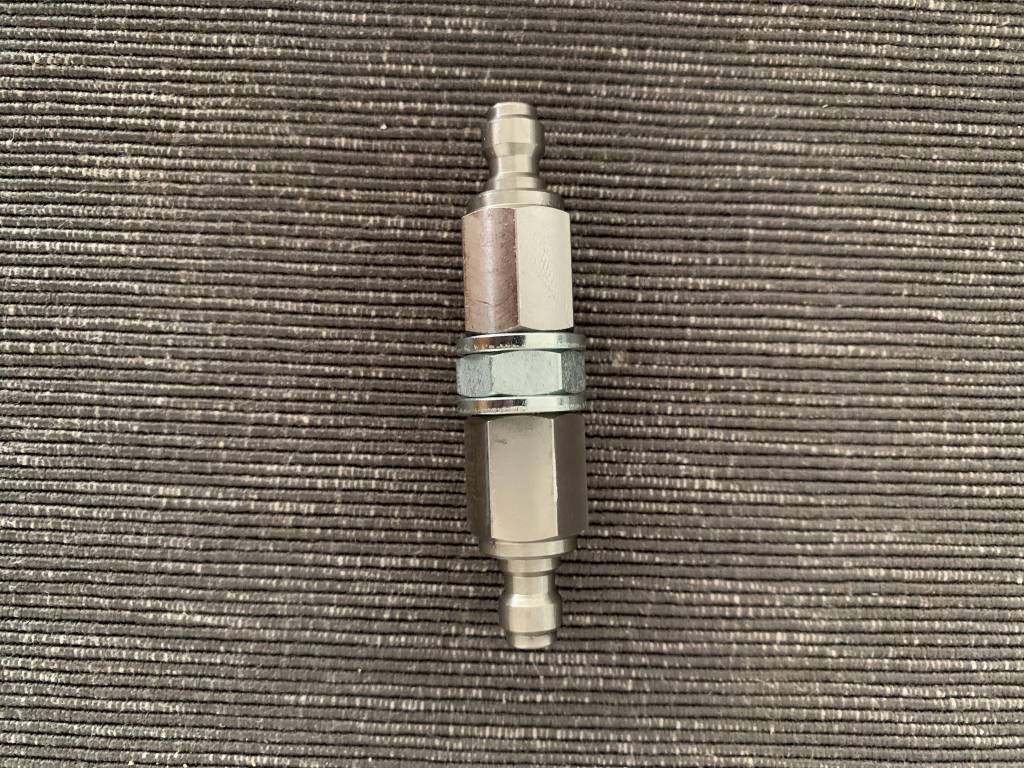

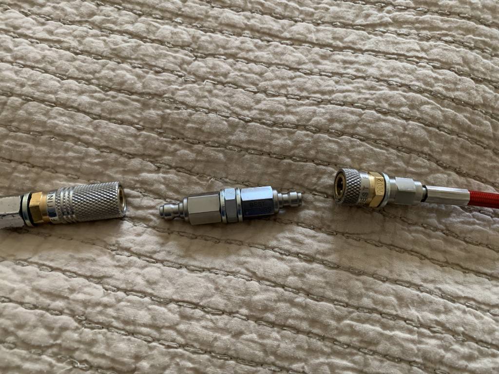

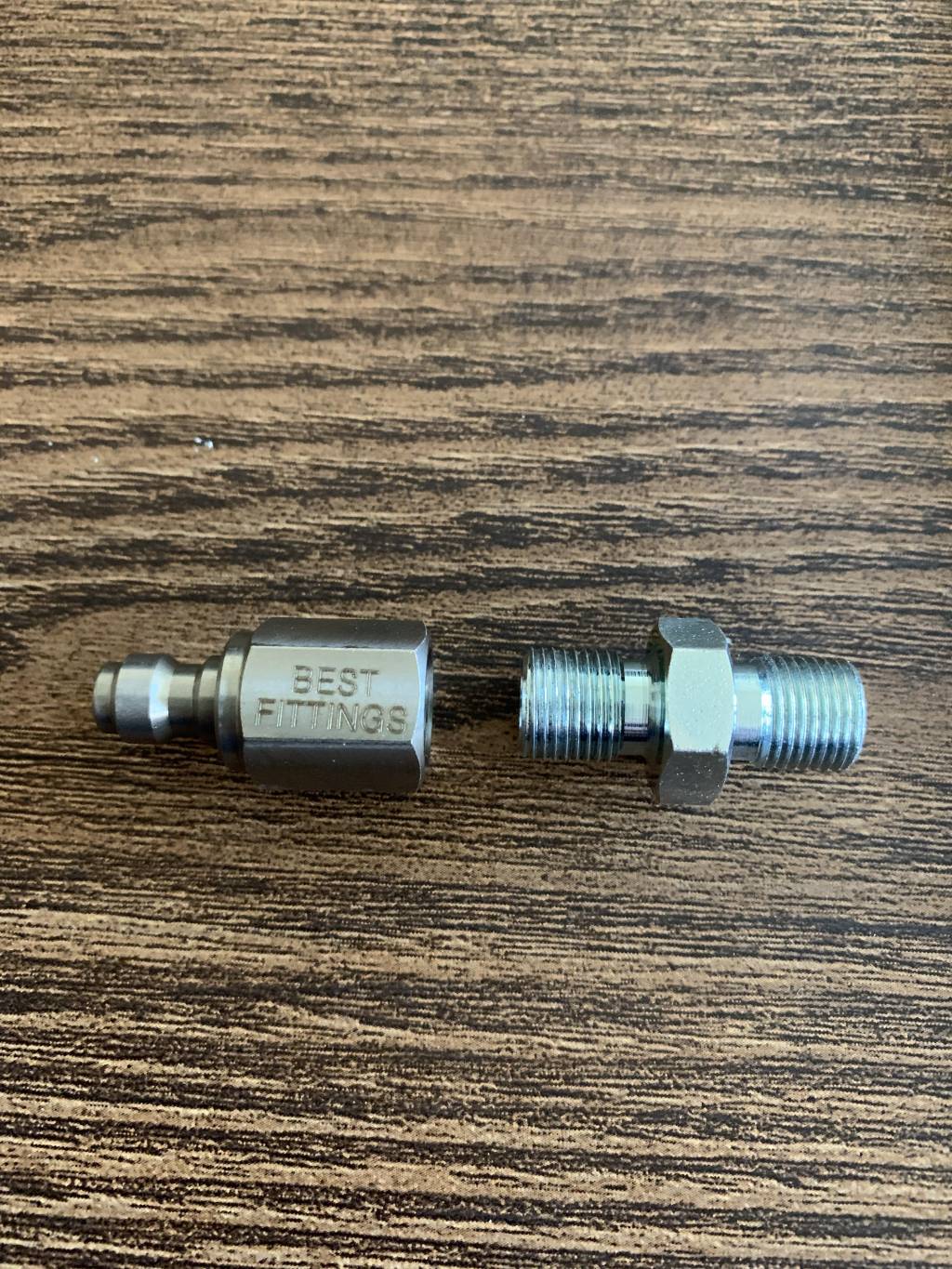

Easy, the foster fitting coupler I made using the Forster fitting “quick connect” link you would on your probe. It was like $5 in parts from best fitting.
So I connect the tanks’ hoses together to each other, 7 L to 1 L. And the pressure in the large tank then fills the smaller tank. Kind of Redneck, but seems to work. In between foster fittings is a male coupler / union. I figure for a hunting / HFT combination sub-12 ft./lbs my Brocock gets 3 to 4 fills which translate into a tin of pellets almost.
