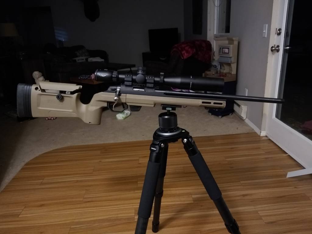

Best FFP Scopes under $550 “retail” for NRL
I’ve recently started shooting NRL with a 22 rimfire (a Tikka) and with a .22 Uragan for airgun.
I want to shoot base class for rimfire which requires that gun and scope cost less that $1,050 retail in 2022. The Tikka and the CZ 457 have models in the $500-600 which leaves $400-$550 (for 2022 retail) for an FFP scope with a good reticle.
Question: What FFP scope would you recommend that clicks, has good optics and a good reticle in this retail range? ( most shooting is done from 10-14x)
Athlon, has good options, and Bushnell sells a scope specifically designed for NRL but they are sold out.
What do you suggest?

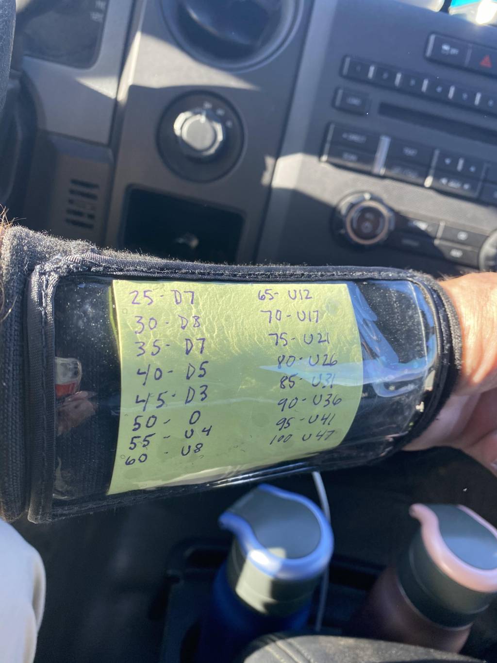

I’ve shot hold over and used reticles set on a particular powers for years on ground squirrels and starlings.
As I’ve pushed my shooting distances out to extended ranges... I’ve found that clicking is vastly superior and nearly as fast... an enormous improvement.
I can’t imagine I’ll ever go back for long range shooting.
Hearkens,
I try to make myself shoot with holdovers, but I end up dialing the scope most of the time....
And just like you say — for longer ranges elevation turret dialing seems better:
(1) In ChairGun I calculate my preferred point blank range (PBR), putting the far zero at a range that will give me a large PBR.
➔ So, for all the critters within my PBR I just center the crosshairs on their kill zone.
(2) For the longer range shots the critters usually give me more time — since they don't think I'm too close to be dangerous.
So, I got extra time to dial my turret....
And...: I won't have to fool with centering a piece of "nothing" of my reticle on the killzone.
(Sure, with a grid style reticle, I'd get a little "something" to place on the KZ.)
(3) I've been scheming to 3D-print turret bonnets with the range markings on them — that I can switch out in seconds if I change the pellet or power setting.
This will cut out the look-at-the-dope-card step.
Falcon and Discovery have several models that have 6 indentations in their turrets where the turret bonnets could be ankered securely.
(4) I still prefer to have scopes with holdoff reticles — to be able to use windage holdoffs, as wind can change rapidly — range not so much, unless I have a moving target, of course....
And for the occasional holdover shot.
Matthias
Mathias
funny how so many of us wind up with the same conclusions... I agree with all that you said.
I would LOVE to get a 3D turret attachment that slipped over the existing turret. Great idea.
During the winter I hunt starlings indoor at night (it is lit to promote milk production) in two barns that are 460 hards long each. The barns sometimes have 100,000 plus birds in them that keep moving further away as we shoot. They seem to feel safest when there’s at least 70 yards between me and them. We hunt with 177’s so as not to damage the roof,
which makes for challenging shooting when most shots are. 70-100 yards.
I use a Bushnell 6500 with 2.5-16 Tactical scope (big turrets and great optics) and noticed that my kill ratio jumped at least 30% when I converted fully to clicking.
