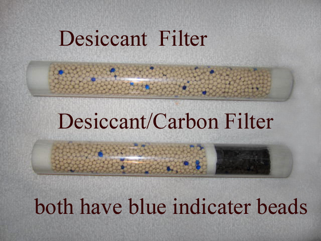

The OP asked "what is the best desiccant"? The answer depends on the application. Silica gel beads turn different colors after they are saturated. They work best at atmospheric and low pressure applications. They are often used in a filter placed between a first stage shop compressor to a Shoebox or Altaros booster compressor. Silica beads are sometimes used as saturation indicator beads in a high pressure filter. They should not be used in a high pressure compressor filter as a desiccant sieve substitute. Dessicant sieve adsorbs (sic) moisture efficiently at high pressure whereas silica gel absorbs moisture at any pressure. Most replacement filters for high pressure compressors use colored indicator strips instead of silica gel beads to show the level of moisture saturation in the filter media.
I wonder if you could reactivate molecular sieve with a torch...
NO. A torch would ruin the desiccant. It's the equivalent of burning down a barn to kill the rats. Sieve desiccants actually work under high pressure to collect water vapor by molecular attraction. It takes hours of 1000 degree indirect heat in a purpose-built oven to reverse the adhesion process and allow the desiccant sieve to release the water molecules which bond to the sieve under pressure. Direct contact with a torch flame would tun the sieve to burn ash. Sieve is usually replaced after it's saturated rather than recharged. Most high-end compressors use disposable filter cartridges containing desiccant sieve and activated charcoal.
