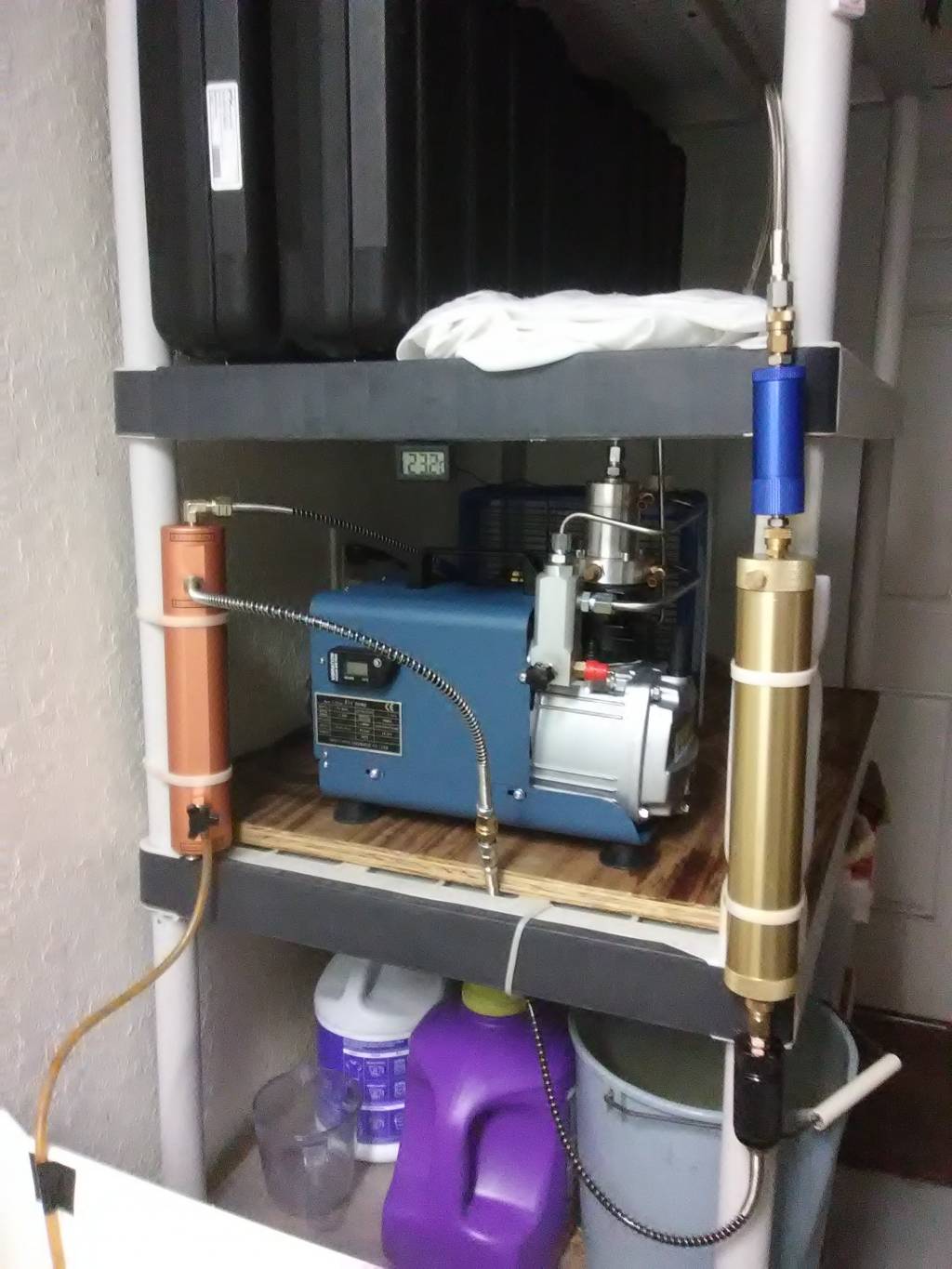

Inexpensive Chinese (under $45) handpumps are easily found on eBay. I have one that works great on my first generation Umarex Gauntlet, but proved a real workout on my FX Wildcat and M3. I bought this Yong Heng on eBay for $270, a few months ago. This set-up includes a water-separator (bronze-colored one by back wall) that I need for the humid Florida garage I use it in, you might not need one. Most only use the gold filter to remove oil and moisture from the air. I couldn't be happier with this set-up. WM
Yup as he said the Yong Heng is the one. It's actually about the best you can get unless you want to upgrade to the Alkin, Bauer or Coltri $2000+ units. So, at near $300, it's a bargain.

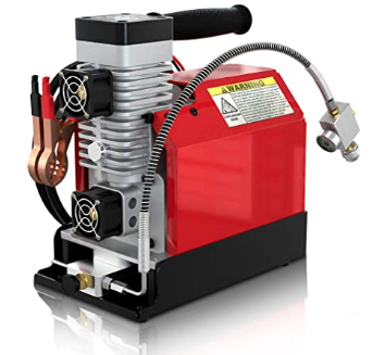

I went with this "GX compressor" off Amazon. It's about USD $380. It's air cooled.

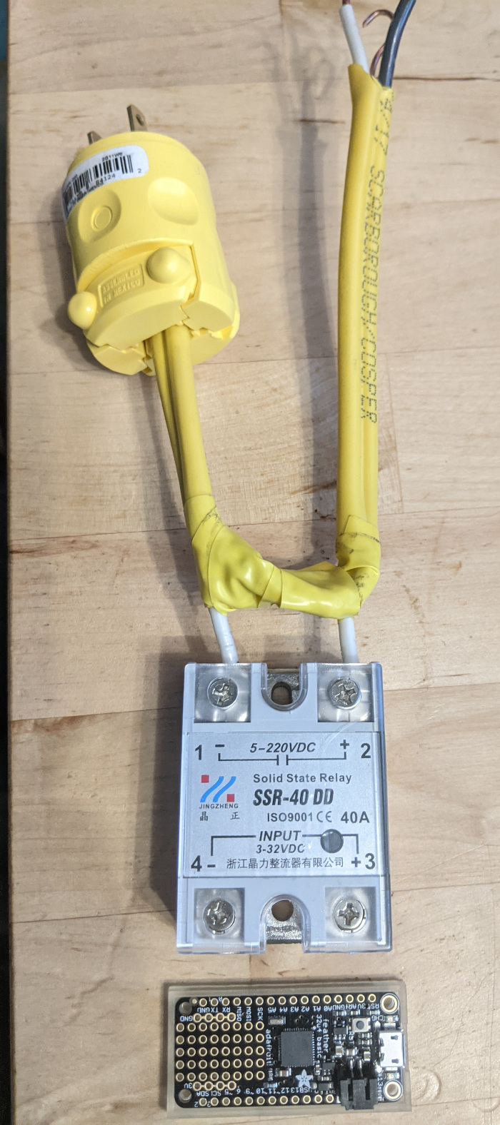

What I've done is bought a big air tank. Rather than worrying about a compressor that can fill a tank rapidly, what I did is build a small Arduino circuit that turns the pump on and off, to give it enough cool-down cycles so that it never gets very warm. I leave the pump on for about 90 seconds, then have it off for about 5 minutes. After about 3-4 hours, my Air Venturi 74 cu.ft tank is full to 4500 psi. That's starting from empty.

I'd love a copy of the arduino code and schematics!
The Arduino code is very simple. It's just an on/off cycle, and stopping after a fixed number of cycles, to avoid over-comprression. I'll probably modify the code eventually so that the arduino has a thermistor, to get a better sense for the pump temperature. I could also add a little camera for it to read the tank pressure meter. A less direct way to do this would be to record the current being used by the pump -- as the tank pressure goes up, the current demand goes up. That might be the more electronically-savvy way of determining a cut-off time.
I'm using an Adafruit Feather plugged into a solid-state AC relay. Eventually I might replace the pump's on/off switch with this feather-controlled relay, so that I can keep the pump's fans working while the pump is off.
There isn't a whole lot of safety precautions built into this at present. When you build this you want to have a relay that is "usually off". Avoid locking relays if you can.

I'll fire along some more details once I've got this process a little more reliably "cooked". Currently my circuit is torn-apart as I put together the 3rd generation...
