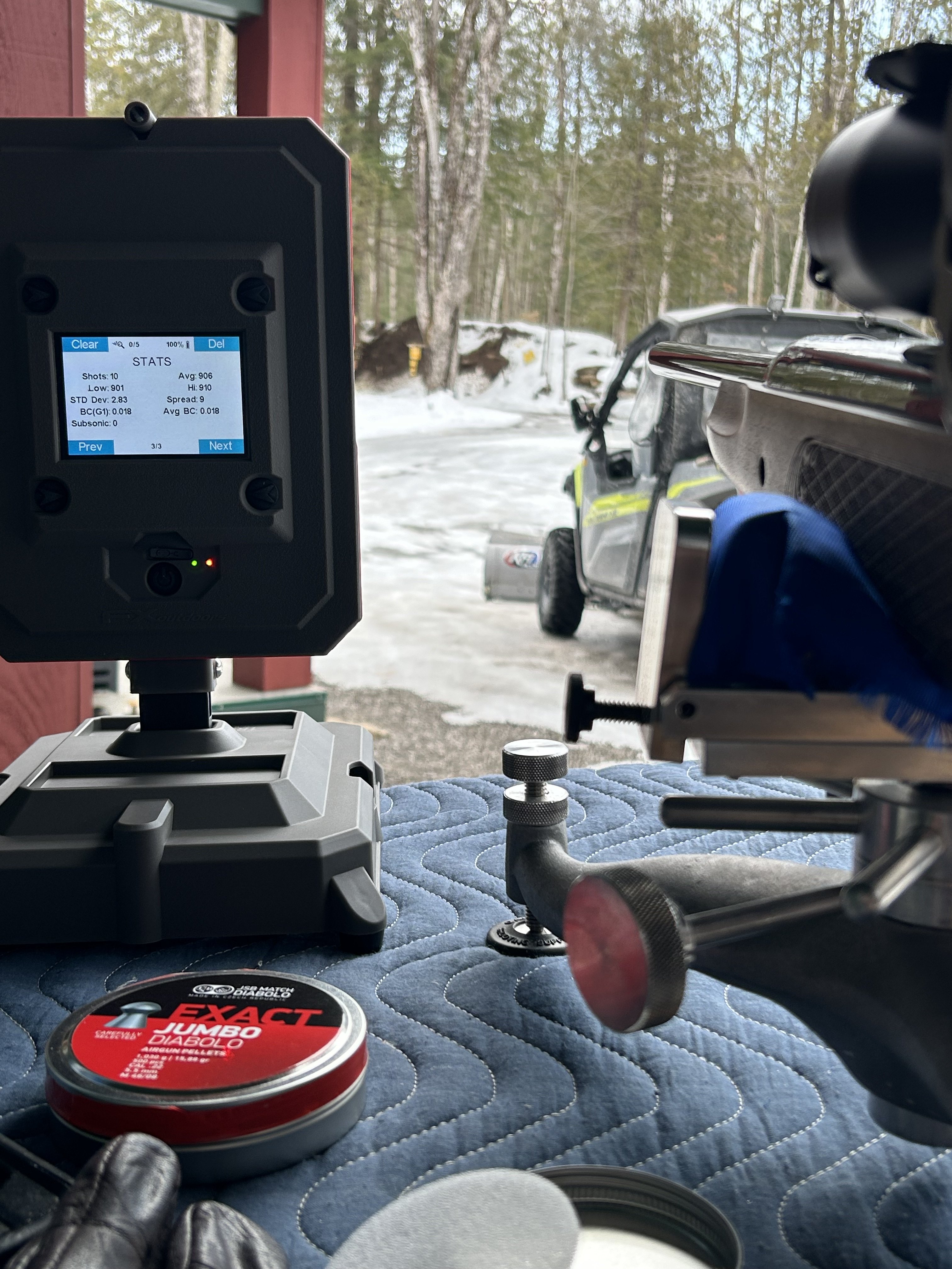

I started with the Pro Chrono years ago. It worked fine. Only problem was having to reposition the unit when I moved to different yardages with the pb. Switched to a Labradar when they first came out. These need a few accessories other than the unit itself. Needs a stand or tripod to keep it upright. Added the external battery to keep it running for extended range sessions. The battery port came loose from moving the unit around while still plugged in. Had to add a sighting device to make sure the unit was properly aligned with the target. Added the external trigger but now one more wire coming from the unit to the rifle. I have picked the rifle up off the rest forgetting to disconnect the trigger more than once. The Labradar does get readings down range but not sure how accurate these numbers are. I bought the Garmin zero and love how simple it is to use.
I tried it in the basement shooting my air pistols and it captured every shot. I even moved it as close as 3ft. from the target and it still recorded shots. I must add that anything less than 5ft. the velocity wasn’t accurate. It was able to record accurate velocity capturing only 5ft. of pellet flight. I also moved it down range (with a steel plate for protection). This works for getting down range velocities that I feel are accurate. So far there is nothing to dislike about the Garmin. Has worked for every shot and not finicky about alignment with the target. Quick to setup and take down. No extra cables hanging out of unit. Small enough to setup on either side of the rifle. Doesn’t need to be placed at the end of barrel (and out of reach)to be triggered like Labradar (without external trigger). Won’t shut down at the wrong time when trigger time has elapsed like Labradar. This is my experience. I use the cronograph mostly with powder burners for load development. Most of the use with air rifles is for pellet tuning.

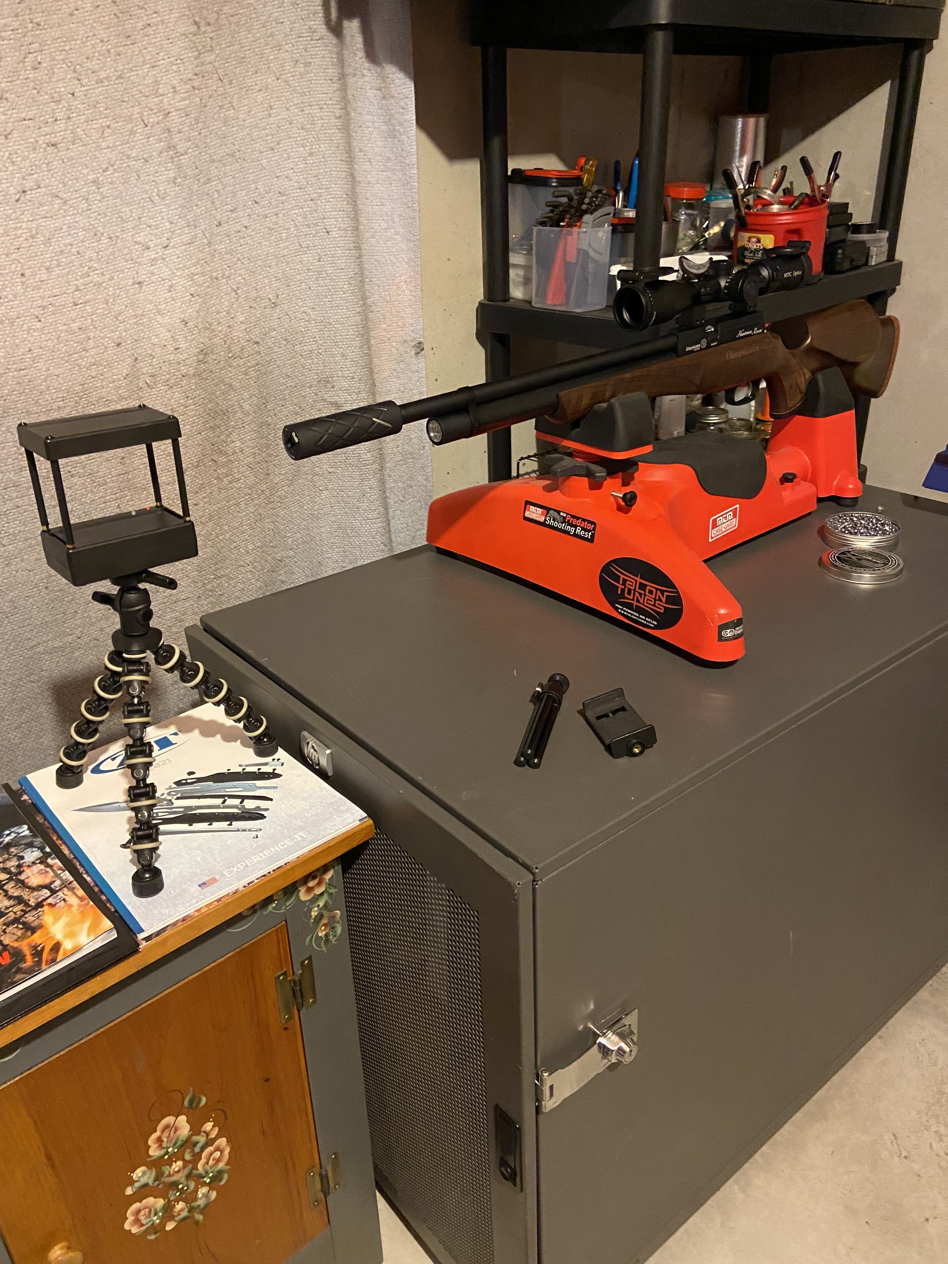

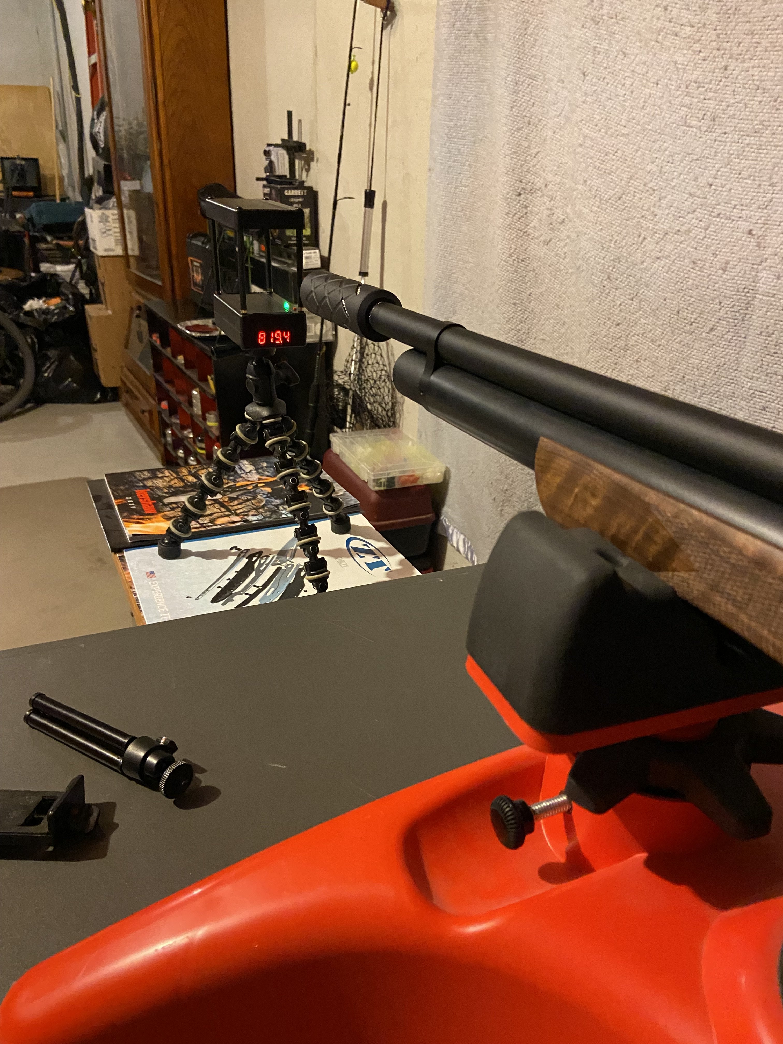

Nothing wrong with using your Caldwell. I used to use a similar conventional chronograph too but I shot it one too many times trying to get a reading indoors without lights. I replaced it with a $20 chinese chronograph and it works better than my conventional ever did. It has a rechargeable battery and gives me a reading every time. I have a clamp on and a tripod mount. I prefer the latter, it does not shift zero, the clamp on sometimes does. But my point is just that the little inexpensive Chinese chronys work so well you might want to pick one up just to avoid the setup of your Caldwell. I put the data into a spreadsheet where I can easily make a graph out of the data if I want to.
