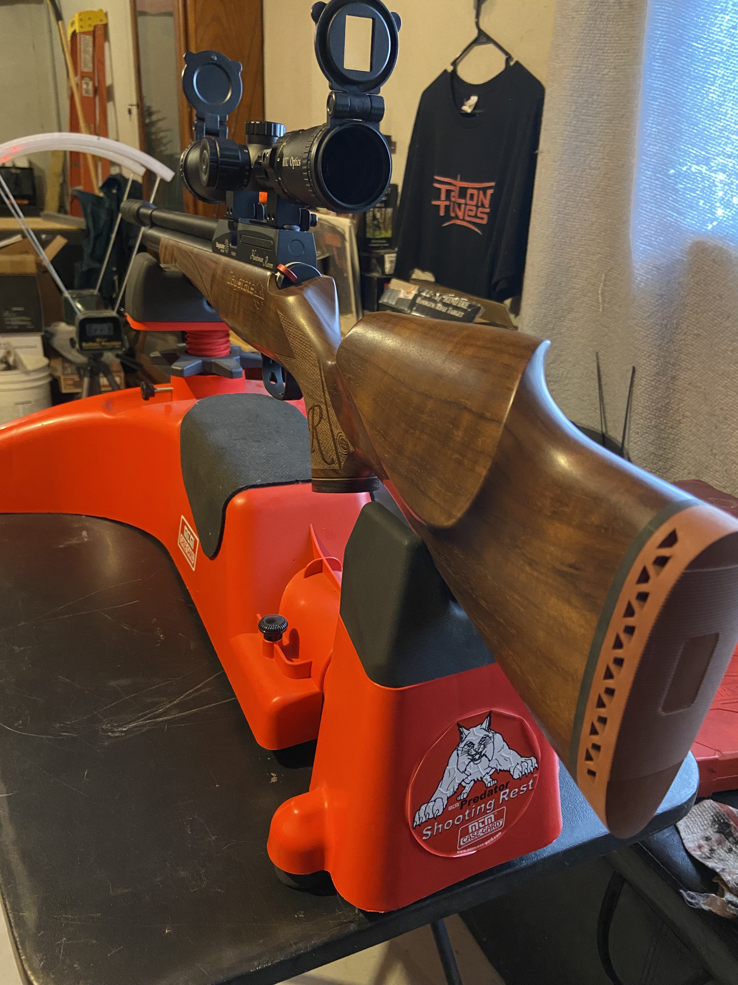

The Calwell pro works every time, so that's what I generally use at this time. It give me high fps. Low fps. Average fps. and standard deviation, that's all I need, so don't need all the other stuff.
