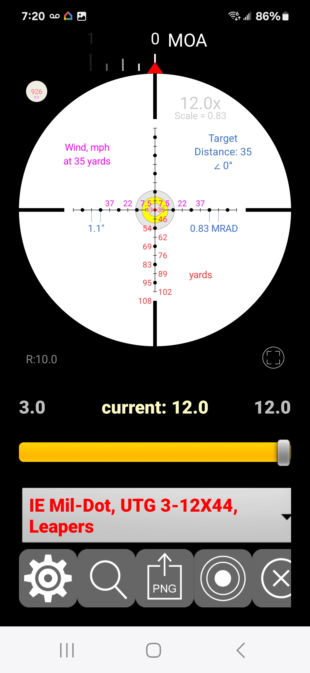

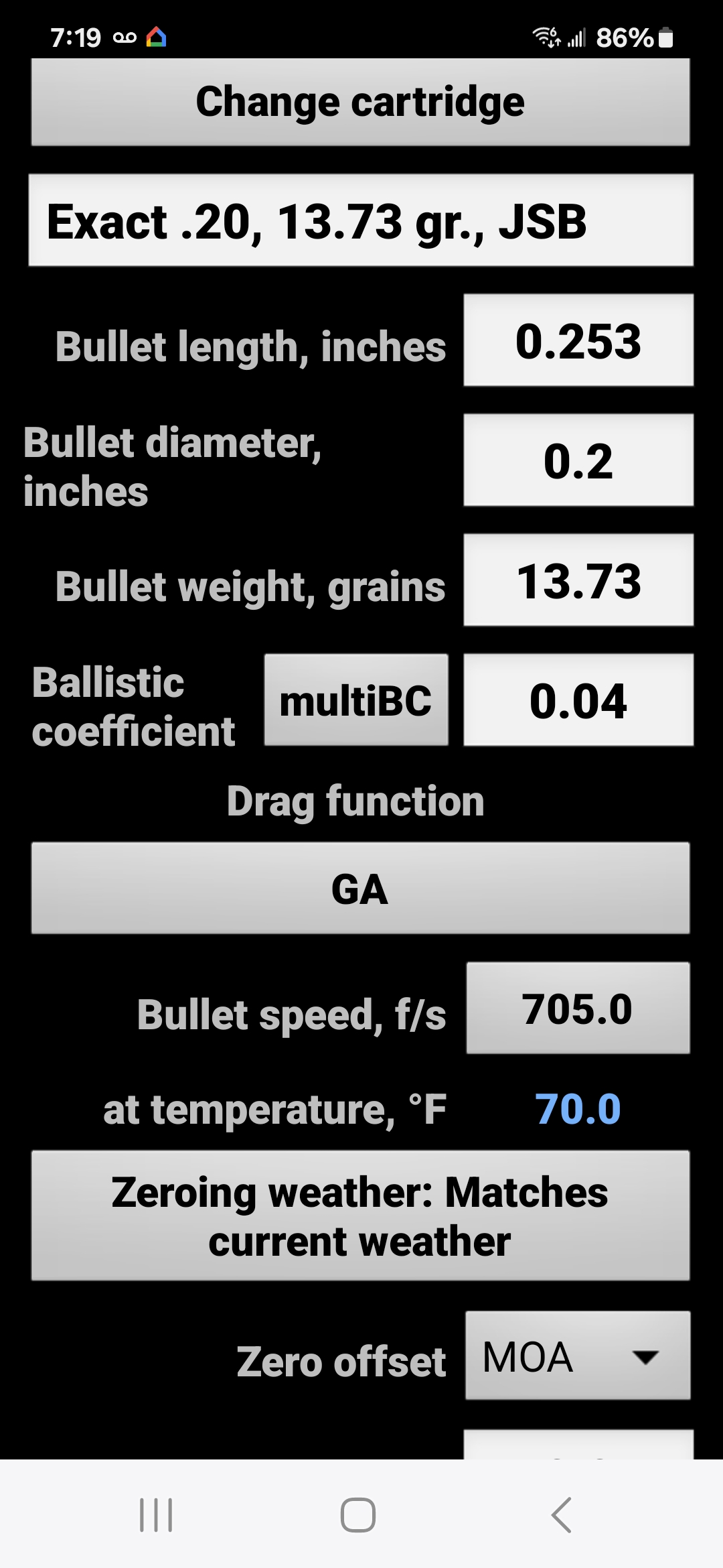

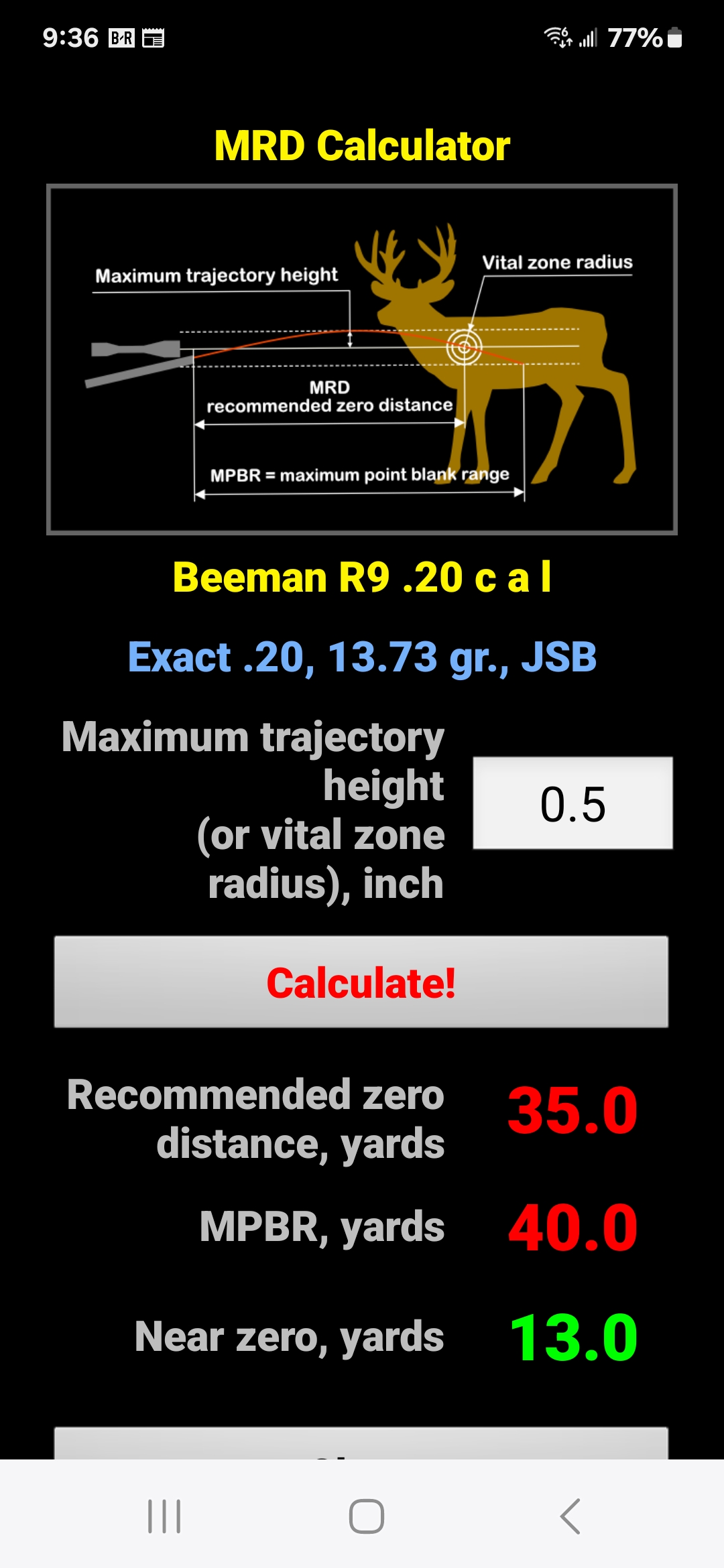

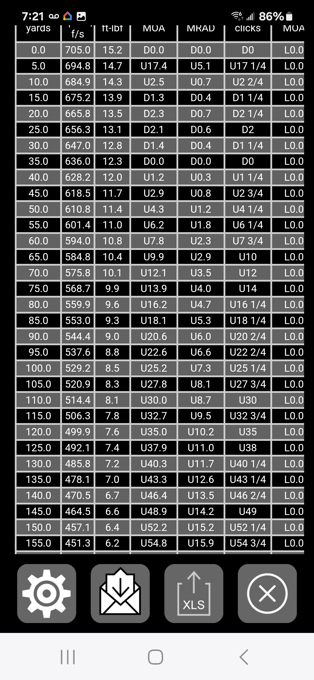

My vote go to .20 cal. Pellets easy to handle flat compared to .22. They all will work. It's the shooter and gun.
