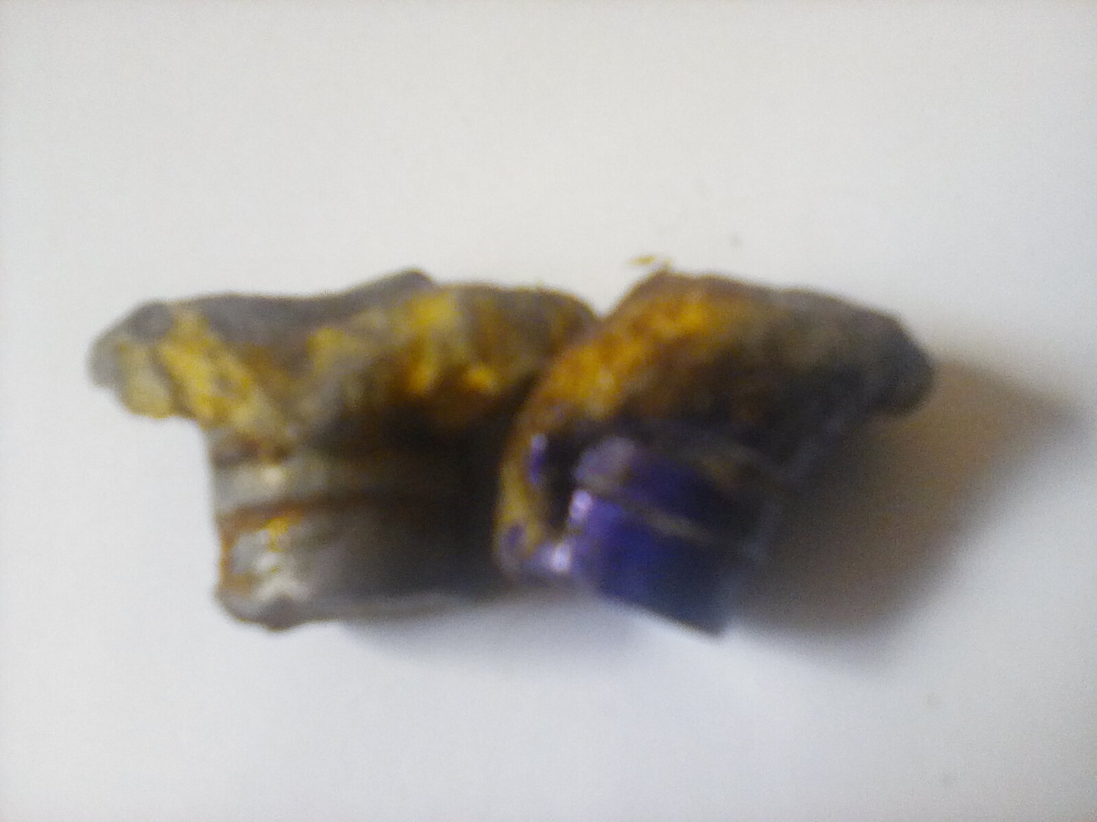

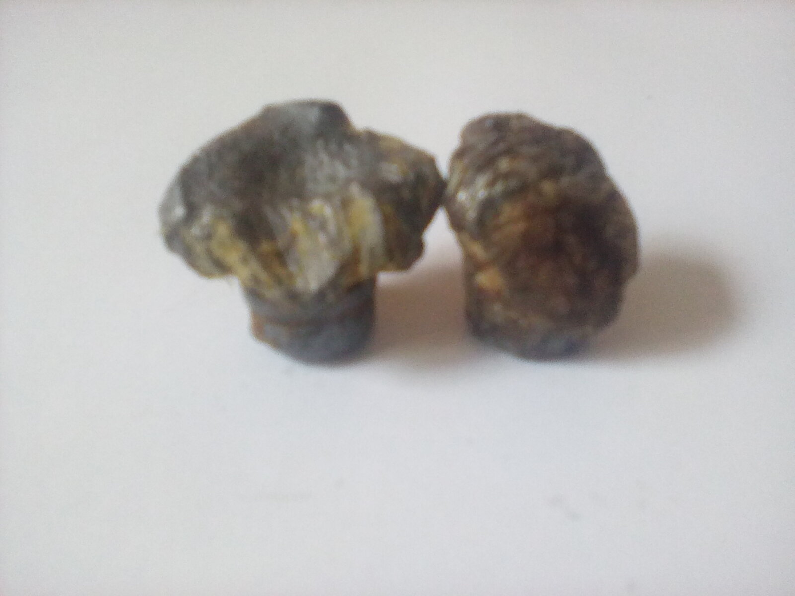

Two .510 slugs recovered from game at modest ranges...Can you tell which one is a.hollow point? One slug is a solid with powder coating..Really at 1000 fps and under their big ridiculous slow bounce around and do whatever they want. Powder coating had no.effect on expansion... The purple slug is a solid and powder coated baked in oven..Both slugs 800fps...
