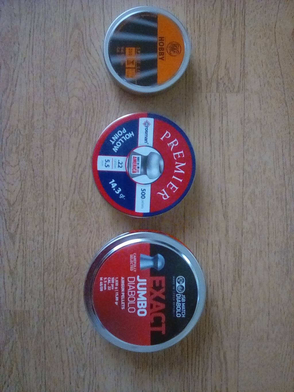

I've had excellent results with these but of course every rifle has its own personality. I would definitely give the Crosmans a try since they are the cheapest.
