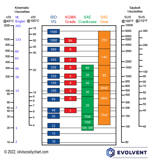

SAE 50 is a motor oil viscosity grade, but SAE 90 is a gear oil, which uses a different viscosity measure. SAE 30 motor oil and SAE 90 gear oil are of similar viscosity.
This might be useful to someone. SAE is the popular viscosity scale for vehicle applications, although we usually measured oil viscosity in Saybolt and then converted, if required.
Do you know what the RC people are conveying with these numbers?
I am certain that you already know these viscosity facts, but most people seem not to understand the implications.
Reactions: Pbru212
