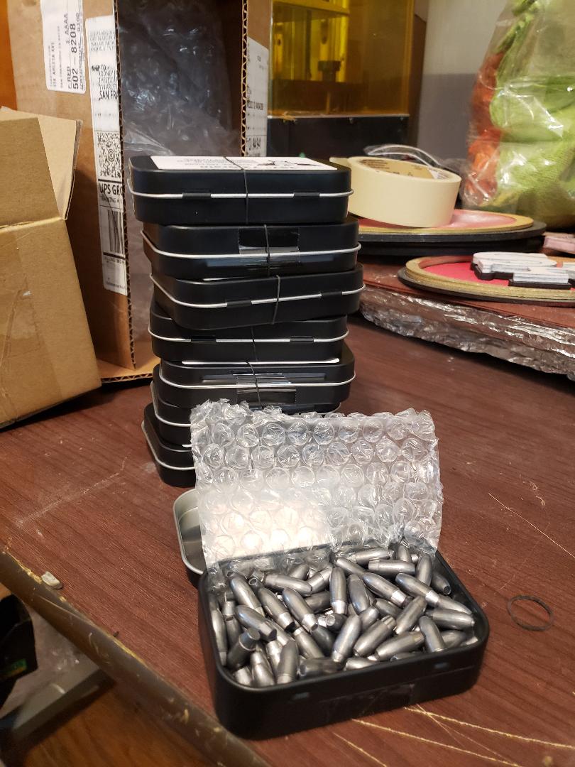

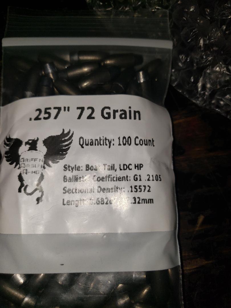

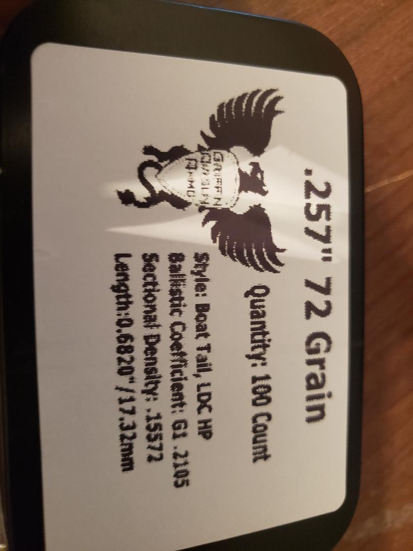

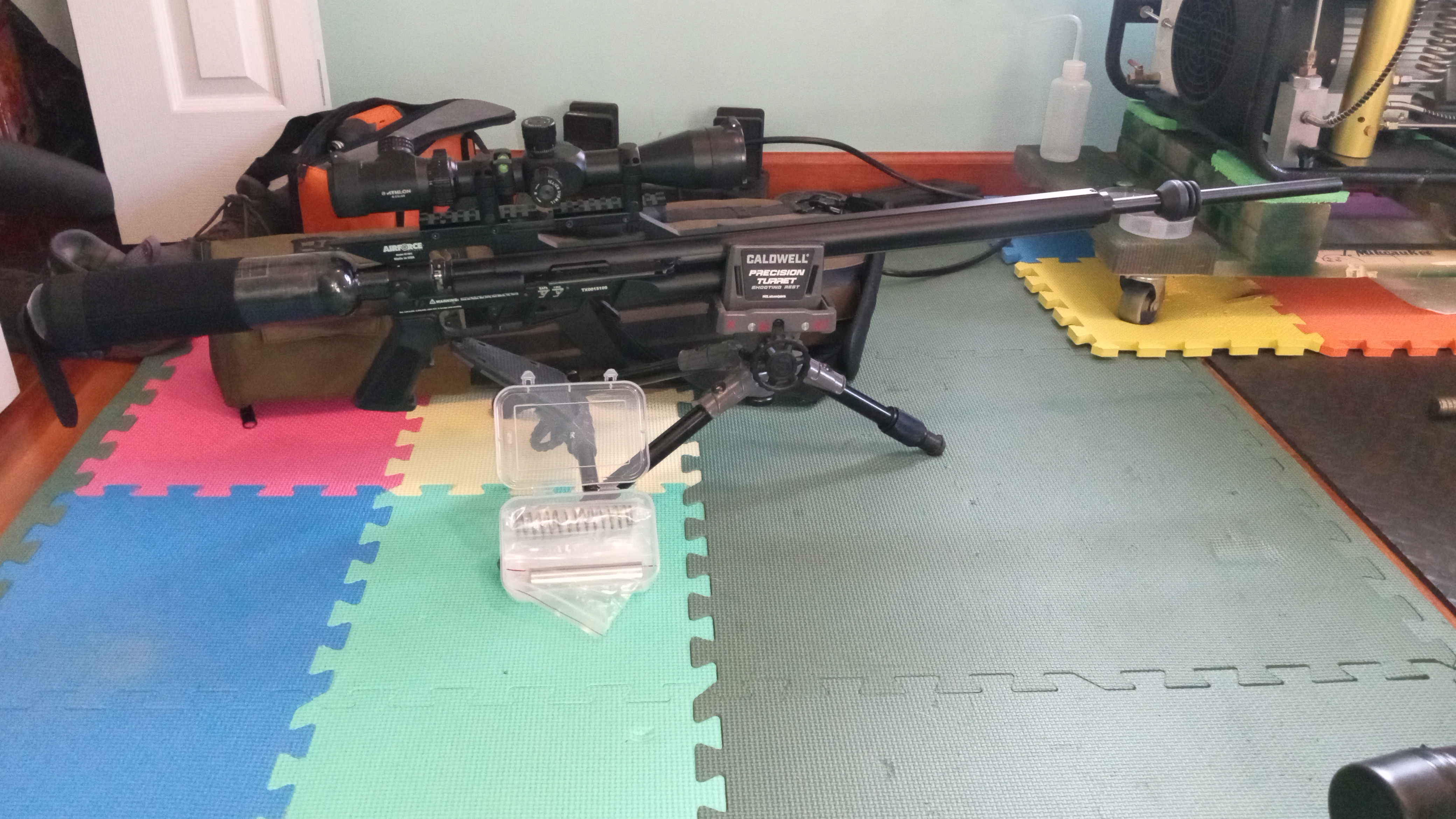

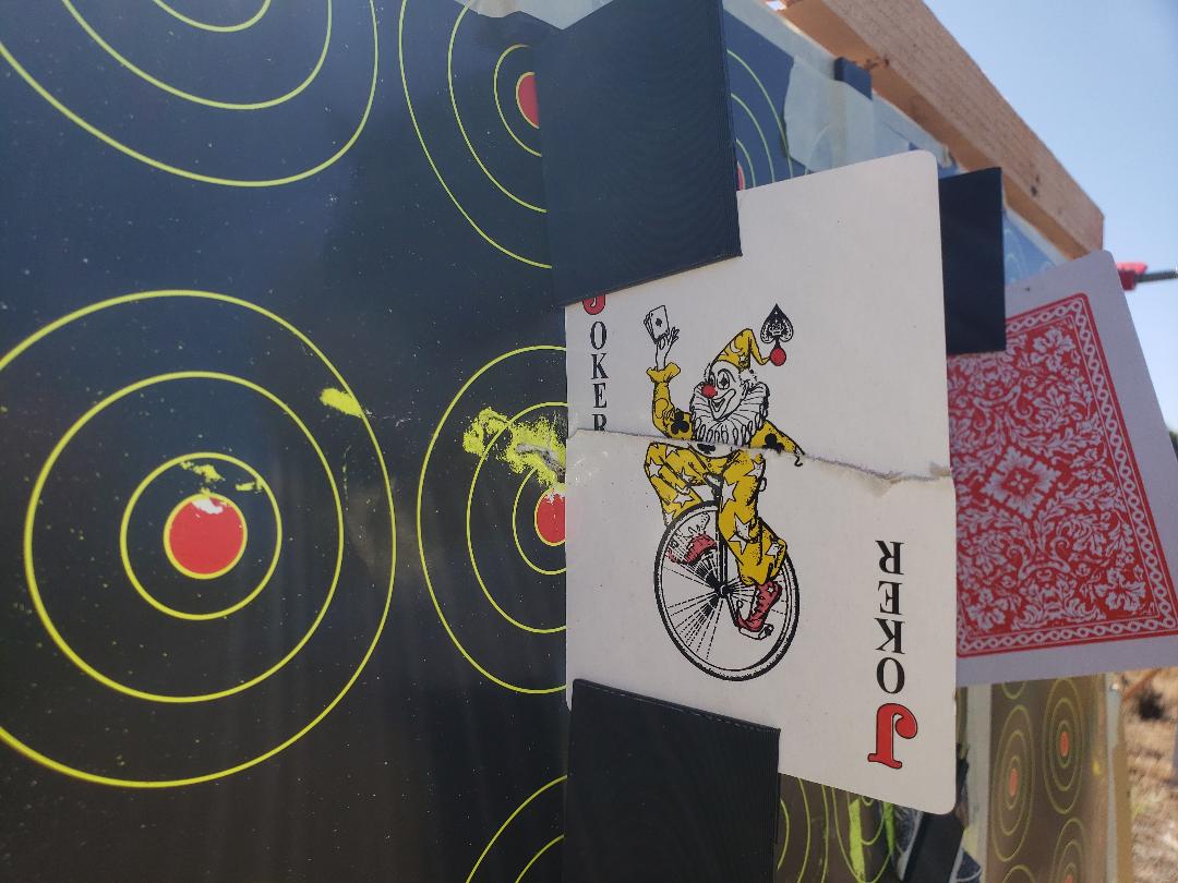

My order of 800 slugs from Griffin arrived today.
No other weight or brand of slugs allowed me to consistently split playing cards at 200 yards with my Texan .257 LSS
Note: Griffin is now shipping their slugs in a metal tin instead of a plastic bag.
View attachment 358851View attachment 358852View attachment 358854
I would love to see 200
Are you sure about 200 yards and not feet,lol . I think shooter 1721 would have his work cut out to pull that off 😂.
