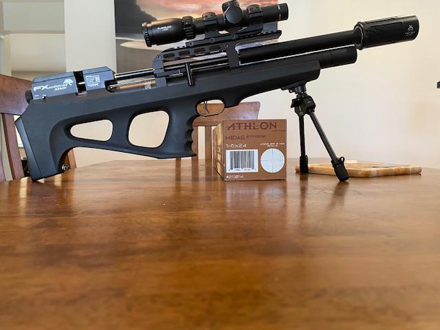

The fx maverick compact is not super popular anymore and might be had at a deal used. It can shoot all those well from first had experience.

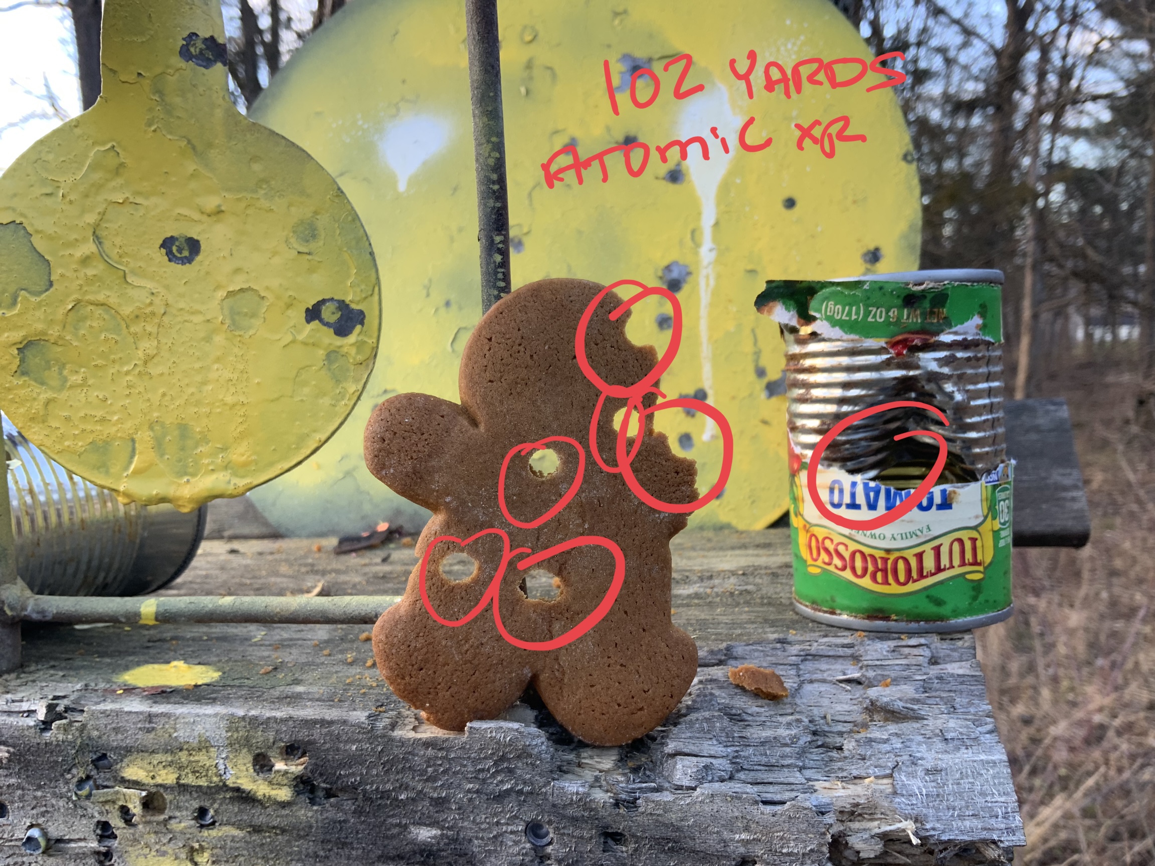

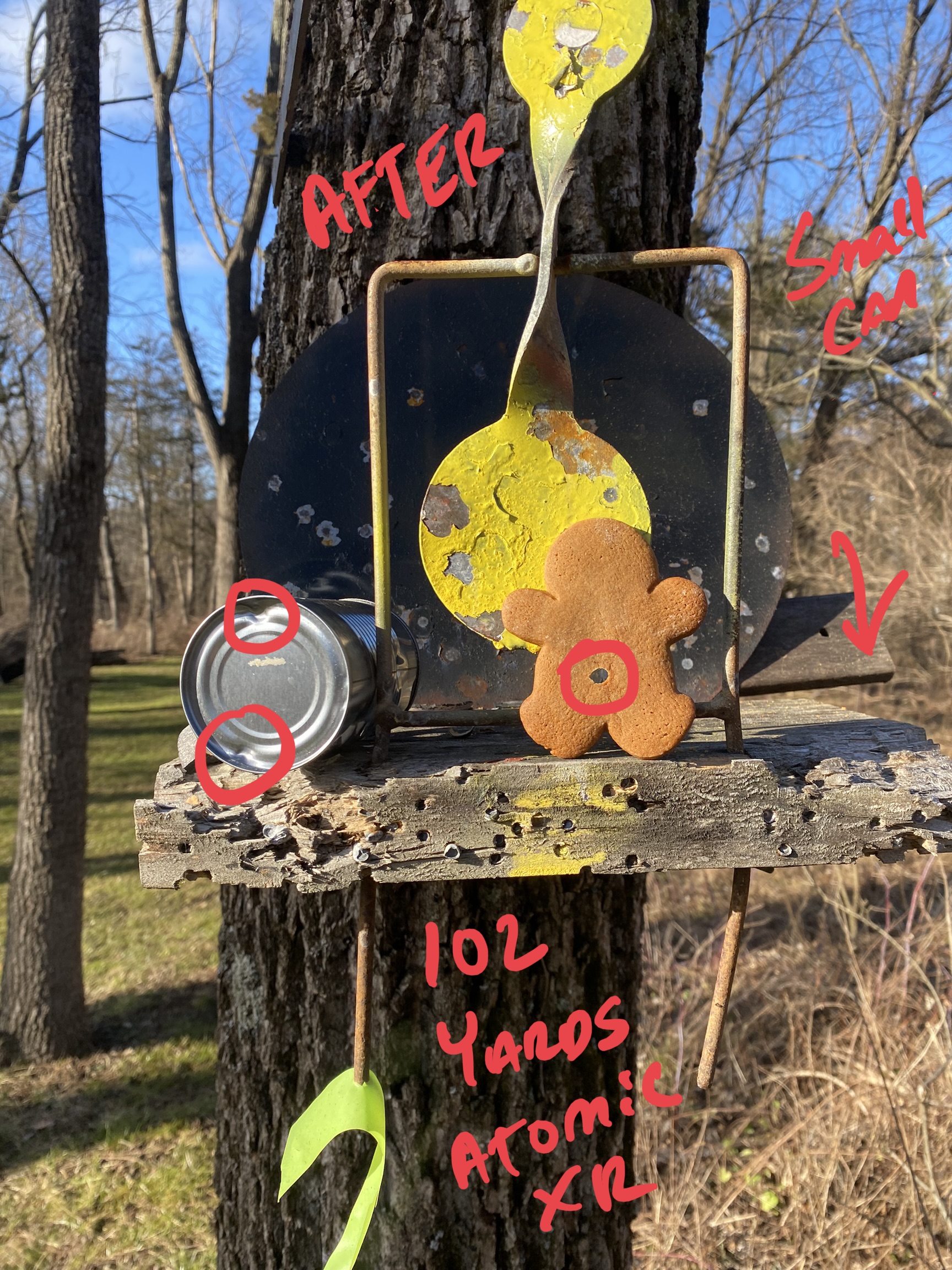

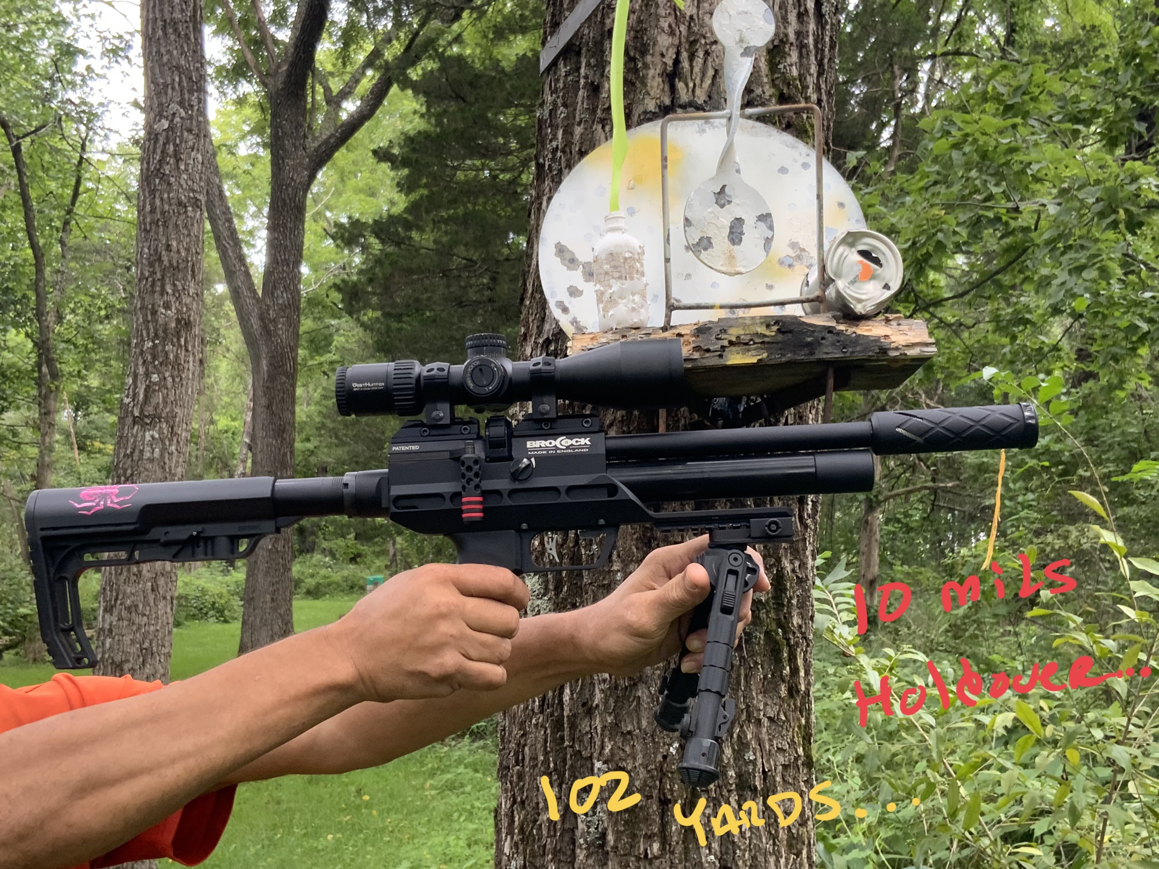

All my BRKs are great plinkers with the CPHPs both the American and Spanish versions. I plink out to 102 yards with my Atomic (17 fpe), and lPathfinder. It’s my go to pellet for plinking fun. I save my JSBs for my Ghost for pests. An example of the foolishness…
