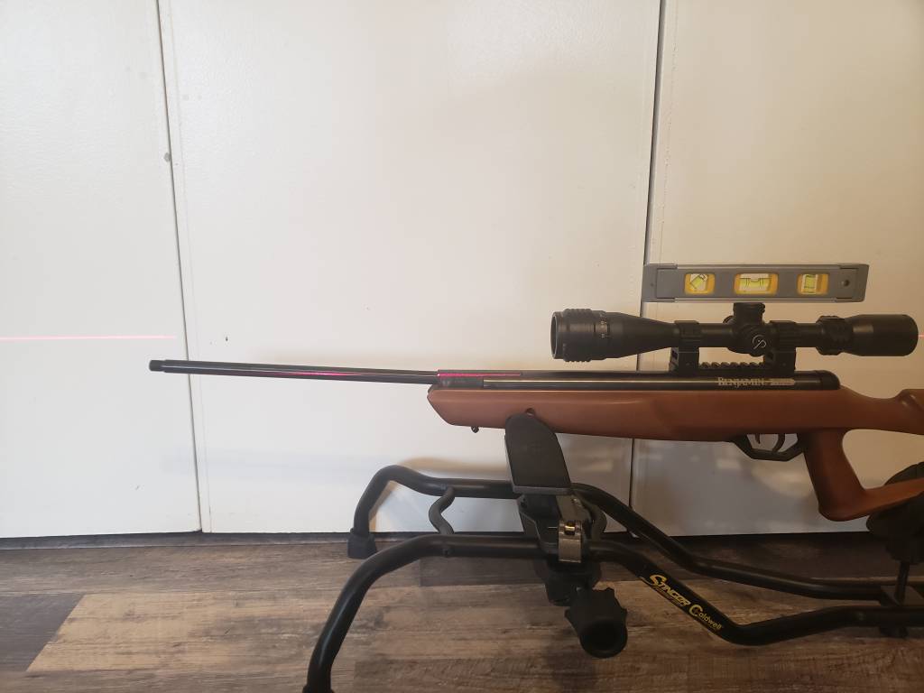

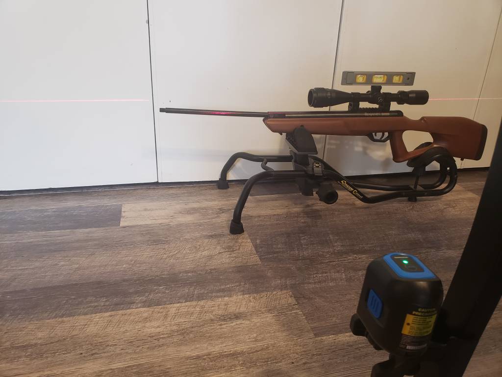

I got this used a while back never shot it put it in a case, recently I wanted to set it up to use occasionally and lend out when needed, took it out and ran out of adjustment so put another scope on it and I can see the shroud through the scope so swapped it with another one same thing finally realized the barrel didn't look straight. Can it be replaced/fixed or is it toast, any info would be greatly appreciated.

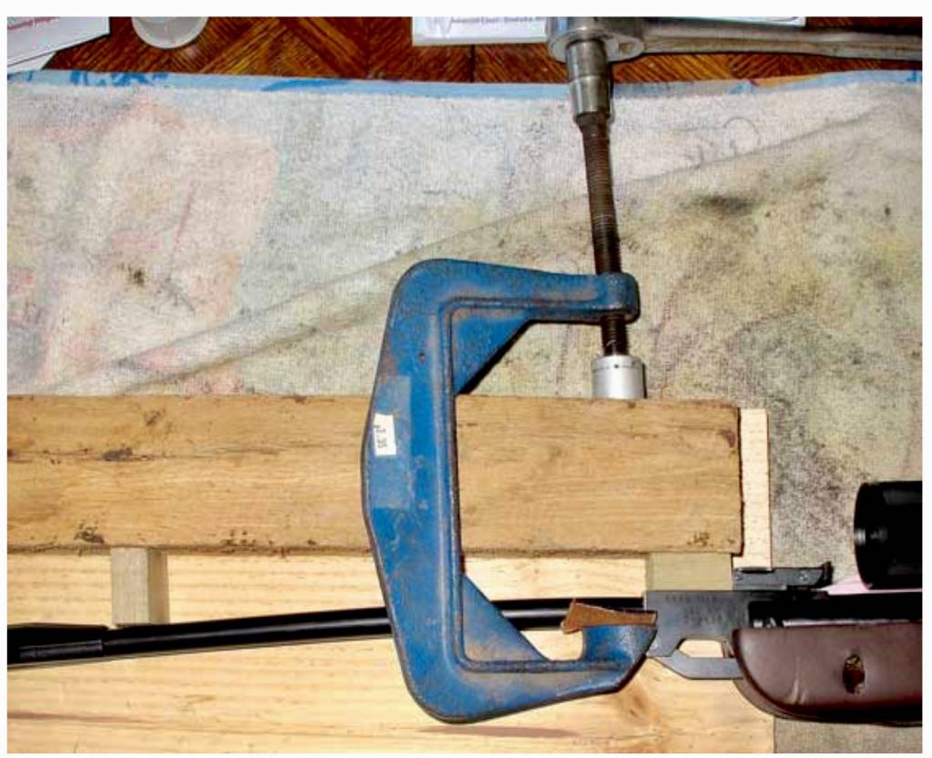

Yes, the barrel can be straightened - the good part is that the barrel will naturally want to return to it's original shape (keep telling yourself this because it's a confidence builder). if the barrel is solid and fixed to the block, one method requires a firm surface such as a very rigid bench, truck bumper or whatever is available to mount the block at waist level. To start, you need reasonably good eyesight so that you can look down the barrel to observe a shadow in the bore. Your barrel looks like a very deep bend so you may not be able to see completely through it in it's present condition - when you start bending the shadow cast by the bend of the barrel will be reduced; and the objective is to make it disappear with a nice shiny, appearance throughout the circumference of the bore. Remove the barrel with it's block and tape the block to prevent marring then clamp the block with protective wood pieces to you surface making sure you can see through the barrel to check progress - the barrel should be free floated and a light may be necessary to properly view the bore. Good luck😀!
