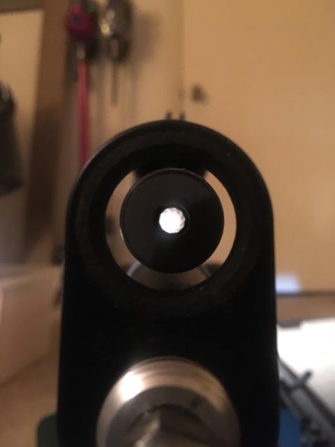

I think Biohazardman's info on the groove differences is still valid as I have seen that same info posted on the forums. I have a newer Gen 2 Mrod .22 with the standard Crosman barrel that has 10 grooves. Below is a pic of my barrel showing the ten grooves, it is a little fuzzy but if you look close and have a reasonable imagination you can probably see the ten grooves! I saw a similar photo about a year ago over on Gateway of a newer LW Mrod barrel that showed 12 grooves so that is why I believe this 10 vs 12 info is still probably valid.

If you do end up checking the grooves, just make sure your gun is unloaded and uncocked, unscrew the shroud and pull it off, open the bolt and stick a white piece of paper in the open breech, shine a light on the white paper to reflect the light down the barrel to the muzzle, then....take your cell phone and move the camera lens in front of your barrel and take some photos until you get a good clear picture that will allow you to count the grooves. Phew!

I just checked a bore scope picture of my SAMs 22 barrel and it does have 10 lands. A 22 LW barrel, machined from a 14mm blank, has 12 lands.
