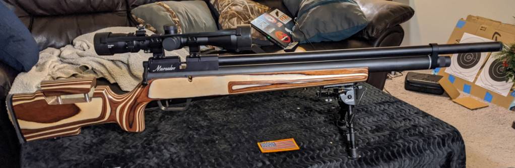

I have a new Marauder and am interested in what others are doing to their rifles for modifications/adjustments. As of now, I am shooting everything stock and am happy. I see lots of information about HDD (Hammer De-Bouncing Devices) and Compensators. I'm totally happy with the sound of my gun. If I can do a simple HDD mod to get more shots and be more consistent, then I will definitely do it. My initial research has shown me that the TSS is the current "norm" for stopping the hammer bounce. Anyone have any info to add? How about a regulator?

I put in an altaros regulator , then a heavy hammer spring in my 177. It's throwing out some heat, consistently. I also got one of those Boyd stocks. That's my mods. I have used Hill Airgun hammer with peek. It's good
