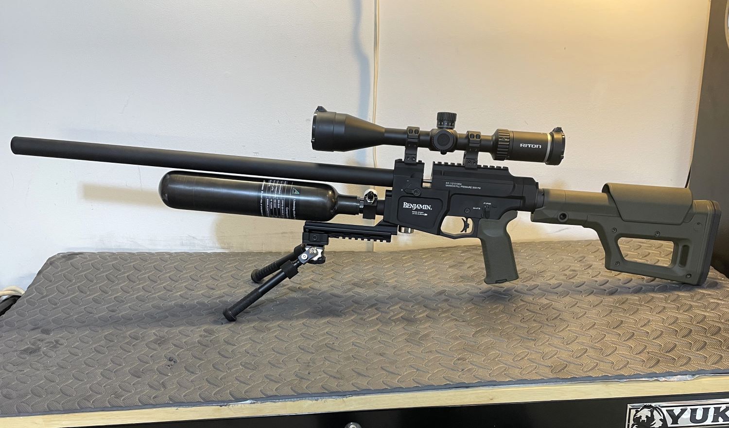

A while back I wondered if a larger CF tank would fit on the Gunnar, so I got one and it fits just fine on this .25. Used the Alsafe 580cc..
As well, this is a 1/2" rifle at 52 yards with 25.39 JSB's benched.
Getting 48 fpe with a very slight tweak on the regulator.
Either way, for folks who have the rifle, a larger cf bottle with M18 1.5 threads is a good fit and lightens the rifle up some.

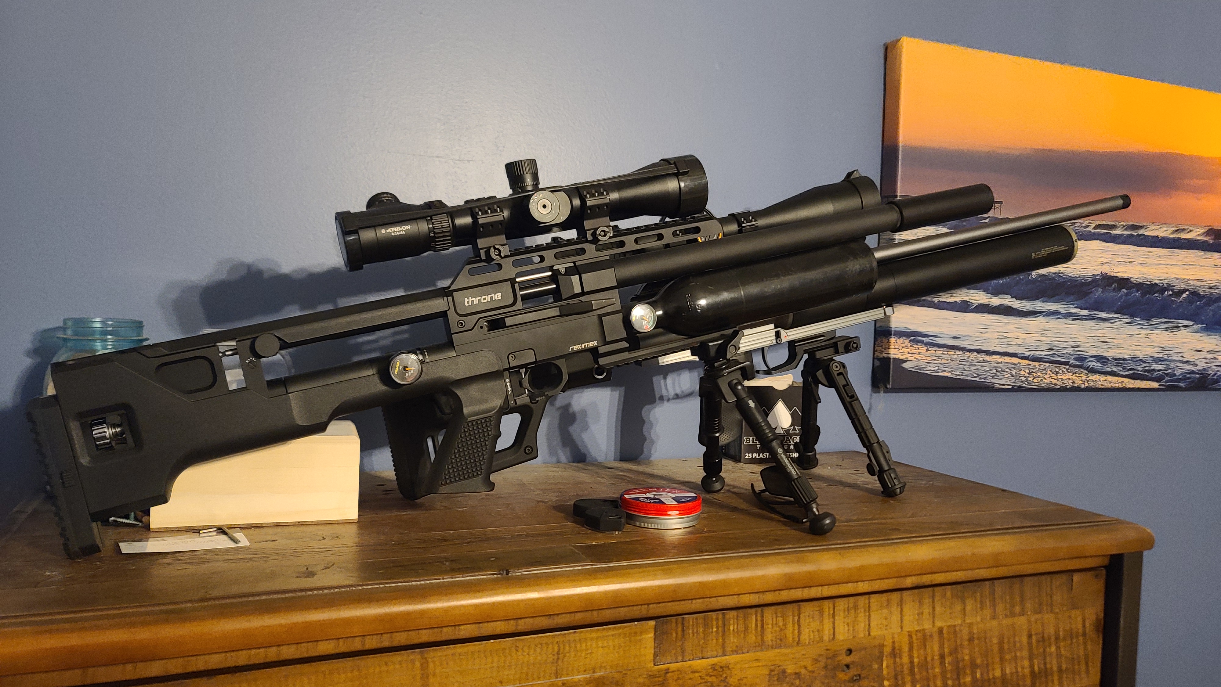

Yep, pretty much a throne
