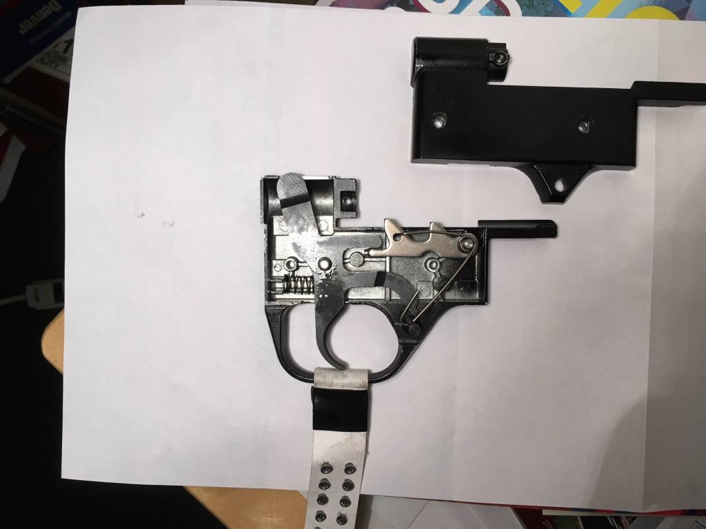

Here's a photo of our 397PA trigger assembly.
I was just going to post a question about how to lighten our trigger when this came in...
I don't find ours to be long. I just find it to be hard. Heavy.

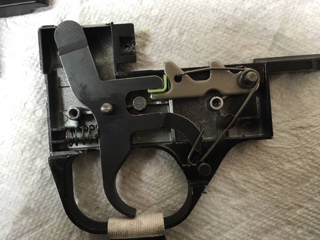

Then, my wild, crazy idea that I came up with during all this was to take some plastic tubing, and slide it onto the front part of the sear, where it contacts the trigger itself. That, by itself, takes up some of that creep in the trigger. Be careful not to push it all the way to the back, or it may bind on the trigger assembly housing. The first time I did it, I ran into that.
Then I tried putting a washer between the trigger and the sear in that same location. That worked fine, except the washer would slide back sometimes and it locked up the trigger, until I pointed the rifle down and jiggled it, and it slid back forward again. I suppose you could superglue a washer to the trigger to take up the slack and it would do the same thing.
I also bent my sear spring just a little bit.
Then I gave my tubing idea another try, but this time I did not push it all the way back, and it works fine. I don't know how long it's going to last, but we will just have to wait and see about that.
Now, I have pretty much no creep whatsoever in my trigger. Just a nice, crisp pull. It's not light, but it's not unpleasant now, like it used to be.

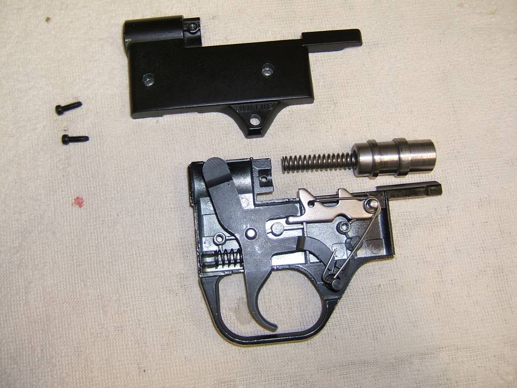

Here is what I believe to be the best YouTube video on how to take these rifles apart:
https://www.youtube.com/watch?v=M3xlS4f89QU
It doesn't cover opening up the trigger assembly housing; but that's small fry.
The only tricky part about the whole operation, as far as I am concerned, is that when you reassemble it, when you insert the striker into the tube and reattach the trigger assembly to the rest of the gun, you need to make sure you have the bolt in the raised position, like you are going to cock it. Or you won't be able to cock it. Apart from that, it's a piece of cake.

Below is a picture with the tubing on it. You may have to zoom in on it to see it, as the tubing is clear.

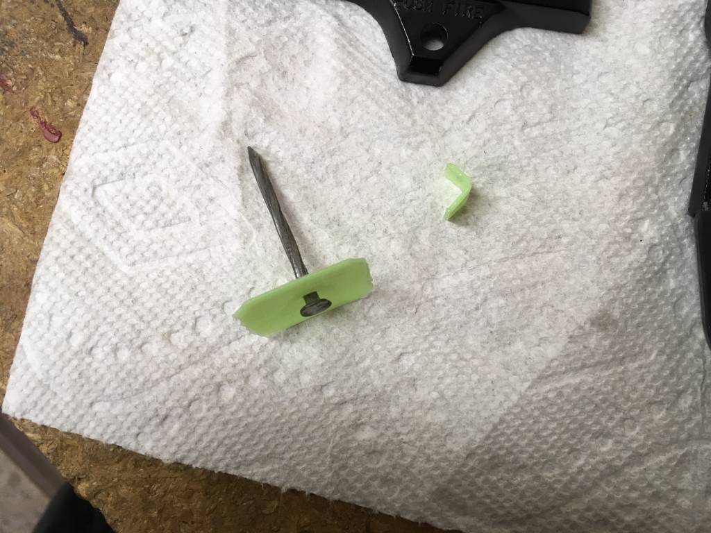

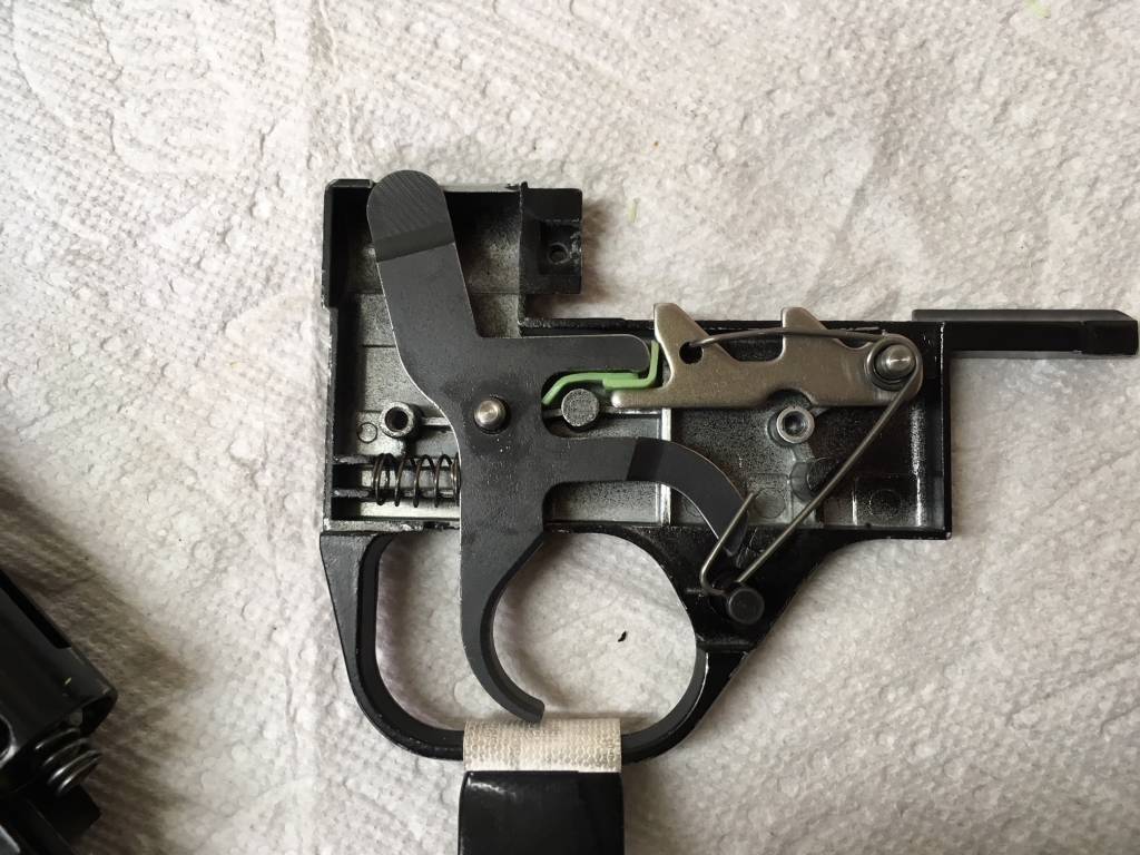

I looked around and found some plastic squares with nails through them. See below. The plastic looks much tougher, so I went with it.
The first try helped, but didn't take enough of the creep out, so I added more plastic from the other direction. Now it works great.
Obviously, metal would work vastly better, but I'm working on a 0 budget, so we do what we can. I can look around for some metal later.
In any case, the concept is sound. Put something that doesn't bind in between the trigger and the sear in a way that they won't dislodge or shift in an unwanted position.
Again, make sure you give it the ol' mallet test, just for safety's sake.
I haven't had time to test it, and it's time for bed, but it's light and has zero creep, so something along these lines seems worth looking into.
