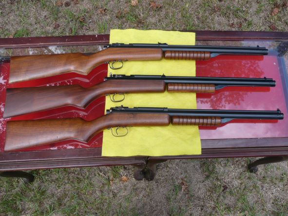

I started looking for a complete set of the Tootsie Roll- Model 310 smoothbore-312 .22 caliber and a 317 .177 caliber Benjamin Air Rifles in the middle 80s, took a couple years to get them all rounded up. I really like their Classic look with the Tootsie Roll Walnut wood pump lever and stocks!! I rebuilt and refurbished all three, including replacing the rubber bumper in the pump arm, this really cuts down on the clack–clack noise when pumping!! . The 310 is a 1958, the 317 a 1963 (according to serial numbers) and the 312 had no serial number with a straight bolt handle screwdriver slotted, rather than curved, and from my limited research indicated about 1952-1956? It’s certainly pre 1957!!Serial numbers did not appear until 1957.

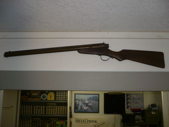

I also have the remnants of a Benjamin model G/200 Single shot muzzle loading BB Rifle 1929-1930, missing the front pump assembly and the trigger assembly, it hangs over my machine shop entrance door, will include a photo.

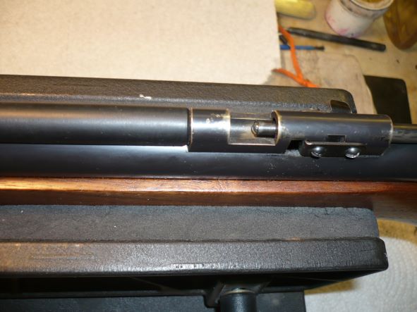

The bolt on the M-310 is hollow, allowing a BB, lead or steel, to be inserted or a .177 pellet can be loaded, but care must be taken. The rear sight on this unit is a leaf type adjustable for wind age and elevation. Trigger pull measured at 3.5 lbs. An interesting side note; on some very early Benjamin Rifles literature; a “Hair Trigger” was emphasized!! Would not go over to well in today’s time!! Dylan was right “The Times they are a changing!”

I could not be more pleased with my collection of Classic Tootsie Roll Benjamin’s; compact lightweight, accurate and powerful ; I mean really what’s not to like!! This is the stuff dreams were made of for teenage boys in the 50s & 60s!!!!
