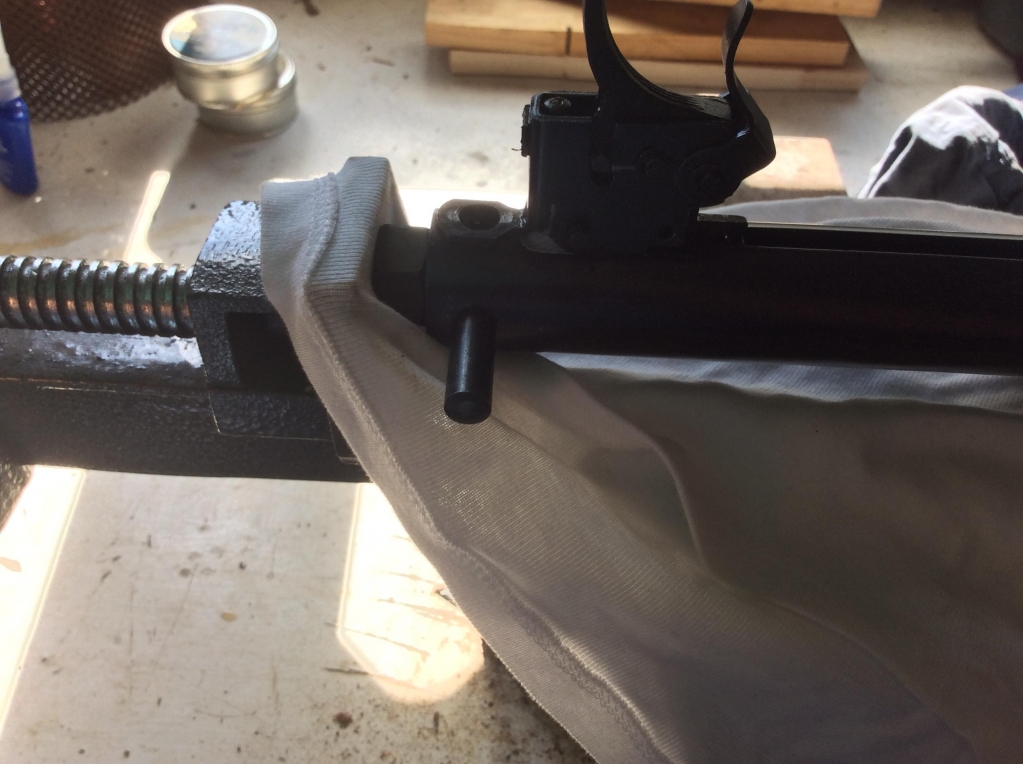

Hey guys I am trying to figure out why my dads Benjamin titan is so inaccurate. I tried several holds including just shooting off a bag. although I am not the best at artillery hold i dont think my groups should be this bad. Im getting 7in groups at 20 yards. I tightened all screws before testing and the scope rings have a scope stop pin engaged. The scope visually seems fine and apears to have not moved. I am wondering if I might have a blown seal on my hands. The numbers seem a bit anemic but I dont shoot springers much. Maybe you guys can tell me if these numbers look bad. I was shooting crosman premiers 14.3g. 559,625,634,645,567,631,632,628,578,623,630,587,636,628,613,626,619,601,605, 567,605,591,598,598,578,609,602,611,597,608,587,584,610,611,590,608,560,592,585,581,597.
I dont like how sometimes its mid 500's and others mid 600's. I just dont know much about gas ram and springers. If you guys could tell me if this looks normal or not id be much obliged. Ty
