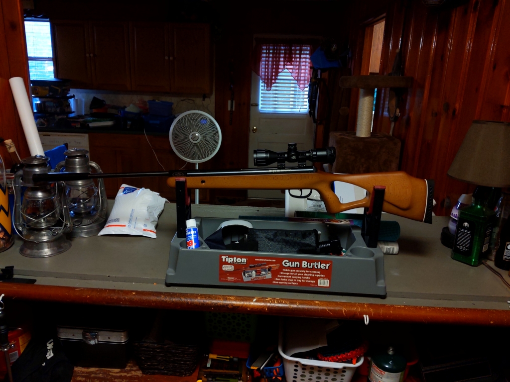

So here's what happened. Several years ago I picked up a cheap Beeman break barrel for 65$ at Walmart. Several pcps later and I ended up keeping only one pcp my xisico sentry, crazy right? But it's dead nuts...anyways... My break barrel was God awful to shoot, but accurate as hell. Recently my "backpacker Airmax pistol" developed a leak and I sold it on here... I used that money to get me another break barrel and on a chance chose the Benjamin Titan in .22.
Well so far (about 200 pellets in) I love it! O can't believe it was 99$!!!!! I so badly wanted to bite my tongue and drop the change for a HW or something but I'm glad I didn't. That being said I'm highly aware the HW and such are leagues above but wow what an impressive rifle at this range in today's world. My sentry is always perfect when it comes to accuracy however it needs pumped to a certain pressure and that's every 25 shots or less. The break barrel is such an awesome way to go carefree out into the woods or just into the yard and plink limitless or until you get tired of cocking. I truly love the pistol grip stocks and this gun seems that no matter how I hold it as long as I don't grip the front (we all know that) it shoots better than I can. Fantastic rifle, loves Crosman domed and gamo red fires. I'm a JSB snob but this budget rifle with budget ammo is mind blowing to me. It's new but it's currently shooting 15g gamos at 706 coming to about 17ftlbs and not one bit hold sensitive ?! That's a win! IDK how guns like this slip through the popularity cracks but I'm so impressed I made a post about it lol. I believe you get what you pay for and it won't last forever but I also believe you can get a few diamonds in the ruff and this fits the bill.
Scope:utg bugbuster (never had a single issue with any utg scope and their on all my rifles including my 308 and more.)

Hey thanks for sharing! And I've shot alot of air rifles but I just can't get over the premium feeling I get from such a cheap rifle. Well cheap here I guess lol. Cool videos too. Once it's all broken in I'll do some Chrono results and stuff but until then this thing loves gamo red fires surprisingly so that's good for me and bad for the sparrows!
