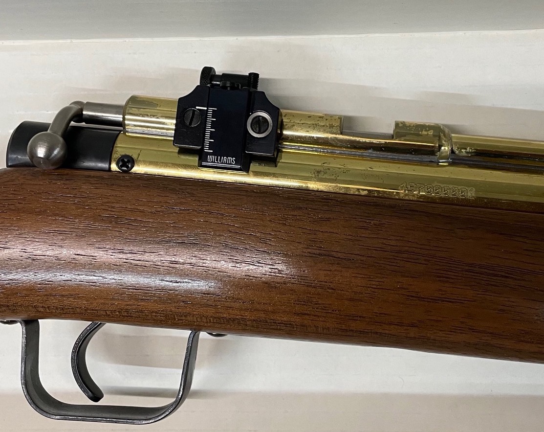

A question for the Benjamin Sheridan experts: A friend of mine recently purchased a 397PA with serial number 497000001. It's my understanding that in 1994 the 39x line began receiving 9-digit serial numbers, and that the first three digits represented the date of manufacture. My question is, was the date code written backwards like the older Sheridan Blue Streaks, meaning his gun is number 1 of the new 9-digit serial numbers and made in July of '94?
Interesting model. The last year of “Benjamin Sheridan” 392PA /397PA was 1996. The date on that one is April 1997. Does it say Benjamin Sheridan or Crosman on the front the warning label?

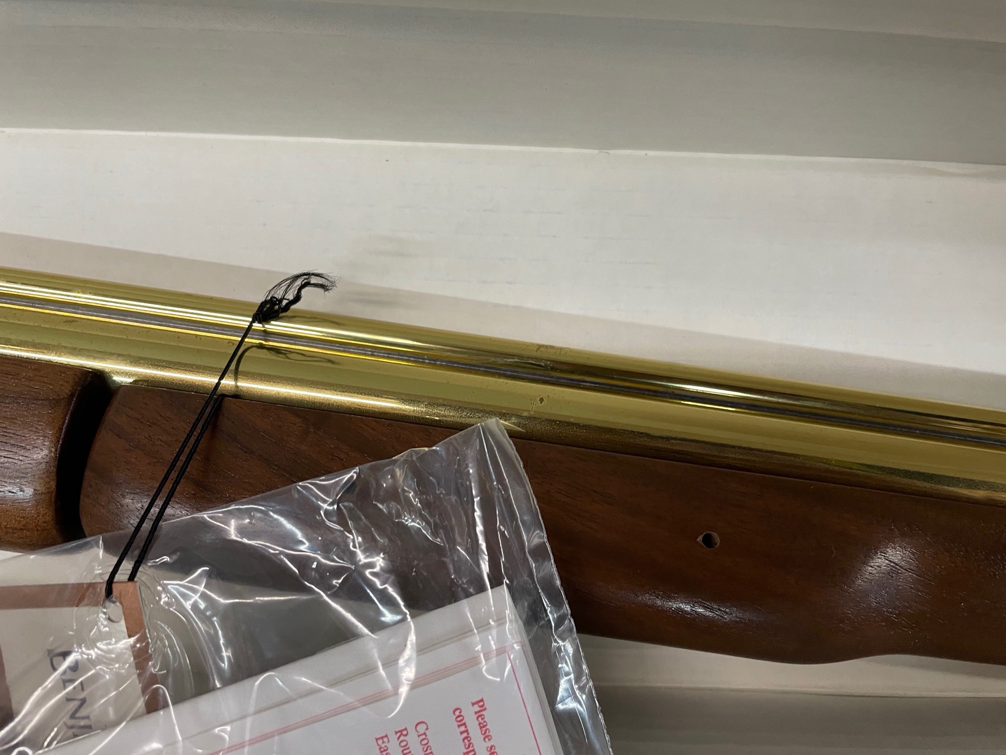

Unfortunately, I don't have photos of the entire gun, and it's still in transit to my friend's house. Muddying the waters even further, here's a photo of the box it came in, which has a completely different looking forearm. Obviously, the box says Benjamin Sheridan, but is the box original?
Reactions: .20calguy
The plot thickens: I just called Tyler Hull @ Connecticut Airguns, the seller of the gun to my friend. He's still in possession pending payment, so he took a look at it and confirmed it is stamped Benjamin Sheridan, and the address on the gun is Bloomfield NY.
Now, this is where things get strange. Tyler has two more from the same source, in the box and factory sealed. He cracked them open, and they are both 397PA guns, both have the same Centennial '87-style finish & Williams Diopter, and -- drumroll, please -- they both have the exact same serial number as the gun above: 497000001. The person whom he got them from said something about them being factory employee guns. Maybe Crosman assembled some guns from old parts to gift some of their employees.

Here are some facts about what should be expected on a 497 dated 397PA.
It should be stamped E. Bloomfield, NY - as stated above.
The .177 caliber production guns were available in black or nickel plated finishes only.
They still had the stamped steel triggers and guards.
They have the cartridge valves.
The grey and black box is correct for that year.
_More facts to consider_
There were no factory polished brass Sheridans till mid 1998 and the Benjamin 39XPA guns didn't get the longer stepped pump handle till the year 2000.
So, there are at least two characteristics of the gun that do not fit the norm. Because there seems to be three of these makes me wonder if they are indeed some sort of employee gifts or perhaps trial runs for the Sheridan PB models. Just used Benjamin tubes instead.
