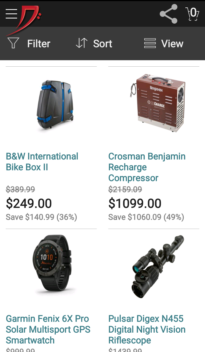

Is it THIS ONE?
Odoyle, Yes it's the recharge!! And Crosman sold them to the shooters at an even lower price than you show so that is why I wrote this article as I did, I guess we got what we paid for in a way but I just want to let others know that "IF" they buy one don't expect any parts to be available during or after the warranty is up!! Inside the case is little more than most of the cheap compressors for WAY more money in a fancy case. Crosman will replace the compressor at there expense while under warranty no problem but I just feel it's not a good business decision to not have parts available for a unit costing this much and it is costing them a bunch of money for needless shipping of units when many could be repaired by the owners. I'm sure many others have paid near retail for it, I sure hope they have better luck than we have!! Only saving grace is that most people wont refill 80 bottles a year and may get some years of service out of it HOPEFULLY J.L.
