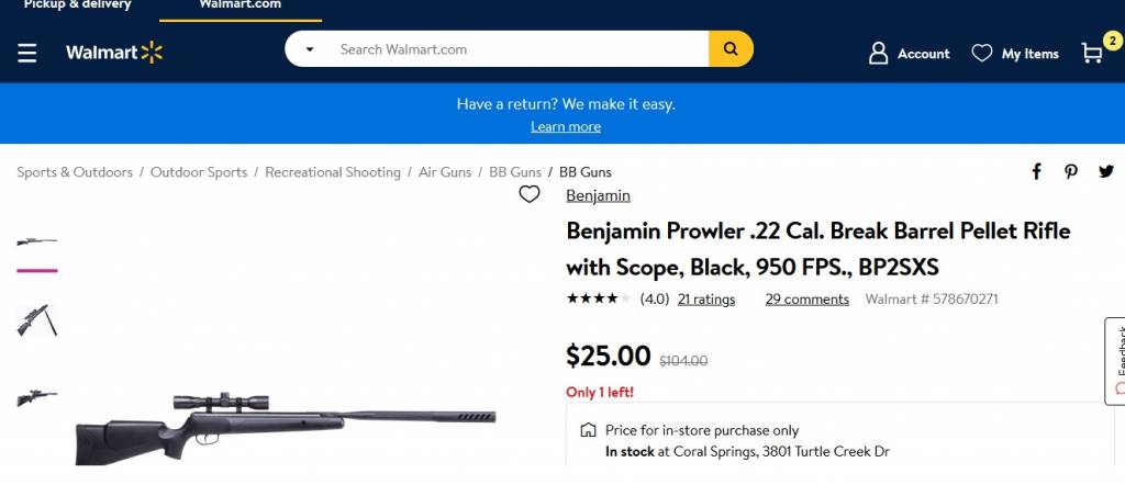

Just got 6 of these at Walmart for the kids Xmas presents for $25 each. Only 1 left now...
