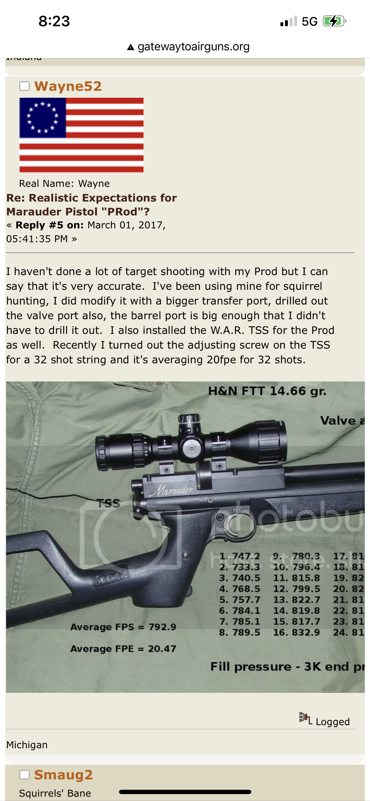

900 may be a pipe dream but I’m also hoping the attached I found on another forum would do the trick for me. Ie drilling out the TP and valve with a heavier spring set
I have nothing against Wayne. But if you’ve known him as long as I have you will notice everything he has is gold. His numbers and results with sub par guns are always stellar. Not calling it bs but it’s the internet. If you look hard enough, you will find something that backs up what you’re thinking. His gun and string are more realistic than 900fps. Now you just have to hope JSAR or someone has a TSS kit available.
