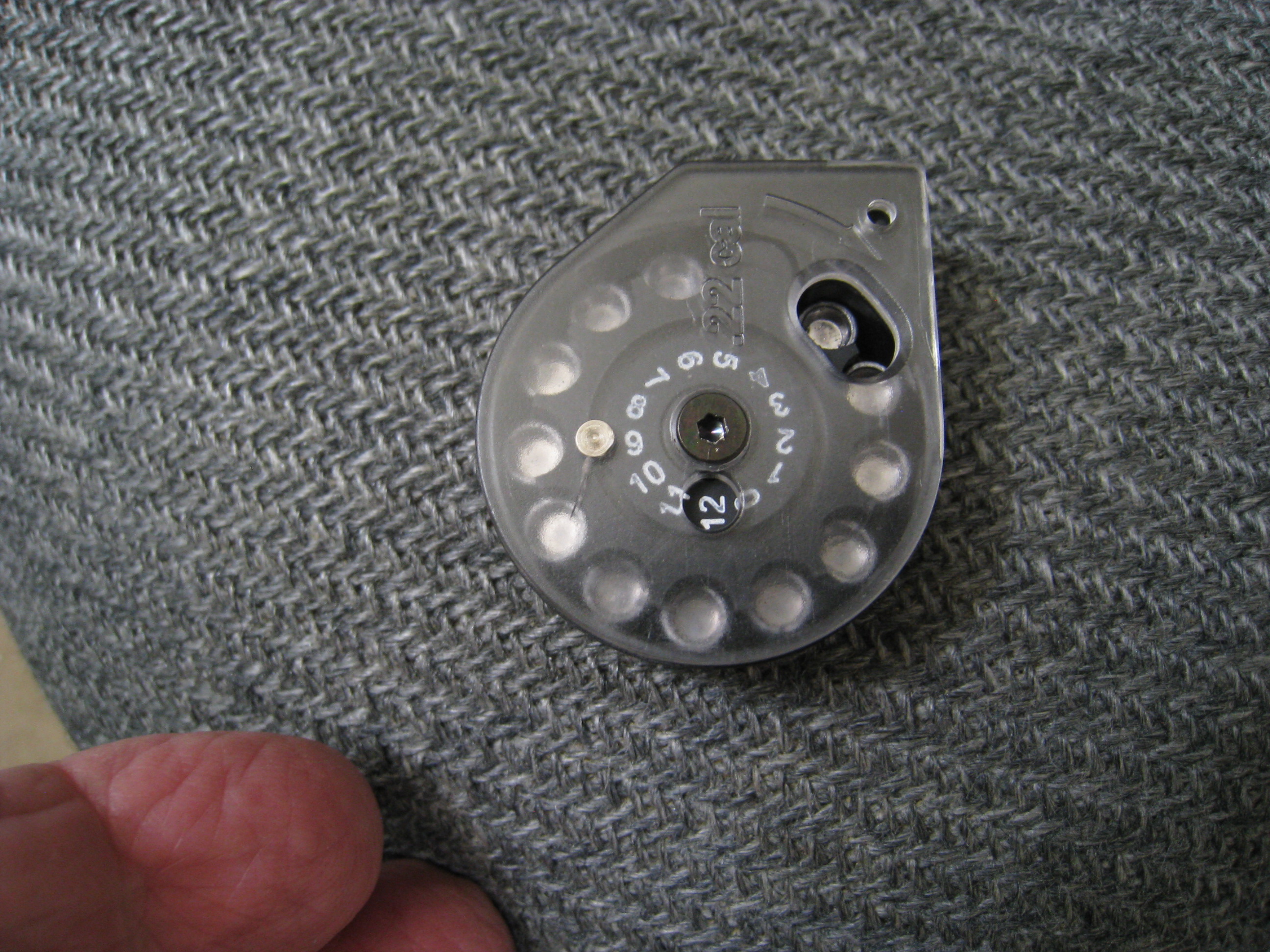

Finally tracked it to the Magzines tehy damage the skirt if the lever is hard to close
the Pellet is already damaged
One Magzine the brass pin fell out so i bought another it has a crack where the pin is
already noticed it when loading dont quite know how to approach that problem
just yet when I am shooting ihave to jiggle the Magzine to get it to feed easy
the Pellets I am using is Premier 14.3 Hollow Point around 720 FPS I am including a photo of the
crack in the Magzine
i have 6 mags, and there is a variation in mag thickness, if theyre hard to push in the opening it can cause binding and misalignment .. about the only solution to that if indeed it sounds familiar, is to disassemble the mag and sand on the black pieces a wee bit to bring it down a couple thou to a nice free slip fit ..

the crack in the mag looks like one of mine that I wound up the mag than slipped out of my fingers and slammed against the pin. My bad. But if your mag is hard to wind up you can take it apart and reduce the spring pressure on it. A lot of mags have to much spring and don’t tighten the center bolt to tight or the mag will bind.

That is the way it came with the Crack

I took some balistol and cleaned the openings were the pellets go in, wound the mag and all is good. hope this helps.
