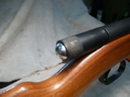

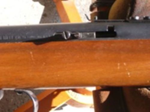

Charging the M-3030 required removal of a knurled screw on hollow cylinder housing at the rear of the rifle that housed the 8 gm CO2 cartridge, insert neck end first, when installed the large end rear of the CO2 cartridge protruded slightly from an opening at the rear of the housing, screwing in the housing tightened against the rear of the CO2 cartridge securing it. It is a bit odd looking having a portion of the CO2 cartridge exposed but puts the CO2 cartridge directly in line with the valve system / barrel and works well.
After installation of the CO2 cartridge one cocks and fires the rifle piercing the CO2 cartridge charging the rifle. The design of the hammer/barrel system is also a bit unorthodox, because the CO2 cartridge is at the rear in relationship to the valve system/barrel. Cocking the system is accomplished by pushing a bolt attached to the hammer forward as opposed to pulling back as one would normally do to cock the hammer, when the trigger is pulled the hammer/barrel flies rearward striking the valve stem discharging the rifle.
There is a second smaller bolt attached to the hammer just forward of the cocking bolt that acts as a safety, when cocking, this smaller bolt can be rotated up into a slot on the barrel tube, when in this position the rifle cannot not be fired, moving the safety bolt down out of the slot allows the rifle to be fired.
Loading the M-3030 rifle is accomplished thru a hole in the top of the barrel exposing the magazine tube, BBS are loaded one at a time thru this hole with the muzzle elevated (this is a gravity feed system) until 30 have been loaded, after each shot the muzzle should again be elevated to load the next BB. (note charge CO2 first then load BBs)

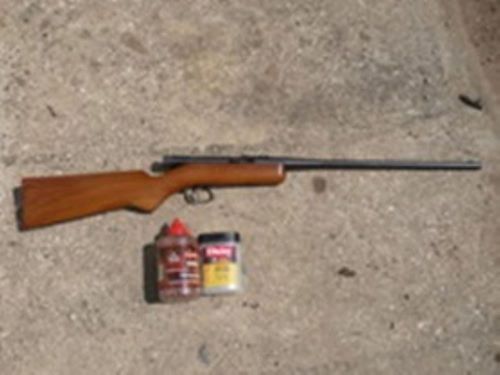

I picked up my Benjamin M- 3030 at a gun show in Fredericksburg, Texas in 1996 it was in really good shape but would not hold a charge, after a valve rebuild, I shot/plinked with this rifle often, really a joy to plink with. I had never really seriously set down and sighted it in at any particular range (minute of beer can angle was good) nor had I ever shot it over a chronograph. I decided it was time to do just that.
I set up two targets at 10 yards and as I normally do, I used ½ inch adhesive dots on card stock paper as aiming points, I had Daisy zinc plated and Crosman Copper plated BBs on hand and used these for the accuracy test. I might point out that the Daisy BBs looked to be superior in outward appearance, smooth finish, and measured a consistent .173-.175 in diameter, while the Crosman BBs were very rough looking, copper plating was flaking off and the diameter measured .169 -175 very inconsistent. All shots from bench rest!

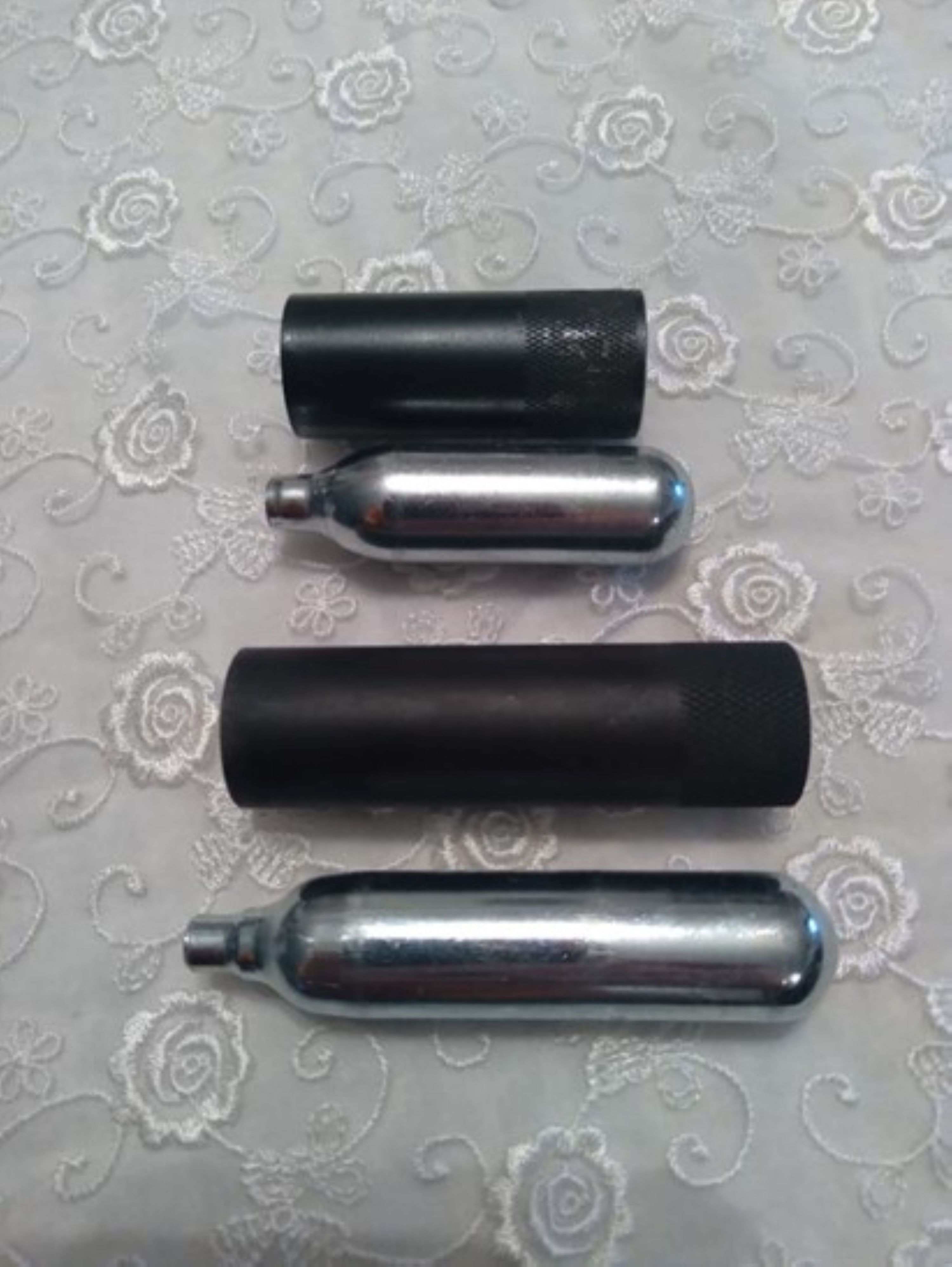

After putting this article together, a good while ago I saw an ad for an Adapter to allow the use of 12 gm. instead of the 8 gm. Co2 cartridges for this rifle, so I ordered one from (Baker Airguns.) I was interested to see how much an increase of another 4 grams in Co2 capacity would aff

It is clear the 12-gram cartridge is superior and what I use!
