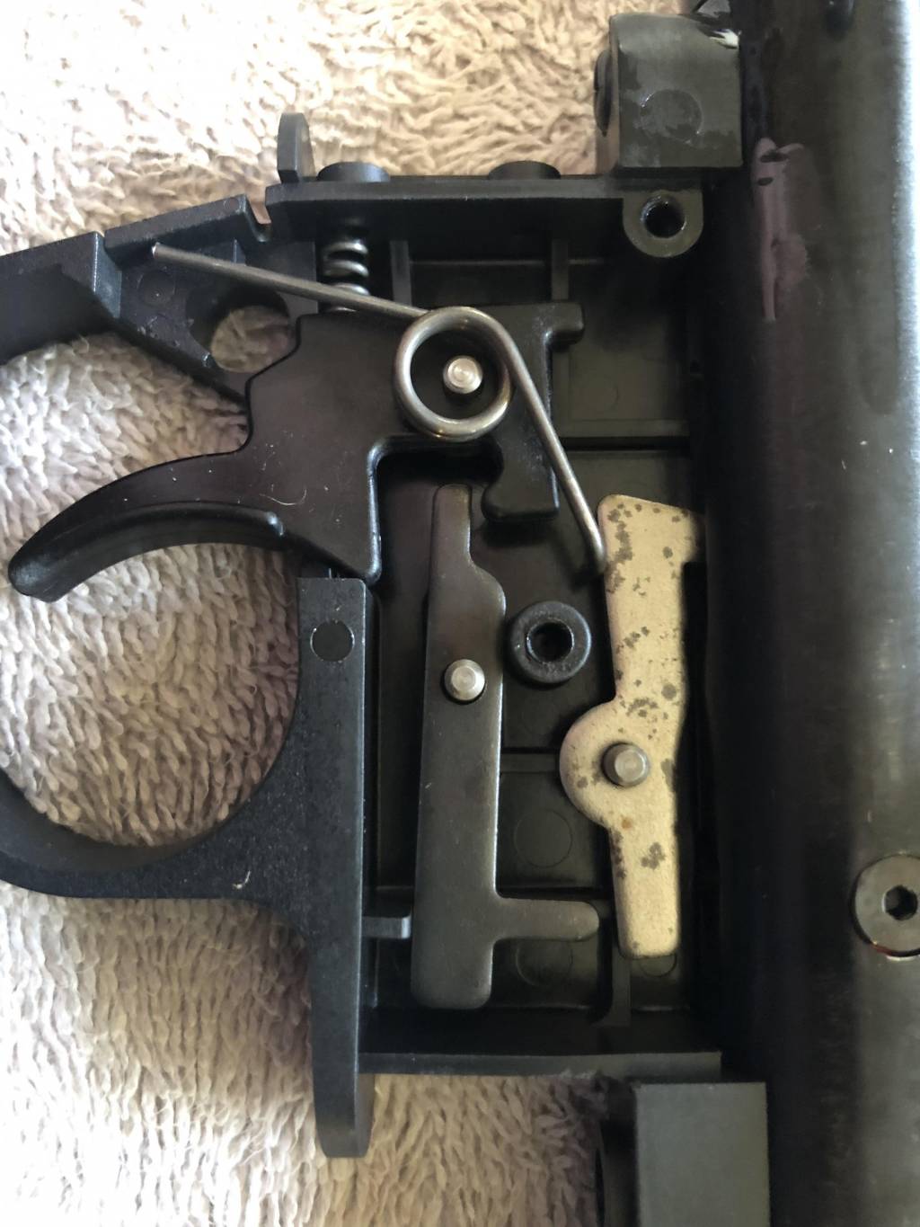

 This is what it looks like in there. Very easy to work on. First you got to push the safety out To take the action out of the stock. I take a tiny jewelers screwdriver and push on that little spring behind the safety which will allow it to pop out.You can see the hole in this picture where the safety goes through with the spring behind it.
