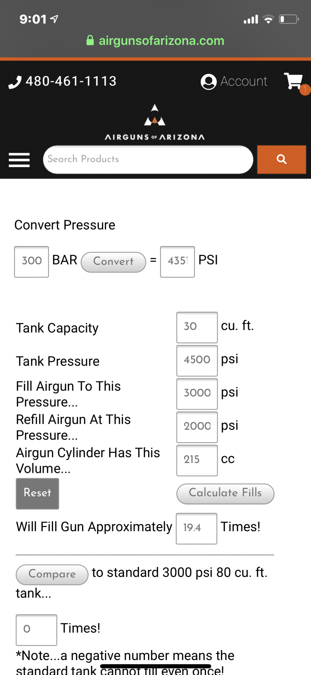

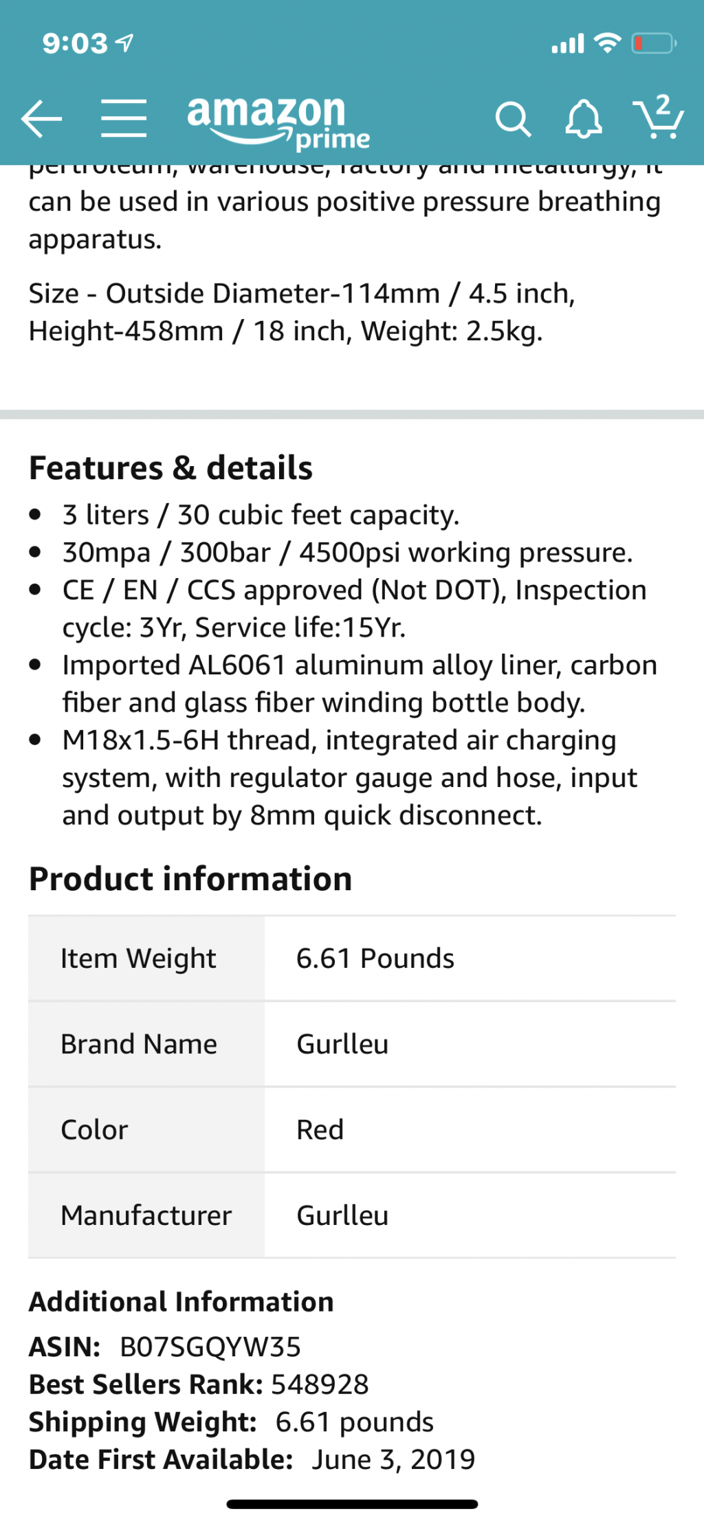

Does this look about right ? This is a tank I’m looking at on amazo
1572743013_11042154815dbe27653d74a9.53939998_9ECE5C33-1751-4410-B083-5864AB385A04.png
