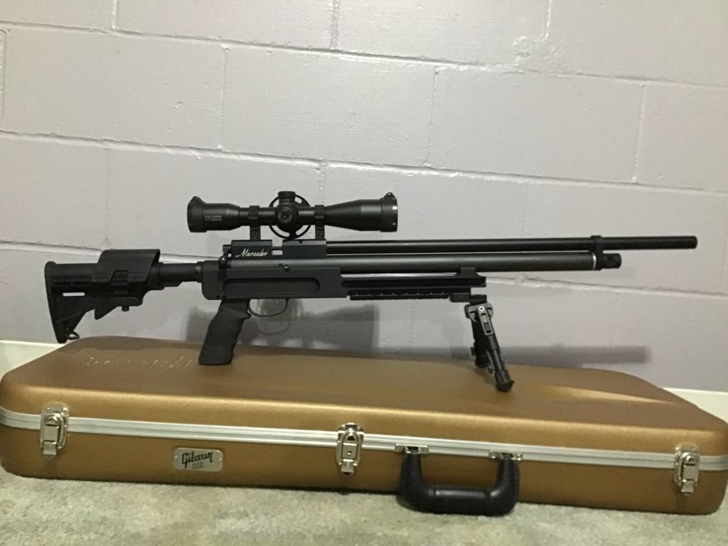

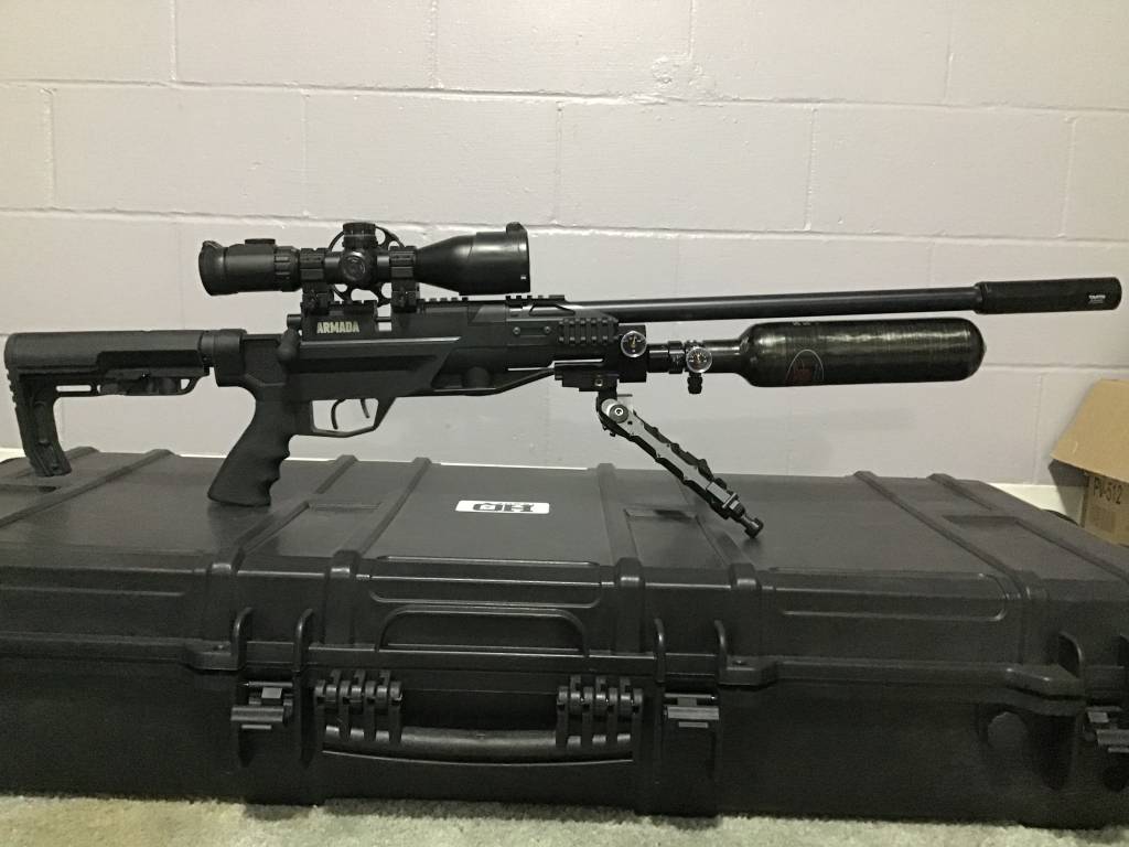

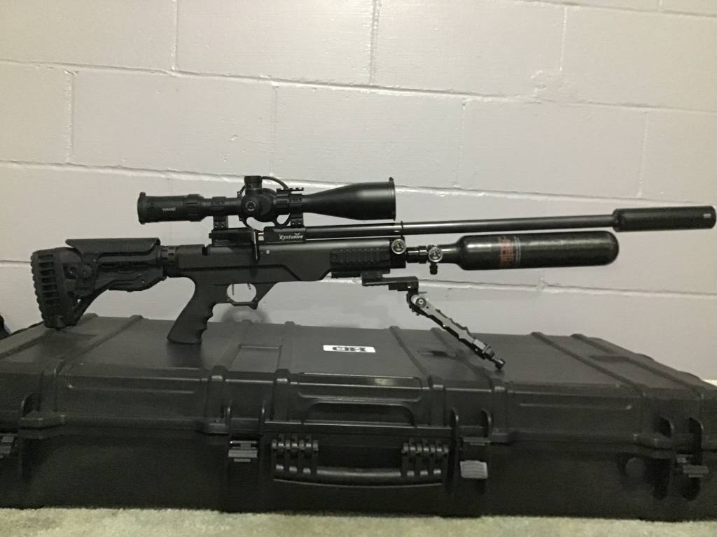

I like incorporating Eugene Stoner’s (father of the AR) concepts into my Mrods. Just got used to shooting that style of rifle and love the Mrod platform.
I dig your Gibson guitar case! The MRods look nice also.

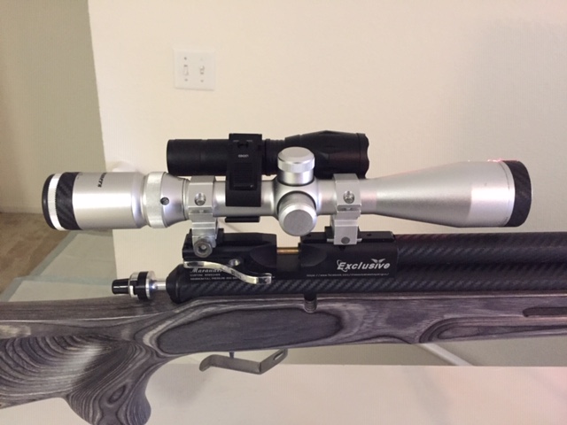

Just had to post this. Started out as s .25 armada.. now, side lever , war valve , mds hammer, speed dial, boyds stock.. I have hit 1.7 and 1.9 efficiency with 33 grain swagged slugs. 40 to 90 ft lbs, the most versatile and easy to maintain gun I own. I have 800$ in it including original cost. The marauder/armada platform is awesome.
That's a great looking gun!! Love the laminate!
